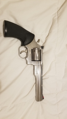

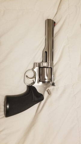

So I got me a cool 715 . Serial 00255X . Am I understanding right that this is a 1970 vintage? Has a really smooth and light trigger.  Didnt get any extras.
20191021_191939.jpgImage Enlarger
20191021_191925.jpgImage Enlarger
Forum Posts: 3718
283
October 22, 2019 - 2:11 pm
mblackm1 said
715 Serial 00255X . Am I understanding right that this is a 1970 vintage?
No, the model 715 was not produced until 1982 I believe. Interesting serial number though, I have never seen one like "S / 00255x" before and the Registry does not have anything similar as a guide either.

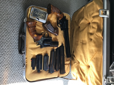

image-1.jpgImage Enlarger
Hey y’all, brand new member here. I just inherited 2 .357 pistol packs/cases from my grandfather. (Only one case one picture)  I am trying to figure out the production years. I believe both packs are model 15-2’s and were bought brand new. Monson made, adjustable sights. Serial# 127xxx and 120xxx. Packs both fully equipped. Any more info on the years , models, etc would be much appreciated..and I agree, the blueing is absolutely beautiful!
Forum Posts: 659
October 17, 2017
287
May 22, 2020 - 6:17 pm
Manufacture date on both pacs would be 1977, and are 15-2's. The 8" revolver is wearing an original Dan Wesson grip. The grip not mounted is for from a High Standard, but fits a DW. The other grip looks to be custom; perhaps another member could identify. No matter, it obviously fits.
You could put the High Standard grip up on eBay and get a good price from a HS collector. Just a thought, but it will work just fine on your DW.

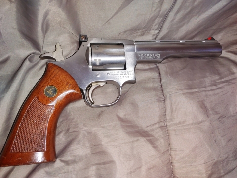

I just acquired this one a week ago. Looking through the registry, it seems to be a model 715 of approximately 1986 vintage from Monson Mass, am i correct?
It's in great shape, and as soon as I get my tooling from EWK, I will break it down and go through it.
Any suggestions as to a good leather holster for it?20221128_163805-1.jpgImage Enlarger
20221128_163900-1.jpgImage Enlarger
20221128_164012_HDR-1.jpgImage Enlarger
20221128_163745-1.jpgImage Enlarger
20221128_163958_HDR.jpgImage Enlarger
Forum Posts: 4341
294
December 3, 2022 - 1:07 pm
Very sweet. Probably a couple of years older than 1986.

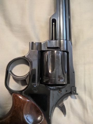

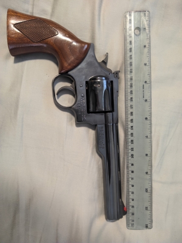

IMG_20230329_121907.jpgImage Enlarger
IMG_20230329_121918.jpgImage Enlarger
Trying to figure out what model I just bought. I think it's a 15-2? Don't know the age though.
A friend sold me this for $800, hoping I didn't get screwed. Seems to be about right based on some stuff I was finding. I probably should have created an account here and asked beforehand.
Any identifying help would be appreciated.
Thanks,
-j
299
March 29, 2023 - 3:40 pm
Welcome to the Forum.
Definitely a 15-2. Probably sold between 1973 and 1975.
I would say you bought near the top of the current market, which is going up fast. Looks in good condition on the right side. It would help to have a picture of the other side. Did you get a barrel tool or gap gauge with it? You will need those before shooting it. Did you check for function?
