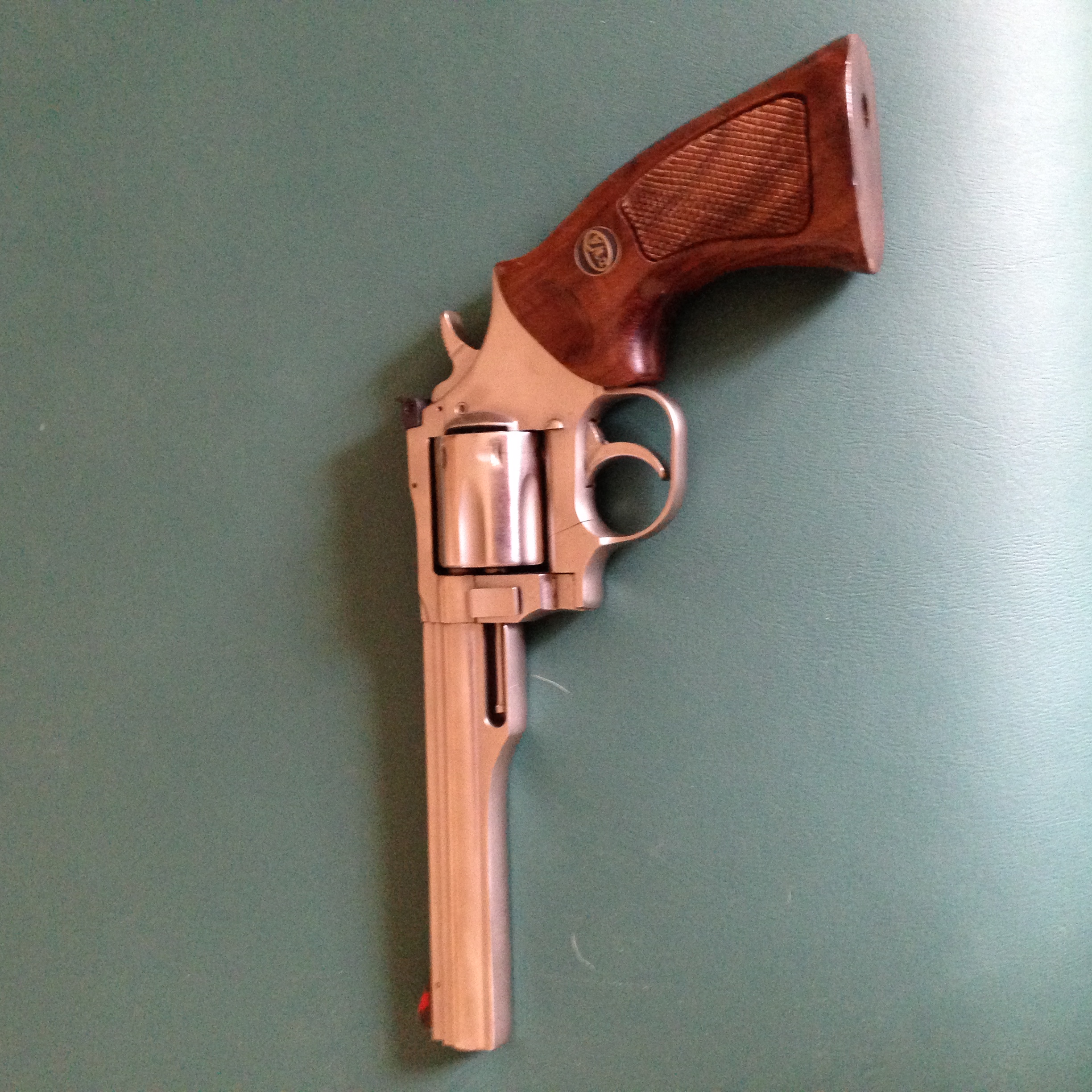

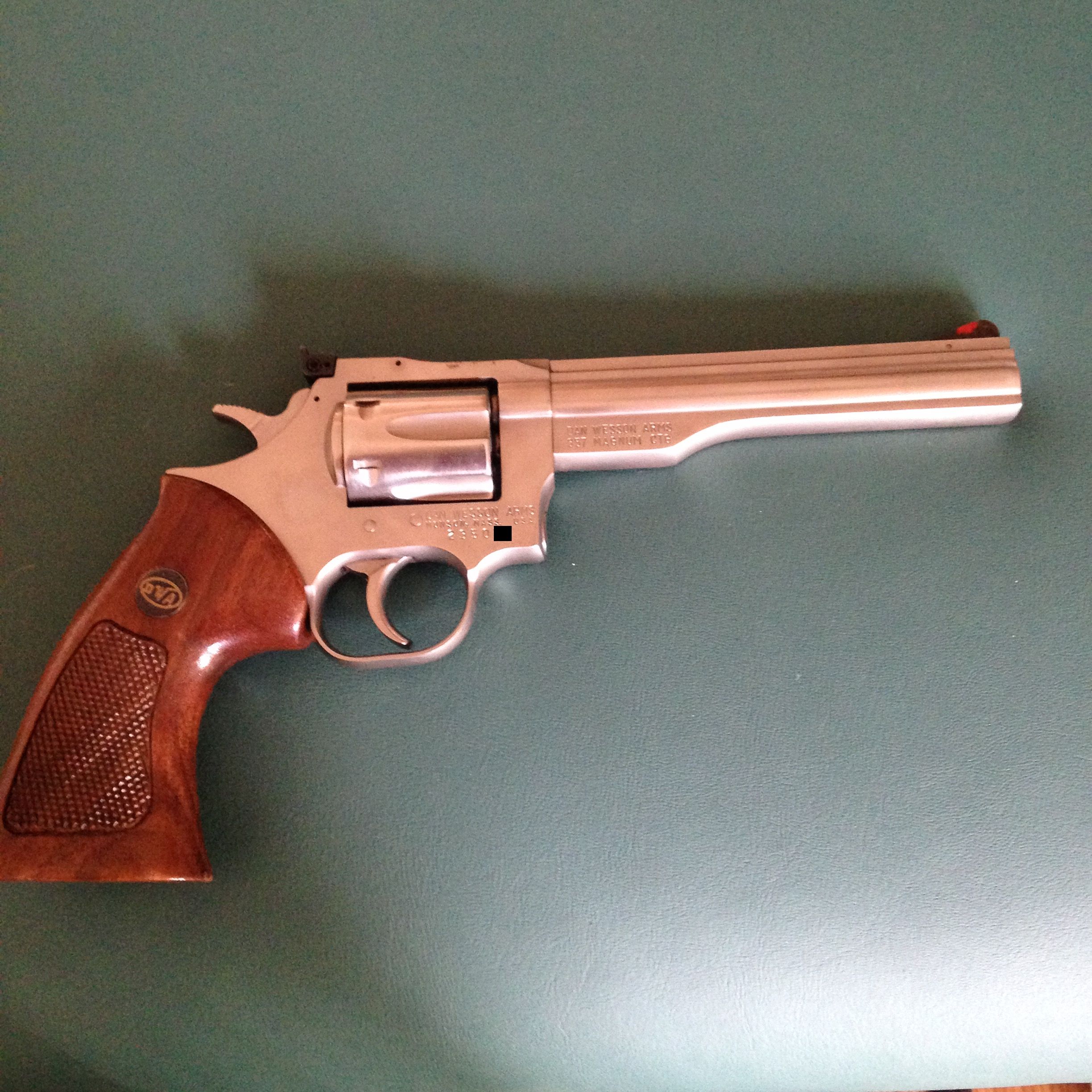

206
December 14, 2014 - 3:06 pm
Firstly, Thank you for the welcome and quick responses. It is Stainless and here are a couple of pictures.IMG_0033.JPGImage Enlarger
 IMG_0033-2.JPGImage Enlarger
 IMG_0032-1.JPGImage Enlarger

December 16, 2014 - 2:24 am
208
December 16, 2014 - 8:34 am
I'm not sure this is a 715 (stainless). There is no evidence in the Serial Number Registry of any 715 that does not lead with either "SDO" or "357S". That serial number is clearly a 15-2, and I don't see a frame mounted overtravel screw, it sort of looks like there is an overtravel screw in the trigger. There appears to be a bit of corrosion on the frame above the cylinder.
Good chance this is a 15-2 that has had a refinish, possibly something like Armolloy.
Forum Posts: 11289
209
December 16, 2014 - 11:50 pm
You are right Steve, I didn't enlarge the pics before my previous comment!embarassed
Forum Posts: 4341
210
December 17, 2014 - 12:39 am
I to thought I had a rare stainless gun , a 714 , that predated all known stainless guns. Alas, it is hard chrome. Absolutely beautiful though. A joy to clean. And virtually impervious to wear. You should be very proud of your gun. It is a beauty. Nice grip too!
    The one drawback is matching other shrouds. I guess you will need another or two.
