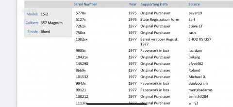

Others know more than me, but it looks like a 15-2VH6 with Hogue grip. Very nice condition!!
Based upon the DW Registry, it looks like yours is from 1975 - 1978.  Again, others will know more than me.

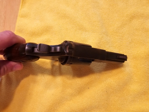

My brother in law inherited this revolver from his dad. I have DW 1911s, he knew I liked Dan Wesson, so he showed it to me. I know very little about revolvers. I know it was made in Monson, six digit serial number, blued, service fixed site, 2" barrel. This is a 14, service, non-pork chop, correct?
My question what barrels will fit this gun?
For example, the CZ-USA webstore lists a 6" B/A SS 357 Magnum barrel "uses new shroud" for $304. Given this gun was made in Monson, I take it, this is the old shroud. Even if it looked goofy with a SS barrel and wrong shroud, would the new shroud fit? Or is this restricted to model 14, old style shroud barrels? Or just a fixed barrel?
If possible, I might conspire with my nephews to get him a repro DW kit case, and an additional barrel, 4" or 6", if I can find any for less than the cost of the gun. Any help is appreciated.

You have a Model 14-2. The CZ barrels are the same but the shrouds are not only slightly different, they are for adjustable sight guns and will not shoot to point of aim without changing the front sight. Shop eBay for any appropriate barrel assemblies. You need the ones for the model 14-2. Nix faux DW cases. Look for the authentic cases. Unless you want to get all four lengths I suggest a DW soft case that holds an extra BA and is more available. Be patient when searching.
