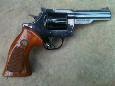

ciao, vorrei conoscere con sicurezza il modello in mio possesso, magari anche l'anno di costruzione e dove trovare copia del libretto di uso e manutenzioneproud-to-be-an-americanmad

Questo sembra essere un 14-2. Il numero di serie avrebbe aiutato con la data. Probabilmente è 1979-1980. Ecco un link al manuale di istruzioni: https://www.danwessonforum.com/wp-content/uploads/small-frame-manual.pdf tranne che è scritto in inglese.

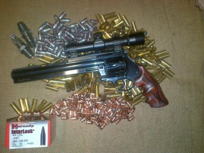

I am busy looking at a DW 8" 44 mag and I just want to see if you guys can help me out abit on the gun. These are the pic I got from the guy! Can you guys maybe help with model and value of the gun by looking at the pic?
The guys want R10500 which is about $1190. That is the price a collector here in South Africa told him he could get. Is it a good price seems a little steap

Howdy, What you have is a model 44VH8C (compensated) with a Hogue grip and what appears to be a Simmons's scope. Keeping in mind that price is very subjective to condition and region, I would value the gun at $600.00 to $800.00 US dollars. Others who are more in tune to the market will be along to correct me if I missed the mark. Now that was an estimate here in the southeast USA. I have no clue how that will translate to South Africa.

That price would be pretty steep in the US except to a collector. It is an unusual and less common model of a less common brand, especially outside the US.
Frankly, depending on your expected use, any 8" .44 Magnum could be just as serviceable, unless you really must have a Dan Wesson. There would be a premium placed on this gun, simply because it is much less common than a Smith&Wesson or Ruger .44 magnum.

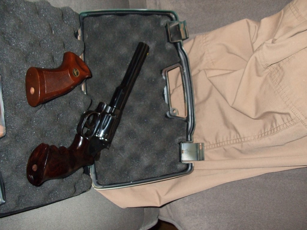

What exactly do I have?
Purchased used, only came with second grip (has DW and ergonomic), both are wooden.
I am guessing a 357 Mag CTG 15-2 w/ Target Barrel?
Barrel is around 6 inches (quick measurement from outside) Monson, Mass. USA Serial number starts with 17 and is 6 digits.
Bluing is about 90%, is in excellent cond. spacing is good (minimal in-between), mechanism is good, --slightly used, Noting else came with it, paid a little under $600.
View pics for what they are worth

That is a Dan Wesson 15-2 6V (6" Vent Rib, the .357 CTG just describes the caliber chambered)  of 1978-79 vintage. You have the original grip, and what looks to be a Hogue grip installed on the gun. The yellow front sight is possibly/probably not original to the gun, the factory original was most commonly the red insert.

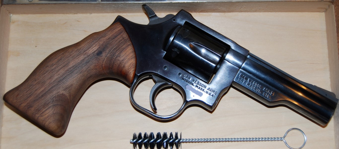

just curious about the manufacture date of this Monson made 357556781_623036771060324_706777697_n.jpg

wasn't to far off, the feller i traded it from said it was a 1976, it is still in great shape wtih almost no holster wear at all is is a 15-2? and what designation would it be? 15-2 4vr?
