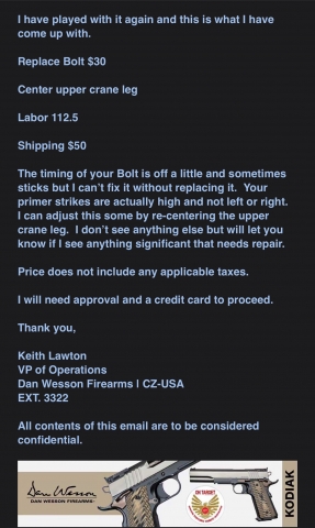

86
July 22, 2022 - 3:42 pm
I just heard back from DW.5F63A83F-4561-4D68-9F24-10179B85C343.jpegImage Enlarger
Forum Posts: 669
October 17, 2017
87
July 22, 2022 - 11:48 pm
This is very interesting! Never thought of an out of alignment upper crane leg. Let us know how it shoots when you get it back!

95
August 6, 2022 - 5:11 pm
I finally made it back to range yesterday after receiving my 15-2 back from DW. They fixed everything and cleaned. Let’s just say I couldn’t be happier with the revolver.
They re-centered the leg to fix the off center primer strike. Replaced the bolt to correct the timing and lockup.

96

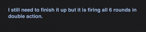

August 6, 2022 - 5:33 pm
Awesome news, Jay!! We’ve had some unusual cases in the past, but this issue has never come up before that I know of. So glad Kieth was able to make the repairs, and that you are finally able to fully enjoy your DW!

97
August 6, 2022 - 6:54 pm
