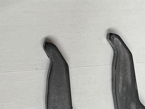

Not sure, but more concerned about the gap between the frame and side plate. Check for burrs on both surfaces and file if necessary. You’ve said that the gun is clean, but check the tiny corners for caked on debris. If you do find something and get a tighter fit, the hand may start to bind, but hopefully not. Does the timing seem correct now? If so, maybe you don’t need to do anything more to it.
After posting the picture I noticed the gap, I’ll take a second look.
Timing is still off.

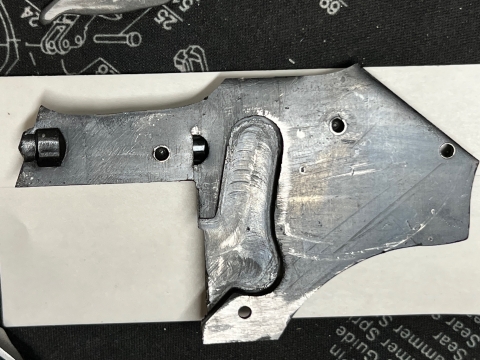

Can you send us a photo of the inner side of the side plate? There has to be something we’re missing here; we’ll eventually figure it out. Hang in there, Jay.
5ACD8087-94BF-4B89-81D5-47F931D13354.jpegImage Enlarger
BE14EDB0-342D-483A-B6F9-DDF62072D96E.jpegImage Enlarger
E734A3C5-E74C-4D76-A971-8D3FEE9D18C3.jpegImage Enlarger

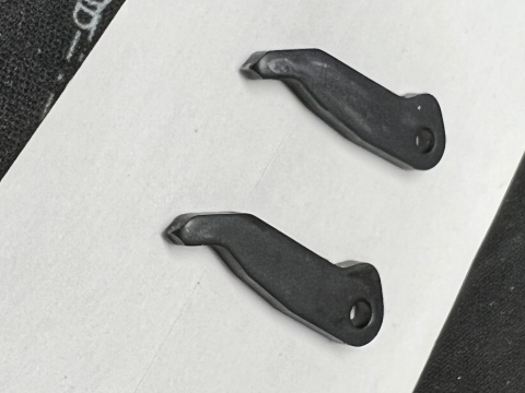

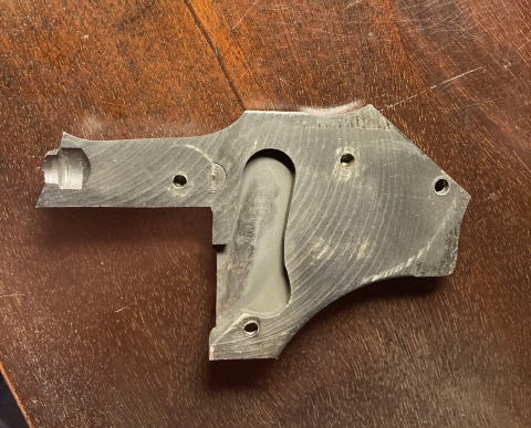

Once again, the photos don't seem to reveal much. I'm assuming the hand on the right is the new one? I've attached a photo of my 15-2 side plate. Not sure of what you may have for measuring purposes, but the depth of the hand recess in the side plate is .124 on mine. This should be fairly consistent for all small frame DW's. I do notice some machining marks in this area of your side plate, so it's possible someone tried to deepen this at some point in this revolver's history, which would be the WRONG thing to do, but only a careful measurement would reveal if this has been done. I doubt it actually, as it would require the use of an end mill which most of us do not have access to. The other possibility that I'm considering is that your side plate could be "bowed"; that is not flat when laid on a flat surface (like a granite counter top for example). If you find that it is indeed bowed I'm not sure how to advise you on how to straighten it. Hopefully another member can offer a "how to" if that ends up being the case. This is definitely a puzzling case for sure.IMG_0991.jpgImage Enlarger
  I’ll take another picture that’s not so over exposed and also measure the side plate. I also have a machined steel plate to check for true.

The wear on your side plate shows the handspring has been misplaced for a long time, based on the wear marks along the recessed cut.  As I stated in post 30/33/34; reassemble, ensuring everything is put in its place and try it again.  If you're certain that isn't it, take a picture of the star ejector so we can see the wear marks on it. The old hand doesn't look worn out and I doubt the ejector is but you never know...

I don't recall any of my guns having the striated milling marks on the inside of the sideplate. I wonder if they were done aftermarket. Very light polishing of those striations may help the action. Does the sideplate fit well on the outside? Is it flush with the frame? And please, please give that dry gun a drink of gun oil.

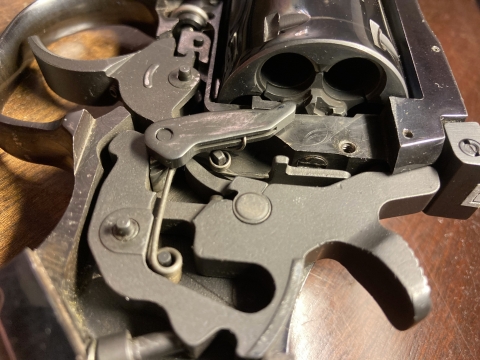

Just to be absolutely certain on proper assembly: this is what you should be looking at before adding the side plate. IMG_0997.JPGImage Enlarger
