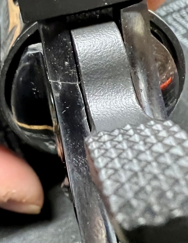

Some clear photos of the sideplate ON, showing all the seams and if it is flush with the frame would be important. Especially where it meets the bottom strap and top of the trigger guard. We will figure this out!!! Maybe send it to that master DanSmith Snake-eye. 😉
This is the only one I have at the time E437E05A-5C5B-4839-9217-4D2FE1B3BD63.jpegImage Enlarger

June 27, 2022 - 8:57 pm

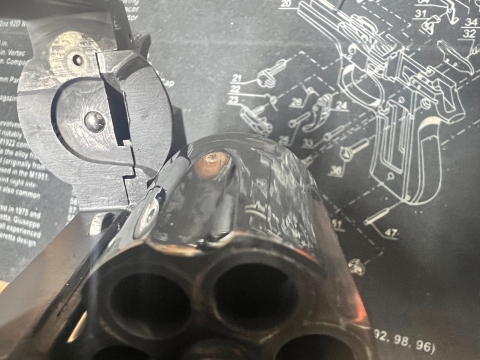

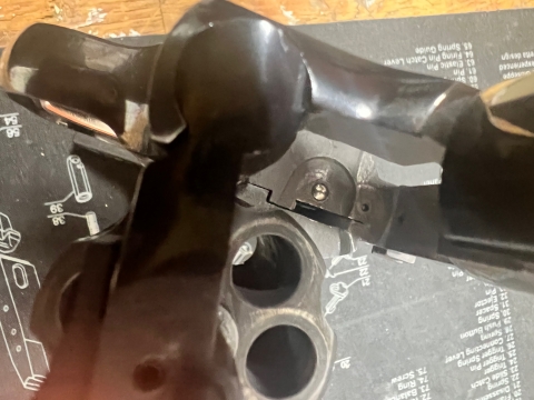

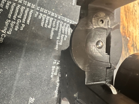

Doesn’t look bad from that angle; can you take a couple with the cylinder swung out like you did before, as clear and close as possible?

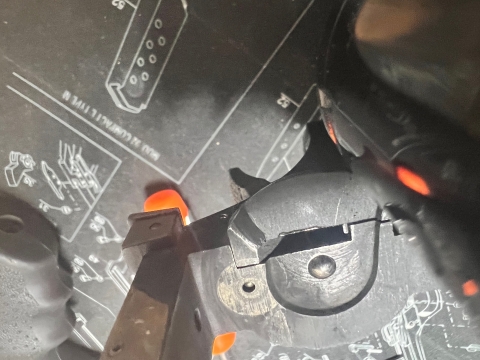

02B87105-1ABD-4496-9440-5E5575FD72B6.jpegImage Enlarger
1880D2F4-5DB2-4085-9F3D-CF8759A85B83.jpegImage Enlarger
AC1EA4B3-2E95-4A83-ACA2-5D1A49FA8B8C.jpegImage Enlarger
24983E81-4520-4370-8F9E-10537D3DB998.jpegImage Enlarger

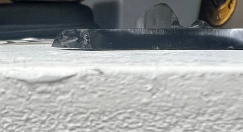

not sure if I captured the slight bend in the side plate.C047338C-4073-447C-AD01-7ABFBA42D22B.jpegImage Enlarger

Not sure if the photo in post 73 shows it clearly, but it’s likely from the photos in post 71 that the side plate is bent, or damaged in some other way. It’s impossible for us to tell from a photo; you’ll have to judge that for yourself. You’ve stated before that the side plate screws are tight, yet a noticeable gap is present. Ole Dog has warned that these side plates are delicate, so I’m leery about how to advise you on how to straighten it. If I was in this situation I would scour eBay until I found a replacement side plate. The one you have is either not original (likely), or damaged/modified, and while another side plate may not fit perfectly without a little fitting, I think it would be more effective than trying to get this one to fit properly. Not what you want to hear no doubt, but that’s my best advice. You can attempt to straighten this one first (you have nothing to lose), and you might be successful if it doesn’t crack in the process.  Try not to be discouraged with all of this. I can guarantee you that neither the side plate, cylinder or hand are “original” on my 15-2!

Jay, looking back through all of the photos I may have noticed something. Since you’re taking the gun completely apart anyway, take a moment to see if the side plate will sit flush with all other parts removed. The spindle (not the right term) that the trigger goes on looks to be a bit mushroomed as does the corresponding hole in side plate. That could be what is keeping the side plate from seating correctly. Worth a quick look before you send it off to DW.
