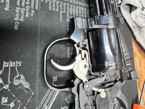

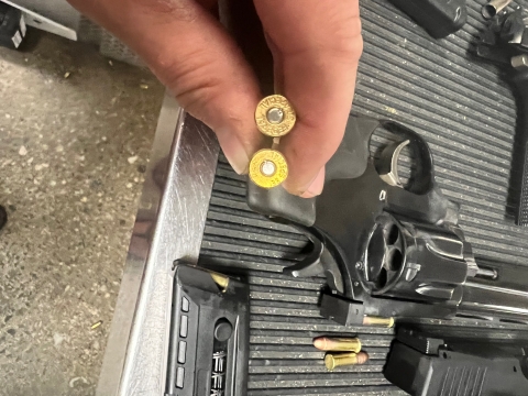

I think I have the problem you’re talking about38959D9F-A402-4424-B1E6-5E4E000325E3.jpegImage Enlarger
285ED015-AE1D-46AF-A07C-ECD077901B03.jpegImage Enlarger

June 14, 2022 - 1:12 pm
Yes, you certainly do. First thing to check is that the side plate is fully seated (flush), and that the screws are snug. If that checks ok, then pull the side plate and have a look at the hand to check for damage. This is very rare, but it can happen. Does the cylinder rotate freely, or does it bind?

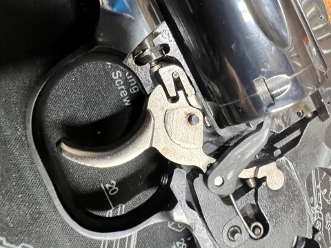

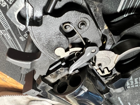

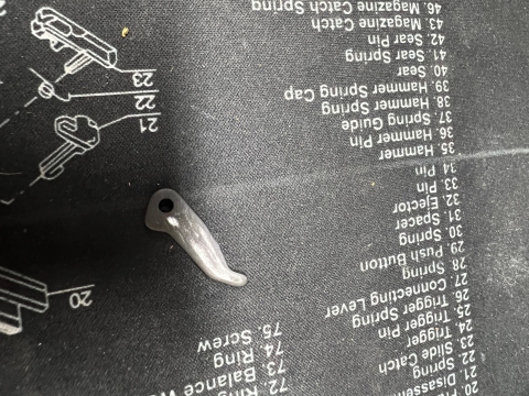

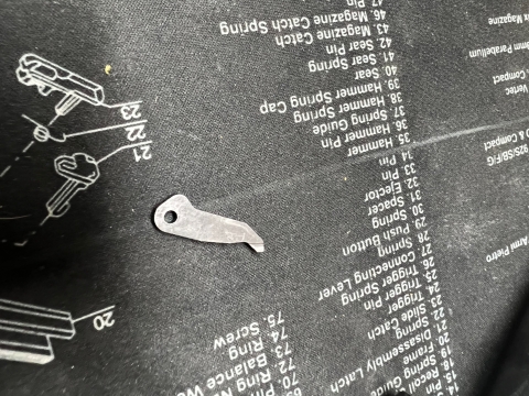

June 15, 2022 - 1:03 am

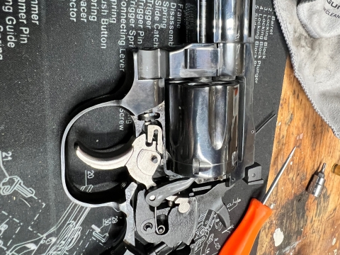

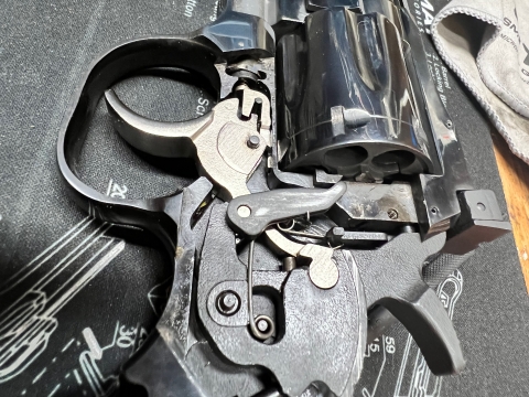

Once the side plate is removed you can easily remove the hand. It has a small wire spring holding it in the forward position, so simply slide it out of the way. One thing you have to understand about buying used DW’s is that they often have been adjusted by well meaning but uneducated owners who do not fully understand how these revolvers actually work. The hand is the heart of the DW. Proper fitting is imperative. Sometimes a replacement hand has been installed that was unintentionally ruined by a previous owner. Please give us some clear, focused images of the action with the side plate removed, and of the hand itself. Perhaps one of the experts here will notice something that is not correct.

June 15, 2022 - 7:45 am
26D21D1D-A96C-4753-80DC-891DF5707FE4.jpegImage Enlarger
CB3CA6FD-7839-442D-AADE-13E6883C72F6.jpegImage Enlarger
B38C6DDF-12C3-437C-BCA0-1292C260DB60.jpegImage Enlarger
6EA78541-6D60-4948-862E-0BE4DAFEF996.jpegImage Enlarger
B5EA6E16-A95B-40E3-9821-537E0F20804C.jpegImage Enlarger

June 15, 2022 - 7:47 am
120A5692-A0C3-4E1C-896A-A77221E4F8C4.jpegImage Enlarger
096A05D5-035F-429A-8B83-44180A5D5BEA.jpegImage Enlarger
