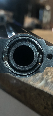

I have read every thread on DWF related to stuck barrel nuts.  And even some threads on other sites to get as much knowledge as possible for this repair.  I want to fix it without damage, if possible.  What makes this an even more challenging situation is someone prior to me has already boogered up the notches in the barrel nut. They are ramped.

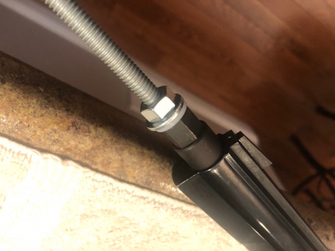

First, I soaked the barrel nut for days with Ballistol.  Then, I heat cycled the barrel nut several times to help break it free before trying to use the wrench. After several heat cycles using my hot air gun, I then used a 5/16” all-thread rod (protectively wrapped with blue tape so as not damage the barrel) to clamp the tool down to the barrel nut. I went slowly, iteratively adjusting how hard to clamp the wrench against the barrel nut. I used nylon washers against the barrel bore and between the barrel tool and metal washers over the nylon. Each iteration, I only applied enough force to judge how the tool was performing. If it looked like the barrel tool was separating from the nut even the slightest, I tightened clamp force a little more.

After several attempts I had the tool clamped really tight…to the point the nylon washers were beginning to distort slightly. Even with this amount of clamp force, the barrel nut didn’t loosen and now the 2 nubs on the wrench are deformed.  The ramps on the barrel nut no doubt caused the damage.

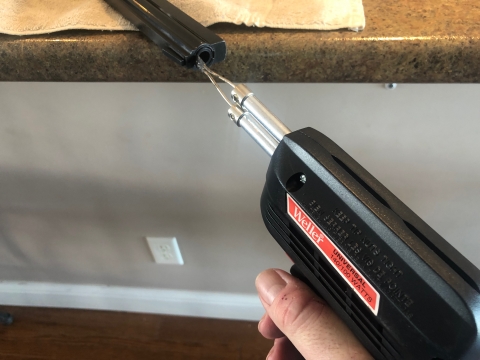

What about a soldering iron with a fine tip to just heat up the barrel and nut?

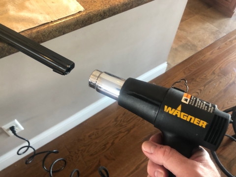

A162D6A2-F3CE-4AE5-A22C-12DA793330EE.jpegImage Enlarger
Thank you all for the input!  Before the heat gun I tried 2 different soldering irons. Neither put any heat into the nut.  Not sure why, but that’s why I switch to the heat gun.
500 degrees?  I don’t think I got the muzzle to 500 degrees, maybe 250-300 tops.  I was being conservative.  I got it hot enough to see the oil bubble/boil around the nut.  When I saw that I thought I was hot enough.

The soldering iron has always worked for me but you need to use a hi power one with a solid tip. They are usually sold with 3 different shaped tips that screw in. Use the rectangular tip as a basis and file it to match the slot in the barrel nut. I got mine at harbor freight I believe. This method puts almost all the heat on the nut, not the shroud and barrel. Use padded jaws on your vice...again bought at harbor freight and place the barrel in a vertical position. Apply Kroil and then go back and forth with the hot soldering iron from one slot to the other. When the Kroil smokes, add some more. Do this for about 15 minutes. Then with gloves on, use a good barrel wrench and put all your weight into it . Turn the wrench hard as you can .  You may need the punch/hammer technique others have described since the nut is buggered up. You may need to elongate the nubs on the wrench by filing away some of the round base. This will insure as much "bite" as possible

worshipThanks for all the great advice!  My soldering gun has multiple attachments and I used the one that fit the ramped notches in the nut best.  Never thought to file the end!    I wonder if my gun isn’t working as it should.  It was definitely hot, but no heat went into the nut. I could touch the nut within seconds after removing the gun.  I had it on there for at least a minute.  I’d thought by that time it should at least be getting really warm.
