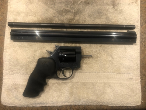

She’s back. Bob did a great job salvaging the shroud, looks exactly the same as before, no new marks anywhere.  I also had him do a spring kit installation too, action and trigger feel great.
You can see the bore is cut/ground down and the muzzle end has the ez-out marks inside the barrel.
No way I’d have been able to get this thing apart myself.  Bob’s comments on the return paperwork said “Had a squib ring in barrel- looks closer to 3 rings at 1”, 2” and 4”.”
Only charged me $175 total ($75 labor, $50 parts [spring kit & new barrel nut], $50 shipping).

September 28, 2008
75
March 31, 2023 - 3:41 am
I've only had two stuck nuts, both had red Loctite on them. On the first one, the nut was fine, and after a little torch action, it came off without much drama. The second was recently, and it was a real hassle. The nut was all chewed up from the previous owner's failed attempts to get it off. I broke the roll pin that sticks out of the frame of the gun, which allowed me to get the barrel out of the shroud. I have a ton of roll pins, so who cares? After a friend and I wrapped it up with tape and clamped it, we tried to get the nut loose. Nope. The heat gun I bought came out and after we saw the Loctite bubbling, we thought it would come off easily. Nope again. Looking closely, it appeared the nut was cross threaded. Oh boy. We finally decided to use the punch method and started punching away, and it just refused to move. And we chewed the nut up even more. I saw his welder sitting there and said, "You got any old junk sockets?". He had a big box of them and one 12 point metric just fit on the barrel nut. He welded it on and we put the ratchet on it, and it broke loose. The new nut went on OK, and I ran it up and down the barrel tube. The nut didn't tear the threads up on the muzzle too badly and I have a full underlugged 4" barrel assembly that looks rough, but shoots fine. I get so angry when I see a Loctited nut, there's no reason to do it!
