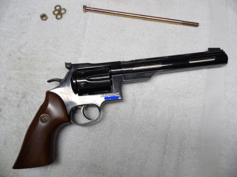

First let me thank the sticky (FAQ) on barrel removal. It aided me greatly in removing mine. I recently acquired an 8" version and promptly stripped the barrel nut. The gun had not been fired in over 10 years. I read the barrel removal closely and tried to make it a better mousetrap. I'm an aerospace engineer and not fond of vise grips on all thread so this is what I did.
Mcmaster Carr parts: One 9" long 5/16-18 steel bolt #91257A122, bag of small diameter flat washers #95229A460, and one bag of small hex nuts #94191A200. Total cost $21.72.
I figured using a hex nut in the cylinder area would allow me to add torque during the loosening attempt. Not a lot of wrench clearance. No go. To tight. Then I added another nut (jam) and tightened everything as much as I could using a soft jaw vise. Next I heated the frame with a heat gun until I saw some bubbling around the threads in the cylinder area. Using all my hand strength, no go. So I said a few choice words and brought out the 3/8 butterfly impact wrench to put on the hex head on the end of the barrel. Just hit it a little bit and boom that bad boy came right off. After pulling the barrel from the shroud do you know that barrel nut came right off by hand? Go figure.
Anyway my first post here and I thought I would pay it forward for the initial help I found here.
Thank you,
Mike

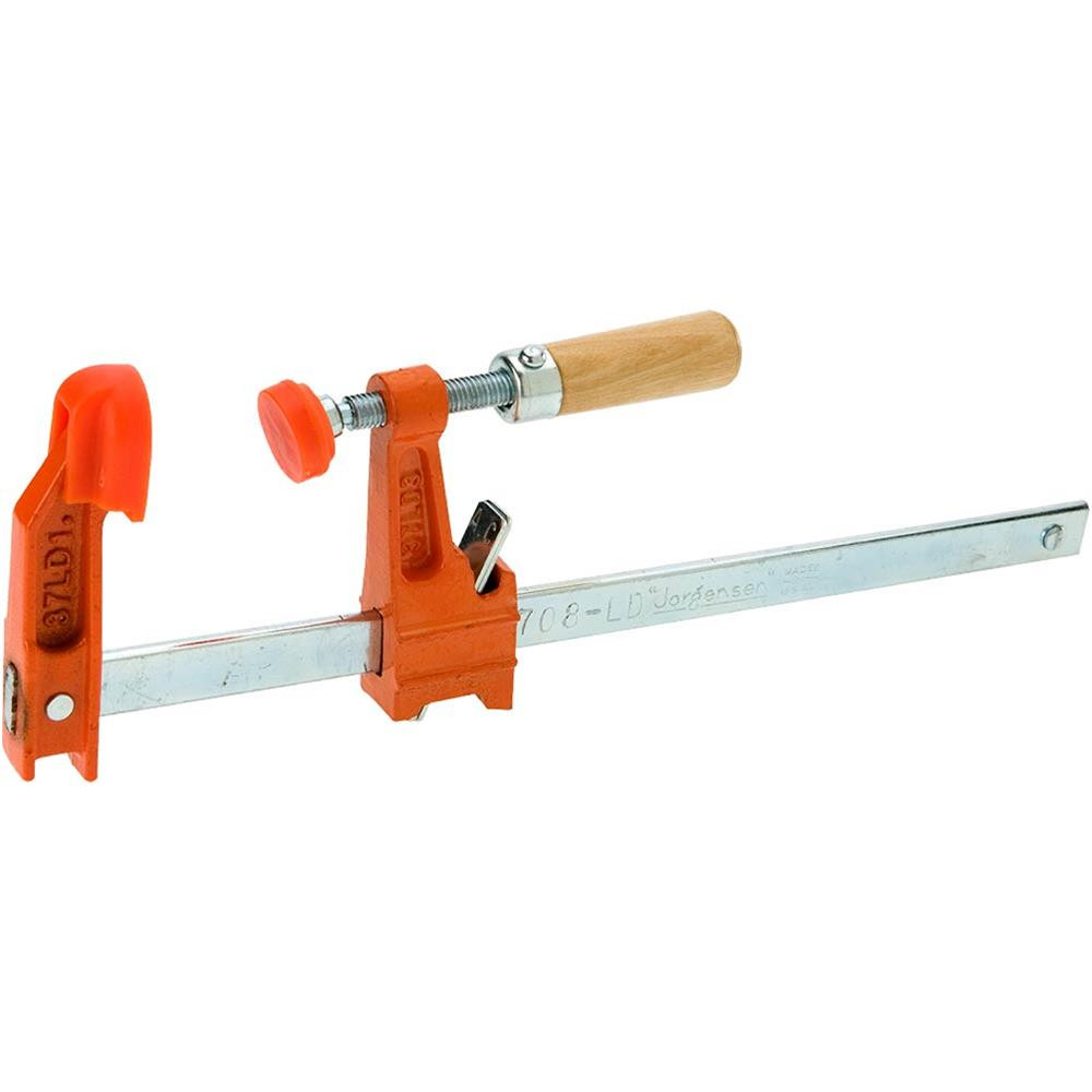

The clamp method has always worked for me every time, without fail.  Clamp down your barrel wrench nice and snug so it can't slip out of the nut grooves and give it a twist.  I also put a quarter between the clamp and forcing cone to give the clamp a good seat.  Prep the nut with oil and some heat from a hair dryer also helps.  I haven't come across a nut yet that hasn't given in to the clamping method.  Jorgensen clamps work well for the job.
