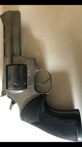

Had a friend give me a DW .357.   It hasn't been shot in a long time.  It was covered with light rust inside and out, cylinder wouldn't spin at all, among other issues. I figured I was stuck with a paperweight.  My 17 year-old son took interest in the gun.  He cleaned it up a bit and really wants to get it operable. I don't know much about the gun at all.   Based on the research I've done here, I believe its a Model 15 4 inch barrel VH.
Problem is, when he took it apart, the part that inserts into the cylinder and is attached to the assembly that releases the cylinder was totally rusted inside the cylinder and he could not remove it the part from the cylinder (not the pin/spring) (part #26 on the diagram).   Being a 17 year-old kid, he tried to force it and it broke off inside the cylinder.  I was able to carefully drill it out but there's no question I need a new part (I don't think I ruined the cylinder but who knows).   I'm attaching a photo of the part to be replaced.  I can only find it online being sold with the cylinder for about $200.
My question, is it worth spending the money to fix the gun?   It would be pretty cool if he got it working.  I appreciate all comments.IMG_F7038C8F6037-1.jpegImage Enlarger

It would be worth it to fix for me!  So, did you remove all the blue?  That thing is going to rust before your eyes.
CZ should be able to send you the part you need (yoke?), but I'd pony up the $ and send the gun to them to fit the part (and check for other problems) AND reblue.  For me the most rust prone parts are the barrels. There's a recent thread on this site about them doing the blue work.

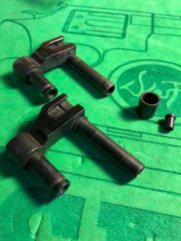

It looks like the crane is your broken part. I have these parts:
IMG_0244.jpgImage Enlarger
The crane at the top of the photo looks most like yours. It uses a pin to retain the latch. I also have most of the internal parts for the 15-2.
PM me if you are interested.

Thanks snake-eye.   I found the part online and and my son is cleaning it up.  As I said, the gun was in rough shape.  He has it all back together but the cylinder isn't turning on a dry fire and the hammer doesn't always cock.  Thoughts anyone?
April 10, 2020 - 1:42 pm
The hand isn't turning the cylinder. You may need to reconnect the hand spring or use a new one. Snake-eye has them. Probably best to replace all the springs. As far as the gun not clocking, it may be that the grip screw is screwed in too far. Will it cock without the grip on? If so, it is the grip screw. If it is not the grip screw it could be the trigger return spring is dislodged.
