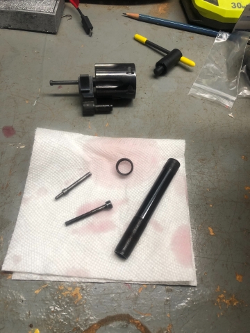

UPDATE:
As many 17-year olds do, they want things done quickly and not necessarily the the correct way.    When we started, he removed rust and tried to blue the gun without telling me he was moving ahead that fast.  After reading the tune-up thread, I intervened and told him to follow the thread.   He disassembled the gun and it's been soaking for about 3 days but it's pretty clear the soak came before a good bluing.   I just removed the parts from the soak and I'm thinking that we should start over and polish, remove the bluing and any remaining rust, re-blue, IMG_5230.jpgImage Enlarger
IMG_5228.jpgImage Enlarger
IMG_5227.jpgImage Enlarger
resoak and assemble.   Thoughts?
Also, I assume he can reblue all parts in the white bin. I'm not sure about the parts sitting on the paper towel.  There was corrosion on the barrel nut that required light sanding.   Advice?

I would blue everything. One thing I don't know is whether you should plug the ends of the barrel to keep the bluing away from the inside of the barrel.
Someone else here will know the answer.

I think the main spring guide is stainless- if so, it won't take to bluing.  Plug the barrel- wax should work on cold blue- not certain that you NEED to though.

Polishing before bluing is extremely important. I would remove the front and rear sights and reblue separately. They are easy to put back. Don't let the rear sight springs get away from you. Also remove the dedent ball and firing pin. No halfway measures. You might consider hot blue.
