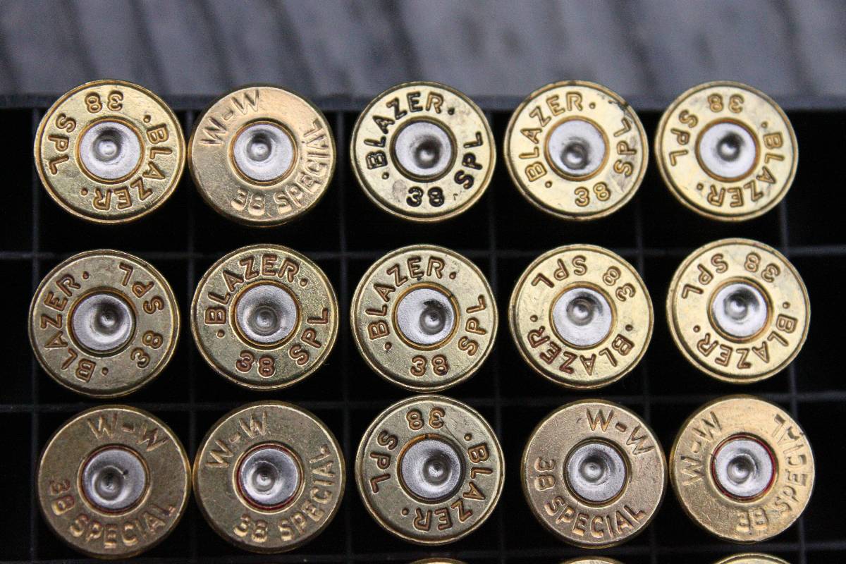

I have a 15-2 where the firing pin hits the primer seriously off center , any thoughts as to the cause ?

Well, since the firing pin location is machined and drilled into the frame, I'd guess that the cylinder alignment is the cause.

If it is to the left or right it could be timing. High or low might be a bent crane. Are you having FUN or spitting of powder or projectile?

I shot it yesterday and didn't note the primer strike indexing at the range, so I'll have to wait and check them at my next range visit.  I'll do some photos of the primers and the firing pin in the pistol . The offset strikes prolly contribute to the weak *ss FTF's that i get double action .  Trying to find a new DW hammer spring to replace the original and have adjusted the spring nut all the way in to get primers to light .  I'll get 2 FTF in every 5 .....  I think the offset strikes may well contribute for the failures . I get better ignition with Federal 100's but still get failures . This pistol has to be fully functional for DA shooting or it's a different revolver coming up ..  On the other hand my 357 Super Mag has no issues
August 5, 2016 - 11:46 am
If you have already checked the grip screw and it's not a problem, then check the front to back movement of the cylinder in lockup. There should not be much if any play. If there is, then you may need shims that will be placed in front of the cylinder. Also check to see that the screw holding the detent ball spring is not loose. This can also cause cylinder play. If cylinder play is present and you fix that, it should cure the FTF issue.
The firing pin off center may not be a problem if the cylinder is tight. However, if the point of impact is seriously off, then you have a timing issue and may need a new hand, or modification of your existing hand. Check each chamber of the cylinder in lockup to see if they are lined up on the barrel. If not then you do have a timing problem.
Firing pin strikes off center are not necessarily a problem. Many guns show slightly off center strikes even when functioning properly.
Your photos will help.
Good luck.

primers.jpgImage Enlarger
Photo of primers, will do pin photo later . Thanks for the check list ......

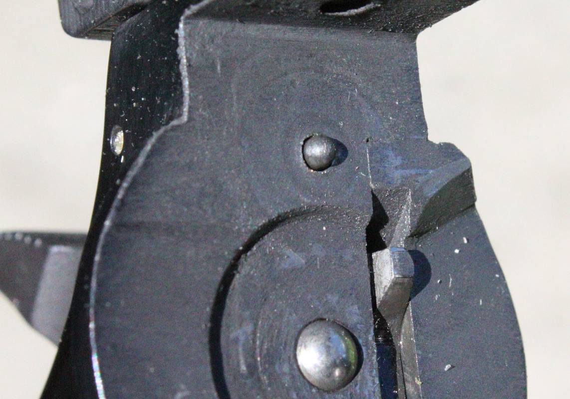

Firing pin with hammer down   ....  Ball is tight ,  With cylinder closed , I can barely fit a .009 feeler guage in between cylinder and cylinder rod/pin , so the cylinder has .009 movement in battery. I remember that someone had made a longer firing pin or had bought it from a source that I don't recall , any info on these firing pins? Maybe a longer pin may help with the primer ignition . My primer hits look deep enough but have to question the offset hits . I'm sure the primer design is to get center hits to ensure ignition, just a guess
pin.jpgImage Enlarger

Those hits look deep enough for good ignition but they are off center.  Looks to me like the timing is off a bit.  Give it a good Average Joe tune up and maybe a set of springs and see if it helps.  If not, it may need some work to the hand and a retiming.

From the pictures you provided, I also agree that your firing pin depth or protrusion appears to be adequate. I've seen guns with worse off center firing pin hits than yours (Taurus) that still functioned fine. While it's not something you really want to see, and it can indicate a timing problem, it's not absolutely horrible either.
Something else you could do is mark the top of your brass (with a permanent marker) to show orientation in the cylinder (position the cartridge with the mark on top then fire). That would show if the hits are off center left or right (timing issue) or up and down.

Do you have a wrench and have removed and adjusted the cylinder gap? Your firing pin extrusion looks more than adequate IMHO. As a matter of fact, I think the off center hits are not so off center. The gun looks like it hasn't had a lot of use by the appearance of the recoil shield. If you P M Snake-eye I am sure he will send you a hammerspring NOS.

I agree w/ole Dog, not that far off center. A good cleaning/tune up & spring, then see where you're at 1st.

What will be of more help is for you to shoot a pic of the pin strikes before you eject the empties.  That will tell where the problem is.
