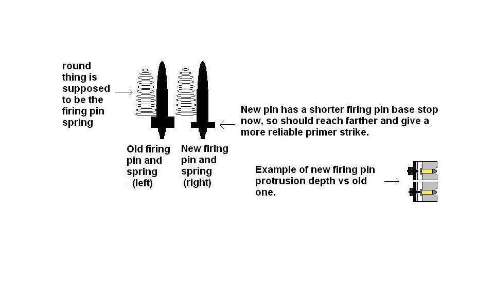

Like the original poster, I was concerned that I possibly did not have enough firing pin protrusion to get a deep enough, solid double action primer strike.
I purchased 2 replacement firing pins from Numrich. Then I removed the factory firing pin, cleaned the firing pin channel, and compared the stock pin with the replacement firing pins - they were very similar.
I wanted to rule out firing pin protrusion depth as my problem, so I turned down the firing pin stop washer portion of a replacement firing pin.
They say a picture is worth 1000 words, so here is a simple diagram of what I did.
firing-pin-modification.JPGImage Enlarger
I replaced the firing pin spring as well at this point, I figured I might as well rule that out as a problem.
Not having enough firing pin protrusion did not seem to be my problem, as I still occasionally got light strikes in double action with my "new and improved" firing pin installed.

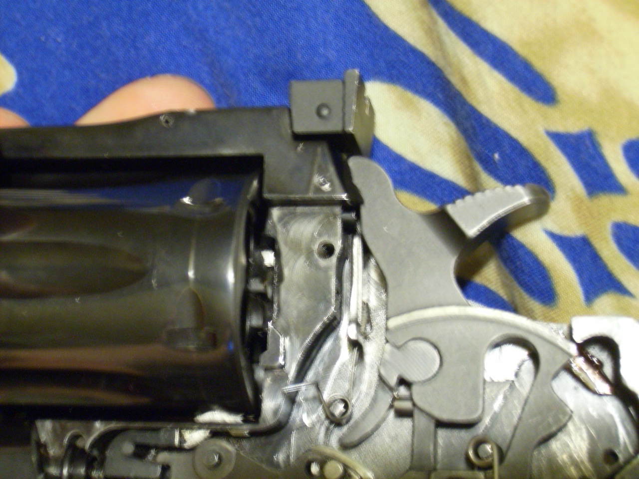

I have light strikes in DA there centered but about half the size of the single action. I am taking a break from replacing the springs. I recently got a 15-2. Got a set of the wolffs just like the average Joe tune up says to, but I think my problem is the hammer was rubbing/ hitting the frame. There is a little chip in the frame.chip.JPGImage Enlarger
I might have to get a shim but I hope that tightening the sideplate screws will center the hammer and get more reliable strikes in DA. Im gonna try and go to the range tomorrow.

I just measured the grip screw.  1 1/2" long and it takes 7 full turns to tighten.  Grips are Pachmeyer Grippers.  I took the grip off and put the grip screw in 7 turns.  1 3/16"  remain visible.  So it uses about 5/16" (slightly less) screwed in tight.  Otherwise the seat and everything look okay to me.  A little rusty but okay.  At the range I unscrewed it at least 2 turns and saw no difference in light strikes.

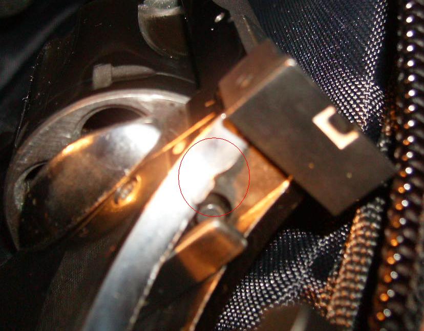

I also had a tiny little bur on the frame where the hammer might have hit the left side where Pornstar's picture shows.  Smaller than his though.  I polished it a little with a stone.  I can't tell if it was enough to slow the hammer at all, but it doesn't look like it.

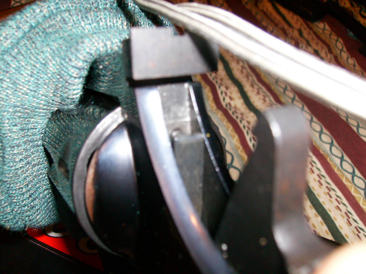

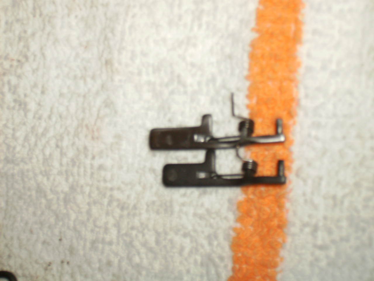

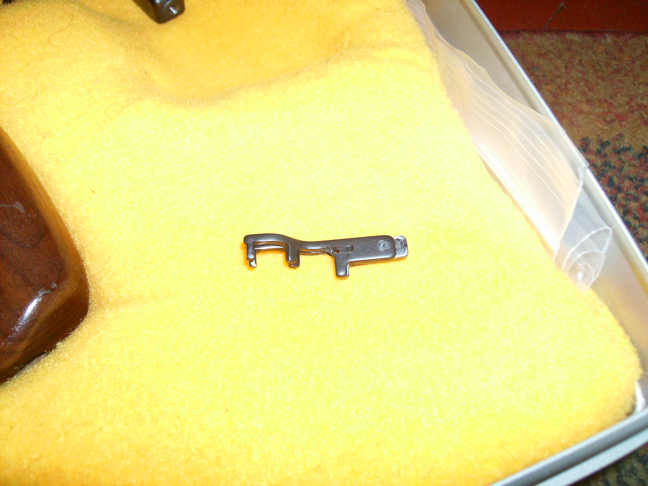

So I noticed that my connector is really long.  The hammer face strikes the connector instead of the frame and with the shorter pull of the DA I think its why im getting ftf. It is so high it can get caught under the hammer face when I pull the trigger to lightly.
inside.JPGImage Enlarger
Notice how in shootist pic below the connector is under the screw hole mine is above it. The bottom half lines up there is only the one hole in the trigger it goes into. Right? It seems like the section above the top of the hand spring is extended compared to everything else I have been looking at.
The square face of the hammer hits the connector not the frame. On my 44 its under the square face. On my new dan that's still at the shop (stupid waiting period) the hammer face hits the frame.SANY0719.JPGImage Enlarger
I will hold off on buying another connector until I get my new dan home. I will switch out connectors and see if it is the problem. I think this is why I have the chip because it is right where the impact happens. Now that I think about it when I put in the reduced power spring I was getting FTF in SA .

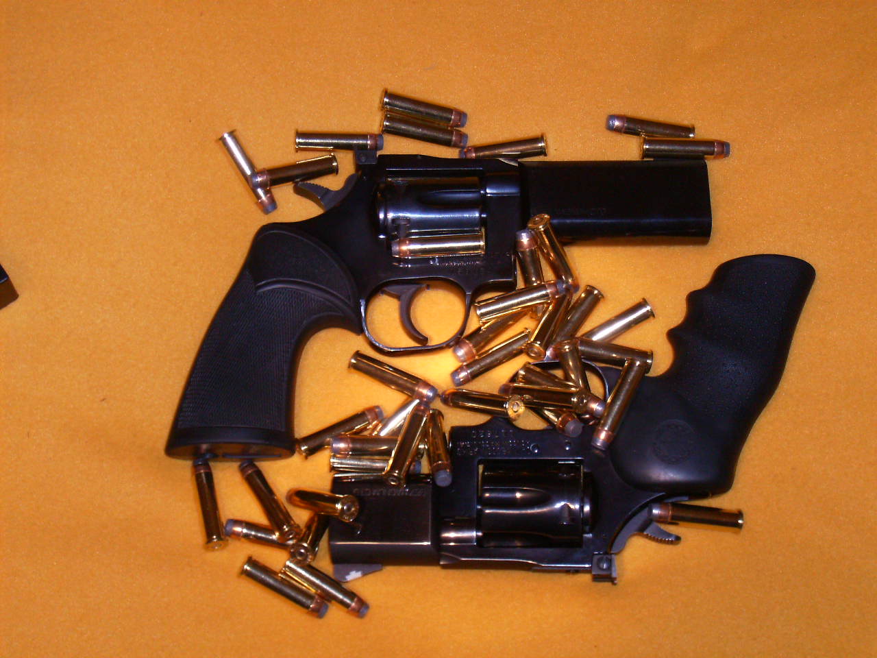

Got a used connector off ebay. That was the problem. I had my first enjoyable day at the range with my .357.  It was 40mm longer than it should have been.SANY0779.JPGImage Enlarger
SANY0785.JPGImage Enlarger
I had so much fun at the range I was all alone with 2 working 357 dans. I had ewk's 2in and 4in on.
yin-.JPGImage Enlarger
Thank You Guys for all your insight. Without your help I would be paying some gunsmith instead im gonna buy another ewk barrel.zewk698.JPGImage Enlarger
