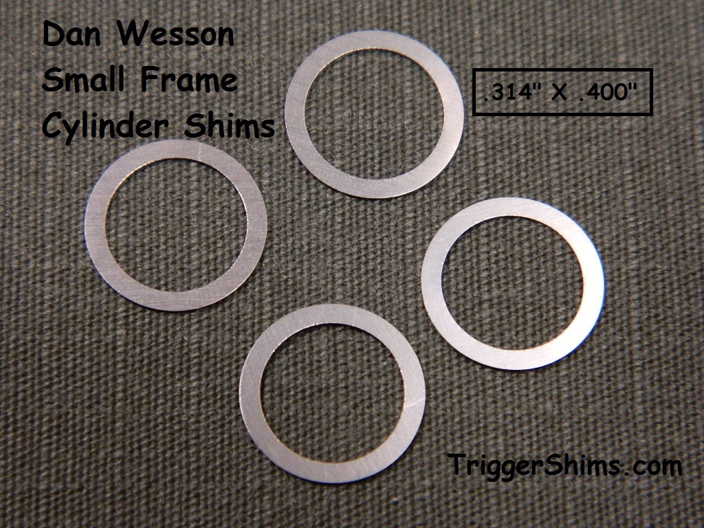

Regarding #2 (Cylinder End-shake problems)
This rarely comes up with Dan Wesson revolvers, but it still happens from time to time. I think Dan's are more resistant to end shake issues due to the way they lock up but... If you have a really loose front to back cylinder play on your revolver, some of the inertia and momentum of the hammer/firing pin strike gets taken up by the cylinder moving forward - which translates into less firing pin energy, and a weak or light primer strike.
The solution for an end shake problem is to install a cylinder end shake shim, after first making sure the cylinder ball tension (at the rear center of the cylinder) is adjusted correctly. Triggershims.com sells inexpensive cylinder shims for Dan Wesson revolvers. They are nice to deal with as well.
http://triggershims.com/cylinder_shims.html#S14

Dan Wesson Small Frame
Dan Wesson Cylinder / Endshake Shims
Our Shims will fit many Small Frame Dan Wesson Revolvers
Made from USA Full Temper 300 Series Stainless Steel
Nominal O.D. of .400" X I.D. of .314"
Fits Many Small Frame Revolvers
2 Pak   Comes in .002"
4 Pak   Assortment comes with 2 each  .002" and  .003"
6 Pak   Assortment comes with 2 each  .002",  .003" and  .004"
12 Pak Assortment comes with 3 each  .002",  .003",  .004" and  .005"
24 Pak Assortment comes with 6 each  .002",  .003",  .004"  and  .005"
30 Pak Gunsmith Special Assortment comes with 6 each  .002",  .003",  .004", .005"  and  .006"
-OR- Choose any Pak and Specify your Thickness via Drop-Down Box,
e-mail or use "Note to Seller" in PayPal
Price includes Free Shipping
Dan Wesson Small Frame Cylinder Shims
A 2-pak of cylinder shims starts at $5.00

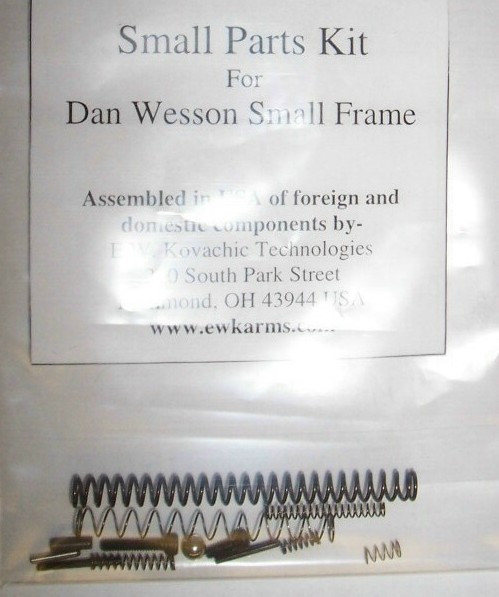

Also, one of our forum sponsors on the right sidebar EWK ARMS, has a very convenient Dan Wesson small parts replacement pack for only $19.99.
http://ewkarms.com/zen8/index.php?main_page=product_info&cPath=67_12&products_id=19
EWK-DW-Smallpartskit.JPGImage Enlarger
EWK's Dan Wesson Small Parts Assortment contains many small hard to find parts, like roll pins, side plate screws, a spare cylinder ball, replacement hand spring, main spring, firing pin spring, and so on.
At $19.99, and it's definitely worth it to have all of these extra small parts on hand when doing a tear down, or performing an Average Joe tune up.
If you're having light strike issues, or performing an Average Joe tune up, this is a good time to check out and clean the firing pin itself, and the firing pin tunnel. You should also replace the firing pin spring while the revolver is apart.
Pieces of a broken firing pin spring can bind, causing ignition problems and other reliability issues. The EWK Small Parts Assortment contains a replacement firing pin spring and roll pin, in case you mangle the factory roll pin while removing it.

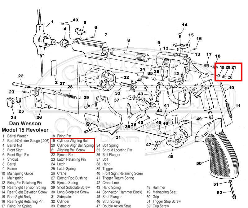

Here's a parts diagram, with location and part numbers for the cylinder alignment ball.
Click on the image to enlarge it.
DanWesson_15_schem_Cyl_Ball.JPGImage Enlarger
#19 Cylinder Aligning Ball
#20 Cylinder Align Ball Spring
#21 Aligning Ball Screw
Zoomed in view.
The Cylinder Aligning Ball Spring #20
Places tension on the Cylinder Aligning Ball #19
The Align Ball Screw #21, adjusts the amount of tension applied to the spring and ball.
Thanks for the compliments gang. It's gets a lot easier after you've done it a couple times.
Hopefully the link and parts diagrams will help it all make sense.
- Bullwolf

.009 with the cylinder shut.  And me pushing the cylinder back against the aligning ball as far as it will go.
The aligning ball pushes the cylinder forward, it seems to me I need the cylinder to be positioned back towards the firing pin.
I've ordered the shims.  Also ordered the small parts kit and a few other do-dads.
Thanks for the diagram Bullwolf, but how do I know how much tension to put on the aligning ball?
That's the same for the grip screw; How do I know the proper length and torque to put on this screw?

Someone will correct me if I am wrong but I think you measure the cylinder play front to rear without compressing the cylinder aligning ball. The purpose being to measure how far forward the cylinder will move under pressure from the firing pin, thereby absorbing the momentum of the firing pin and causing a light strike on the primer. If the play is greater than .001 or .002 under this method, then it is probably too much and shimming is needed.
Generally, the aligning ball tension is set by turning the aligning ball screw in until it is even with the top of the screw hole.
As for the grip screw. There are 2 lengths for use with various type grips. For a small frame (.357) the shorter screw is most commonly appropriate. In any case, a rule of thumb would be that the screw should not need to be tightened more than 10 full turns once it starts into the frame post. As previously mentioned, when the screw goes too far into the frame post, it will interfere with the main spring and cause problems mainly with double action function.
