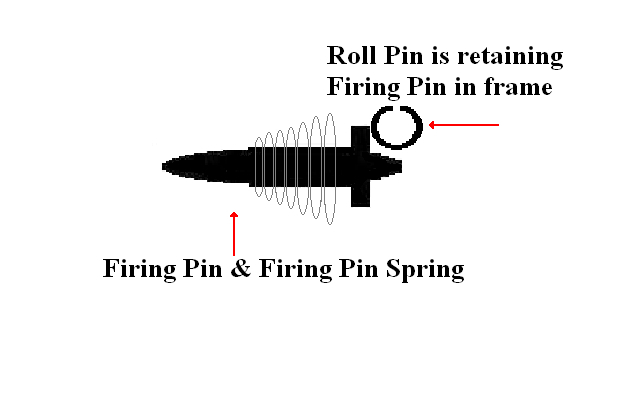

How does the roll pin work to hold the firing pin and spring in place?  Is it related to the "notch" in the side of the pin?
Yes, the roll pin keeps the firing pin from "falling out" backwards towards the hammer. In this crude and not to scale drawing, you can somewhat see how the roll pin helps retain the firing pin in place.
Retaining-Roll-Pin-1.jpgImage Enlarger
Once the roll pin has been removed - you can pull the firing pin & spring out the back (pull back the hammer some) for removal, cleaning, or replacement.
I like to use a small magnet to remove the firing pin easily once the roll pin has been taken out. It also tends to pull out the spring along with the firing pin as a one piece unit, so you are less prone to drop anything.
The firing pin spring mostly makes sure that the firing pin retracts "flush" and does not stay stuck in the protruded position. It also likely offers a small amount of gun drop safety protection as well. In my experience firing pin springs are pretty much fool proof, unless installed backwards.
(If installed backwards the spring tends to bind up on a tapered firing pin)
A firing pin spring can also cause binding/hanging up problems if it gets broken from repeated dry firing, but that's a somewhat rare occurrence. You will recognize it pretty fast if it does happen though, as the spring will come out in multiple pieces if broken.

ah, makes sense; my Smiths have a notch in the firing pin itself and I didn't see anything on on the DW pin.
So, I couldn't get the pin to move even with a bigger hammer, so I am going to put some penetrating oil in the hole and let it soak for awhile I am told it will not damage the bluing.
Thanks for your help.  DW is a very different animal than Smith!

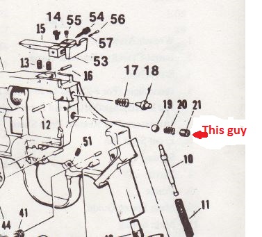

The only other thing I had thought to suggest would be checking the tension on the cylinder ball.
It's been mentioned before in a great write up by one of our Dan Wesson forum members, Nigel here.
https://www.danwessonforum.com/forum/revolvers/fixed-an-intermittent-double-action-misfire/
