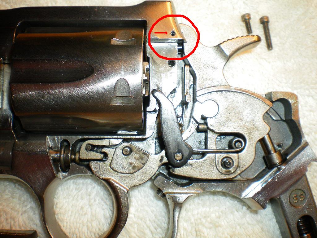

I had a very similar light strike problem in double action mode with my 714 Dan Wesson. I also ordered a few replacement firing pins from Numrich, and tried replacing the firing pin hoping to fix the issue.
Here is a picture showing the roll pin location (circled in red) that you need to remove to take out the firing pin. It is above the upper screw on the side plate.
Firing-Pin-Roll-Pin-Location.JPGImage Enlarger
The firing pin also has a spring, make sure that you put the spring on in the correct direction. Also check the firing pin and channel for any burrs or spots where it could possibly hang up, clean it well while you have the firing pin out, and do not over oil the area as it will just attract more crud. This is also a good time to replace the firing pin spring since you should have a spare from the EWK small parts kit.

Sure. It is just above the top of the side plate, or if looking on the right side, it's... uh... the only pin you can see. big-grin
Edit: Oops, there *is* another up by the sight, but nowhere near the firing pin. I see Bullwolf beat me to it.

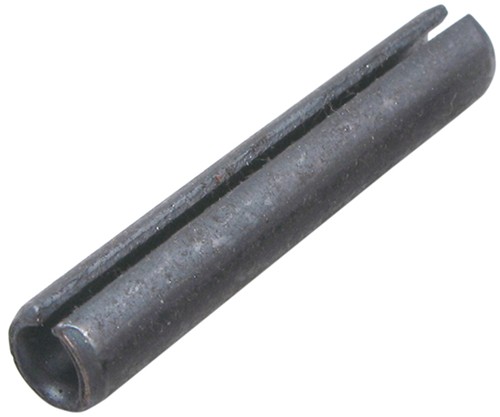

i am so sorry  and feel really dumb for asking but on my gun,  I can't see anything in the hole circled in red; If there is a pin, what size punch do i need to pull the pin out?
Forum Posts: 5445
June 20, 2014 - 8:28 pm
1/16" is the correct punch size.  We're here to help- just let us know what is going on.  Do you have a wood or rubber grip?

Thanks  the grip on the gun is rubber, but of course it is off the gun when disassembled.  we tried the 1/16th punch but didn't get far and were afraid of damaging the gun .  a paper clip will pass through the hole without touching anything.   I have the proper tools, 1/16 punch, brass hammer and composite backing but am hesitant to bang away at what  i can't see.

A paper clip will pass through the channel because it is small a roll pin that is retaining the firing pin, and not a sold piece of bar stock.
Take a look again at the Average Joe Tune Up as the 16th photograph shows it being removed.
If it does not want to come out from one side, try tapping the roll pin out from the other side to get it started. You shouldn't need to force it once it starts moving, but you will require the punch to press it all the way through the frame hole. It's (the roll pin) a very easy part to replace should anything happen to it in the process.
