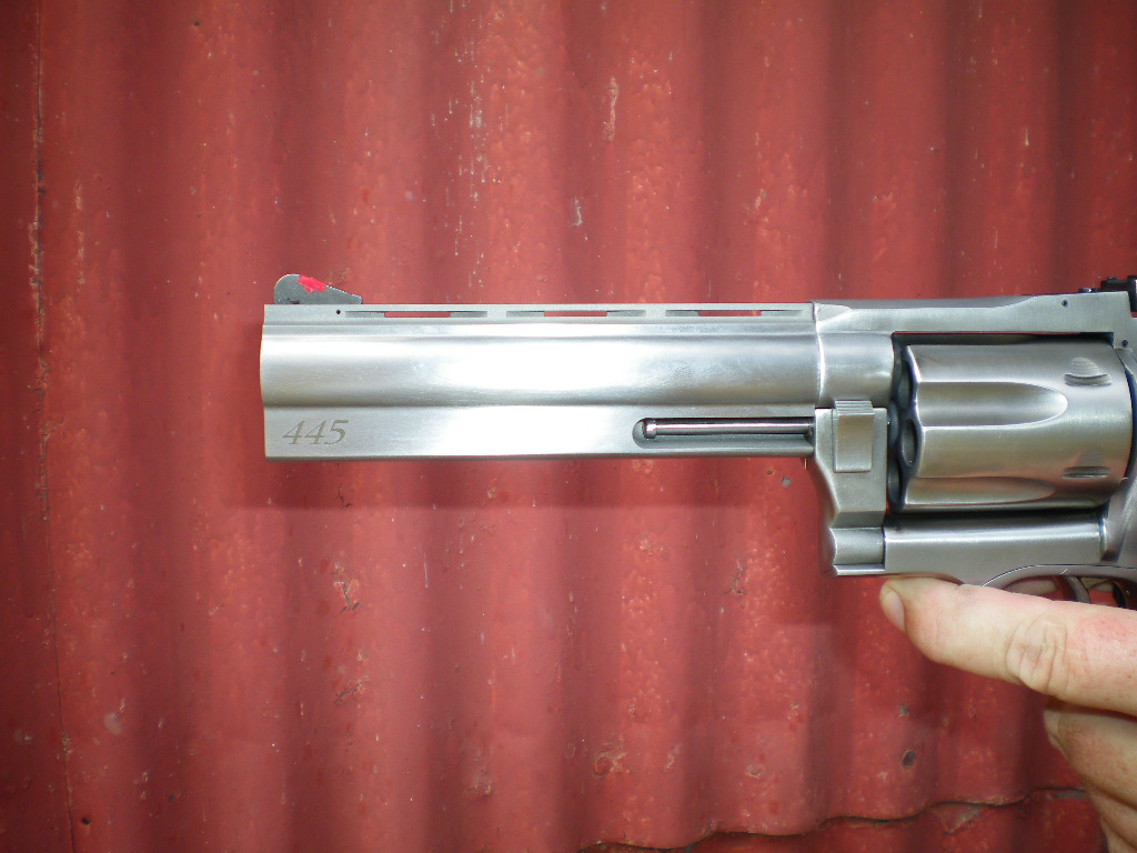

Moving on to the 44 Magnum REVOLVER testing.
Federal Factory 240 grain 44 Magnum JHP (for a production ammunition baseline)
Test revolver is a Dan Wesson 445 Super Mag w/6 inch barrel assembly.

445-6-inch-BA-Close-Up.JPGImage Enlarger
