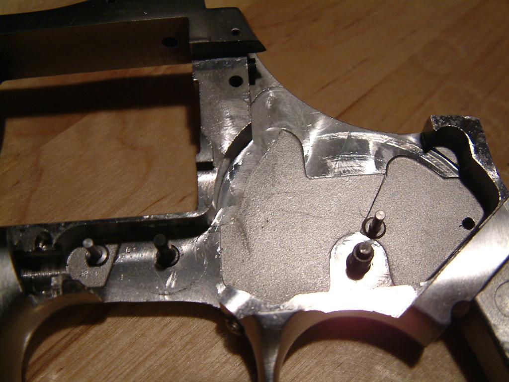

OK, just some additional info --  I don't have many Palmer guns, so this was an eye opener for me.   I completely overhauled The two Palmer 715's I just bought.  The original owner told me they were always "tight" ever since he bought them.  I assumed once I cleaned them up and relubed them, all would be well....  Not so... Not to my DW standards...
Both of the guns have nice fit/finish, and sideplates are a very tight and perfect fit.  Literally had to pry these ones apart (several times...) All looked great inside, but both were VERY hard to cock even after I stripped / cleaned them.
After a quick study, I determined the cylinders are fit so perfect, they are actually binding in the frame.  One of the guns will not cock on chamber 6 because it gets too tight (no barrel installed for cylinder testing). There is ZERO movement front/back at full lockup.
  I'm surprised these left the factory this way--your average gun owner would have had to send it back to the factory for better fitting.  Good news is I do my own fitting, so no worries....some day I'll reduce the cylinder length a little bit and get it running perfect.  I did a quick polish on the cylinder /crane and got it to turn on all six cylinders, but it is still too tight--maybe after I run a few hundred rounds through it will loosen up.

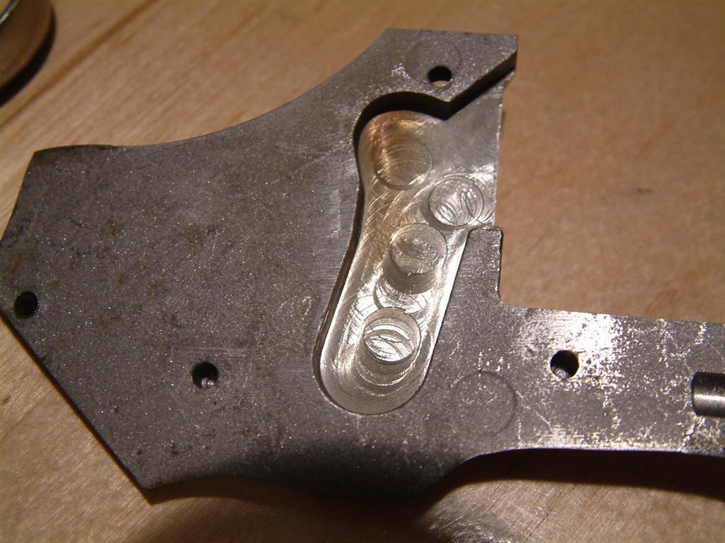

Anyway, here's some other info...  Both of the guns had heat damage to the side plates inside due to a dull end mill--internal machining is rough.

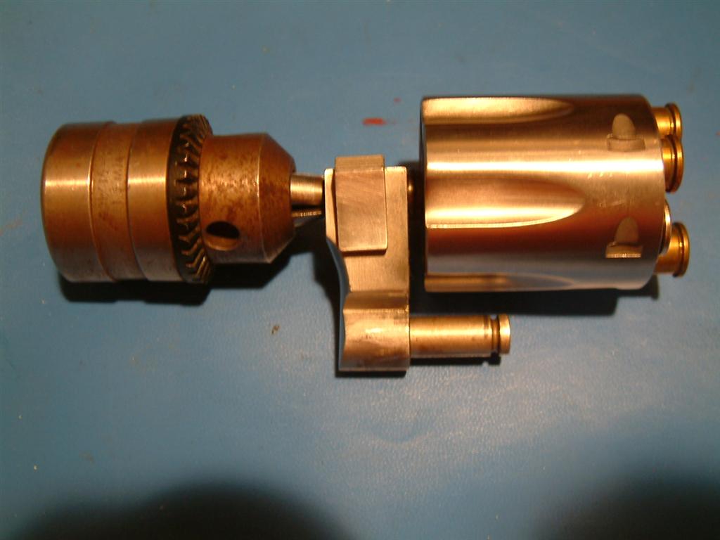

and just because I haven't shown it yet.... here is the best way to remove your ejection rod for crane cleaning... drill chuck will not slip at all, and empty cases support the star.

Shoot's example of ejection rod removal is spot on; it simply unscrews: clamp knurled tip of ejector rod between wooden blocks in vise or PADDED locking-jaw pliers (or Shoot's chuck method). Insert two empty cartridge cases in opposite chambers, and use cases to unscrew cylinder from rod.
