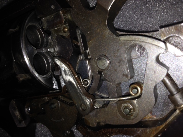

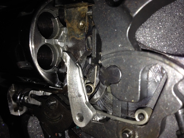

Not the best photo taker sorry but hopefully this helps you guys maybe spot something I'm not.  Decided to leave the side plate screw in place to keep the spring loaded plunger in check.  That sucker pinched me good once already screwing around with this.
Removed the hand for photo purposes and put the hammer back into what should be the cocked position. From what I can tell the notch in the trigger should hold it in place against the matching notch on the hammer till pressure is applied and releases it correct?  However the surface contact there on those two parts appears very worn and slightly rounded off.  They should be squared to each other right?
Sorry but its tough to photograph the area that appears rounded off.  Stupid flash etc.... I really think this is the root of the cause as to why its not catching and staying cocked back in single action.  Maybe trying a new trigger or hammer would be the ticket.
Please though if you spot something else that I'm not by all means I'm all ears.
I'm going to suggest to the owner that a new spring refresh kit isn't probably a bad idea either.  Gun is what, 40 something years old now? I've noticed the trigger doesn't always like to return back it forward most position after a DA pull.
Even though its not my firearm and I'll have to eventually hand it back I've had fun working with it so far.  I enjoy taking stuff apart and tinkering as I said and this forums been an excellent resource so far.  I really do appreciate it.  I guess it will ultimately depend on how much if anything he wants to invest into this thing. Im just glad he had the smarts to function check it first before loading any ammo into it and having a possible discharge unexpectedly with it.  I'm really hoping he and I can get it back in good working order and get in some quality range time with it.  From what I'm researching these things are very good shooters when functioning properly.  I'm also afraid I might have to keep my eye out for a Dan Wesson type revolver for my own arsenal now ;)
Patiently awaiting some of your replies.

Really hard to tell by these pics. Especially  the  trigger alone. From the lock works pic it seems that the hammer is the worn of edge. Is that so? Or trigger?  Can you push the hammer over, when its locked?  Is the interrupter/hand spring fitted into the cutout and hole in the interrupter bar? I will try to post some pics of my own gun's works, shortly. And some close ups of the sears.

Springs appear to me to be in the correct placements.  The hand advances the cylinder forward if thats what your asking and the transfer bar moves up to the fire position as well.
On a good note I called the owner and he said he is willing to invest some money so we will definitely order some fresh springs from Wolff.  I've also sourced on ebay a seller claiming to have a hammer and trigger from an actual HS MKIII.  Looking at the pictures of those online compared to what I have here in front of me is night and day difference.  I think he is going to green light me to snag those parts and give it a shot.
I'm about to tear it down again and I'll attempt with some different lighting to capture actual decent images of those two edges so you can see what I mean by rounded off. Almost forgot he mentioned he would prefer wood grips (so glad he brought that up) over the rubber Hogue ones on it currently.  I just love good old wood and steel lol.

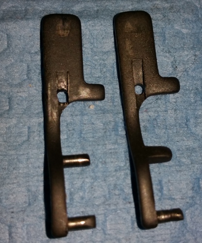

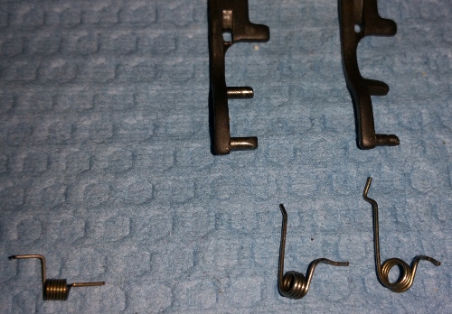

See your 15 porker looks like the w-12 spring.  my MKll is a porker but the spring is longer but not as much as my 15-2. see my pics up top, not as good as yours, i may go back and take some more, but my spring looks more like the one in jgwills pics..  in fact I will do that in the morn..  HS  vs 78' 15-2.  all I have to compare but I do have 3 sizes of hand spring..
Aw heck ya'll know how it is, I couldn't let it set til the morn..
20150128_211320-500x348.jpgImage Enlarger
 far left is a W-12 hand spring.  the middle is from my HS MKll and the right is from 78' 15-2.  Not super large in comparison but for sure. and next20150128_211401-416x500.jpg
   the interrupter or disconnect which ever you choose,   HS on the left ,  15-2 on the right.  again you can well see the difference in the  spring noc,  spring mount pin and the locator pin for the trigger....My 15-2 has quite a bit of wear on locator, guess I should do something about that since I took it out again.  Anybody else have something different in the small frames?  Please share.
January 28, 2015 - 9:48 pm
trigger returns are almost identical, the short arm on the  HS  had slightly less turn. I didn't check the hammer springs or the bolt springs, though I don't see them being much different.
