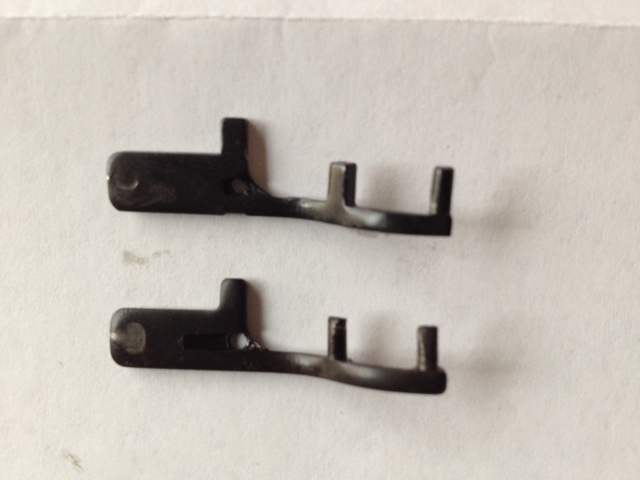

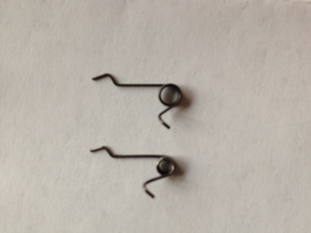

Ah now I see what you mean Ese. I am sorry I did not dig as deep as I should have yesterday. My HS and 15-2 hand springs are shaped the same, but now I see you are right the coil part on the newer one is a larger diameter.
Here is HS MKII on the bottom and 15-2 on the top-IMG_0774.JPGImage Enlarger
And I now see the difference in the transfer bars HS on the bottom and 15-2 on the top--IMG_0775.JPGImage Enlarger
I apologize for being incorrect on this. It is obvious I'd never make a living working on firearmsconfused
