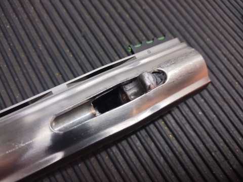

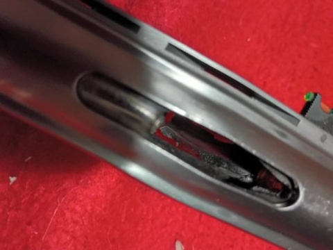

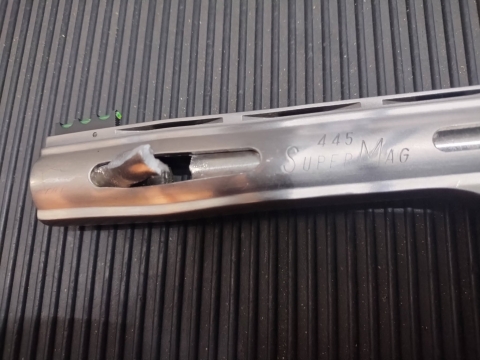

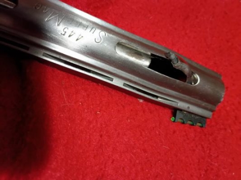

So, LGS passed on trying trying to drill and break stripped barrel nut I stripped using the EWK extractor on my blown up 7445 barrel.      I just couldn't say "cut the thing off" without even trying to salvage the shroud.
702612087_10244473841047795_8062172225042322055_n.jpgImage Enlarger
702751937_10244473841967818_3081123550178122061_n.jpgImage Enlarger
I still think the shroud is salvageable if I can get the barrel out of the shroud.   Impossible?   Maybe?   Too much work?   Without a machine shop, DEFINITELY!
My novice thoughts were that if the barrel nut were drilled out to even partially release the shroud from frame over the bulged barrel, then I might slide the shroud forward just enough to clear the alignment pin. Then, I could unscrew the entire barrel assembly from the frame.
It would not immediately solve the removal of the barrel from the shroud problem.    But the frame is no longer at risk.    Plan is to use punches to bend the barrel in through the slotted shroud and hopefully slide it out.   The bulge in the shroud is for the LGS to bring back to specs after I do the work he wouldn't......(and I understand why).
Cleared the squibs from the barrel.   Drilled through the barrel nut @ 180 degrees.   I went through 5 drill bits snapping each one.  Half the nut is loose.   Half is not.   It might have a snapped bit holding the half in place?   How do I remove the nut?
Kroil went right through the threads before drilling.
Don't tell me it can't be done.  I'm gonna do it anyway.   I am going to have to get really pissed or defeated before I tell the LGS to cut it off.
Looking for fresh ideas.

Drill right down the center of the barrel using ever increasing size til you get it thin enough that you can use a punch to fold the end of the barrel inward. If your set up is solid enough you can just about drill it all the way out to the remaining barrel nut.

Good luck with your project.  I think it is beyond help and if you have replacements, you might save some frustration by just "cutting your losses" and cutting the shroud/barrel.
