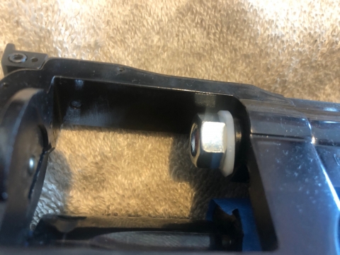

May 14, 2017 - 12:46 pm
I'm sorry but, I visually can't understand how the clamp is applied to the gun to remove the barrel nut. Can someone draw a picture for me please? the photo above some to look like one end of the clamp is on the trigger Guard and the other is at the end of the barred, thus covering up the access to the nut.
Rimfire
Forum Posts: 341
February 4, 2017
27
May 14, 2017 - 1:57 pm
I'll take a stab at this...EWK offers two styles of barrel wrench. One is round and the other is a hex drive with six flat sides. The clamp is used to hold the hex drive in place firmly against the barrel nut, and then the crescent wrench is used on the flat sides to loosen the stuck nut. Hope that help...
Rimfire
jertex
Fort Worth, TX
Forum Posts: 306
February 22, 2017
28
May 14, 2017 - 3:32 pm
The fixed end of the clamp is pressing on the forcing cone, the end with the handle is tightened against the end of the barrel wrench which is inserted & pressing tightly into the barrel nut notches. Then I used the crescent wrench to turn the barrel nut wrench. I can take more detailed pictures if that will help.

May 14, 2017 - 6:03 pm
Here - this should help.  In my experience, it's always been the simplest, most effective method for breaking loose a stuck barrel nut.

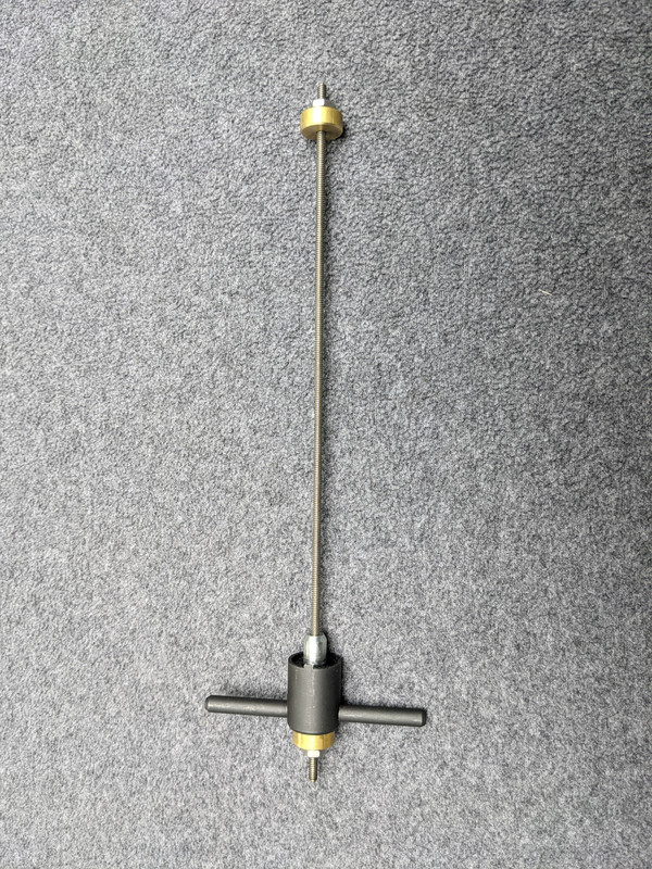

June 4, 2021 - 11:47 am
I thought I would add something to this great and useful thread , as its only a matter of time before a Dan Wesson owner will experience this situation .
The new-to-me  M740 came with three barrel nuts , one of which was a factory design with only the two slots ( unlike  the EWK version with 4 ) that was buggered on the side needed for removal . I did not notice that it was rounded-off before installing it . Worked awesome on the installation , not so much on the removal .
Using EWK’s excellent barrel nut wrench , I modified it by putting it on a lathe with a 5C collet and drilling a .150 “ diameter through hole ( on center ) for a 10 inch length of stainless 6-32 threaded rod . On the ends I had a couple of #6 flat washers , a couple of faced off chucks of brass ( to prevent marring , galling and burrs ) and two nuts …. I put un-shrunk shrink tubing on the threaded rod before inserting into the bore to protect the rifling , crown and forcing cone .
Finger tighten the nuts so there is slight pressure to prevent the barrel wrench from camming out .
It works fantastic . The stripped and buggered barrel nut was broken free in less than ½ turn  .
I think this thread should be a sticky if it isn’t already one that is created addressing this issue …. I tried using the search function to possibly find the topic , but the results from the search had no relevance to stripped barrel nuts ?

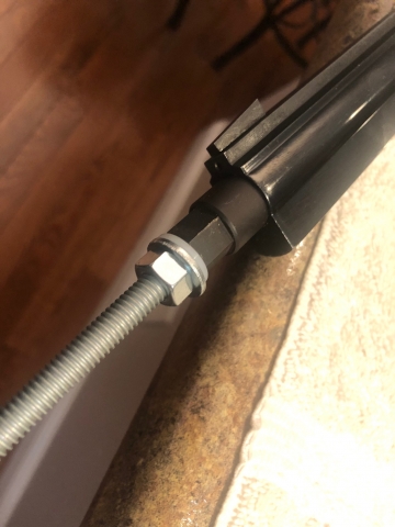

April 23, 2024 - 8:19 am
IMG_7797.jpegImage Enlarger
IMG_7810.jpegImage Enlarger
I had a stuck barrel nut on a pistol I bought off GB a couple years ago.  It had a 15” shroud. No matter what I tried (punch, oil, penetrating oil, heat, EWK special barrel tool [just like the one pictured above]), but I couldn’t get it apart.  I contacted Bob at CZ-USA (since retired) and shipped it to him.  Even he couldn’t get it removed without destroying the barrel tube, but thankfully he did salvage the shroud.  I’m still searching for a replacement 15” barrel.  My suggestion is to contact Genny@cz-usa.com.
