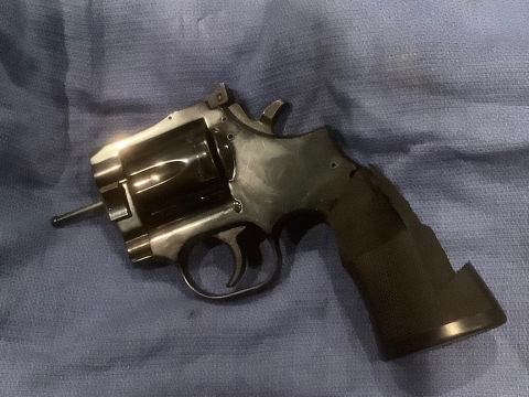

Picked this up a few weeks ago….in great condition except cannot remove grips or barrel nut
waiting on the ratchet strap to try getting the grips off…in preparation trying to remove barrel but the ba nut will not budge
used small vise grips on the wrench T handle for mor leverage, bent the handle…can be seen in the picture
hoping someone has suggestions
thanks

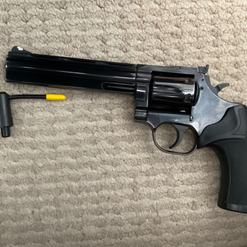

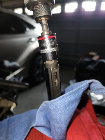

i talked to mike0251 on the phone….he did the post on putting the long bolt thru the barrel with the stripped barrel nut
my barrel nut was still functional so i soaked in liquid wrench for a couple hours then used the DW bolt wrench with 5/8 impact driver
came right off….thanks Mike!
Now…just have to get the grips off….getting the ratchet strap today, will report back
worst case will just cut them off.
