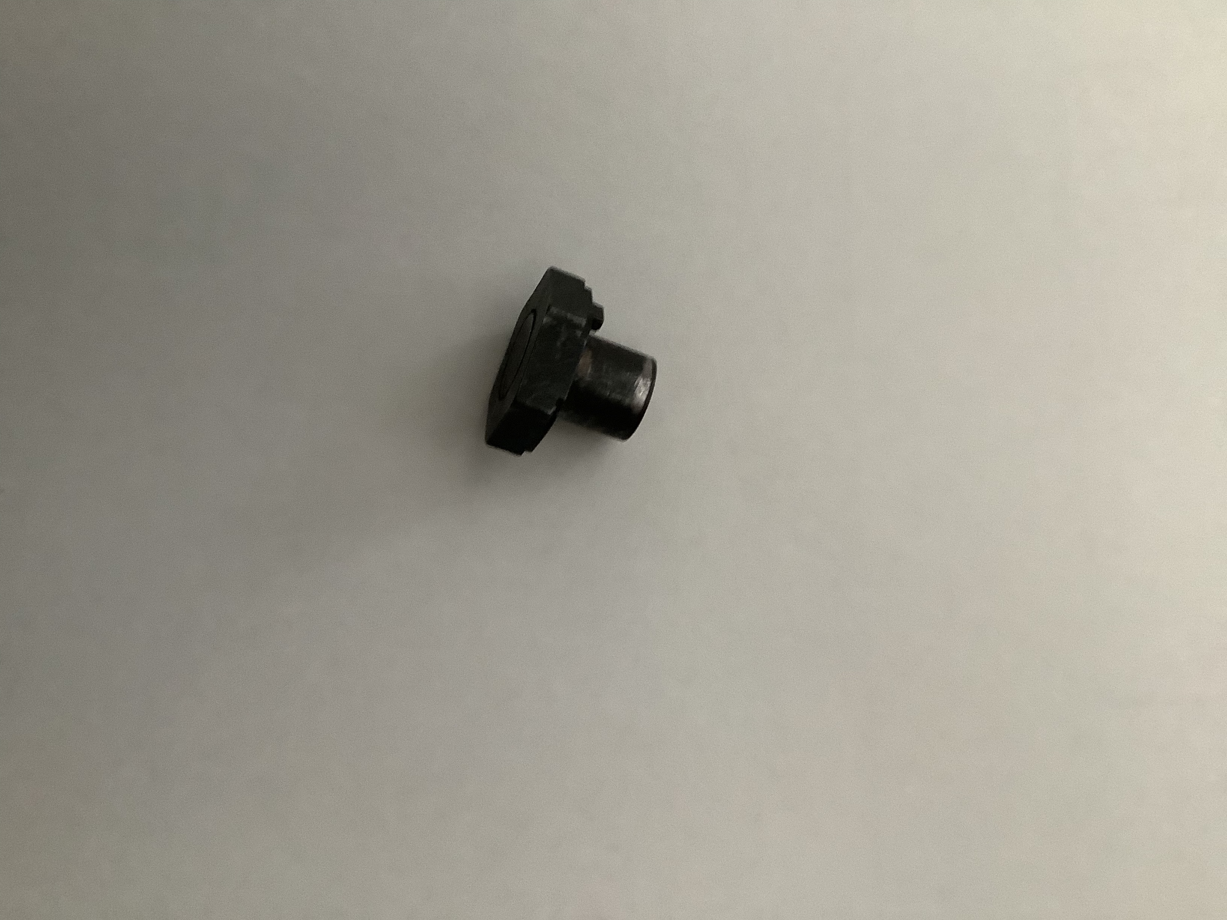

I have learned a lot how to remove a stuck barrel nut
use a barrel bolt with 5/8 socket and a hammer drill
975D4F24-8D53-46DC-B0E4-7A1F08120586.jpegImage Enlarger
Put something inside the socket like piece of shop paper towel so when you put the socket on the bolt it is putting pressure on the bolt so it won’t slip in the socket. Remove the grips, wrap gun in cleaning cloths, put in vise with soft jaws gun pointing up. Now, bolt in barrel nut…socket in hammer drill pressing down the hammer drill removes the barrel nut.
This has worked on two of my recent acquisitions with severely stuck barrel nuts.
