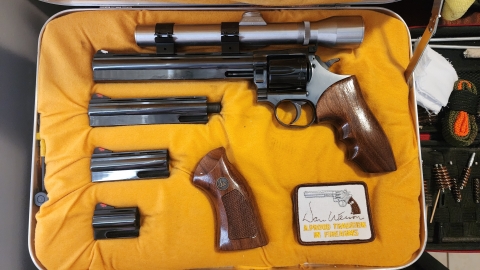

Glad you got your father’s Dan Wesson, that’s great…thanks for sharing your story.  Post a pic of it too!  All pics welcomed!

July 19, 2024 - 10:26 pm
20240719_170835.jpgImage Enlarger
27
July 19, 2024 - 10:54 pm
Absolutely beautiful, thanks for sharing!  Enjoy it for two reasons:  1st (and foremost)-it’s from your father, 2nd-in defiance of your country’s government.  I wish you the best always!

Sweet pac !
29
July 20, 2024 - 1:58 pm
Great looking Pac, thanks for sharing your cool-pics
