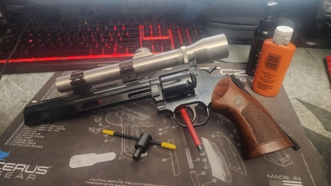

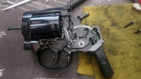

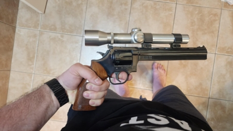

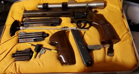

Been a hot minute since I posted!
I received the beautiful piece from my dad, did a thorough cleaning on it, and after a few adjustments to tension in certain places, this gun fires like a dream! No issues whatsoever. I sent what I did to my dad and he replied with "well, I didn't have the internet back then"
Going to perform the AJT on it here in the next couple days, and install new wolff springs, just need to pick up some honing oil.
Added some pics!

Looks barely used. Your barrel tool is the best type. 3 Allen wrenches and you are good to go. Perhaps your Dad was shooting 38 Special a lot and a ring of carbon built up in the chambers. That can be polished out. Your gun was made in the early 1980s. You will have a great deal of fun with the AJT.
 Be aware that the cylinder tends to close when ejecting cases. The extractor star can scratch the sideplate and gouge the back of the recoil shield if you let that happen. Hold the gun in your right hand and tilt it to the left as you use your left hand to open the cylinder and actuate the extractor rod. Use your right index and middle fingers to push the cylinder open and keep it open until extraction. Some folk do it a bit different but you have to prevent the cylinder from closing while the extractor rod is extended.
