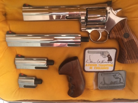

Upon picking up my gun and speaking with the shop owner, I found that I didn't have a 715, but a 15-2 VH, that the original owner had nickel plated, supposedly at the factory. I also submitted the serial number here at the DW site for date it was built.
It seems that every document that came with the gun was included. The warrantee card said February, 1982. The brochure looks as new. The belt buckle and patch are as new as well. The barrel tool was broken, and couldn't remove the barrel nut without me using channel locks. The nut seemed unusually tight.
So, this does leave me with some questions as to whether or not the value was reduced by it being nickel plated. I will say however, that the plating job is amazing, and mirror like, and at least equal to my Pythons finish.
What say you guys?
The gun is as pretty as a gun can get, and nearly flawless in finish!

Capt, you snagged a great prize. Factory nickel 15-2 Pack ANIB is a rare bird. If it can be verified or not, it is worth way more than a blue gun. Early nickel Dans did not have the hammer and trigger plated. It I possible if it was requested, DW would have done it. Get a plastic tool on eBay but don't use it. Then get an EWK or factory steel tool to use on this and all your future small frame guns.
Thanks Ole Dog, you confirmed my hopes. This gun is nickel everywhere. With that being said, if I don't shoot it, I don't hide it! I'm too old to collect "stuff" just for my kids to sell someday.
