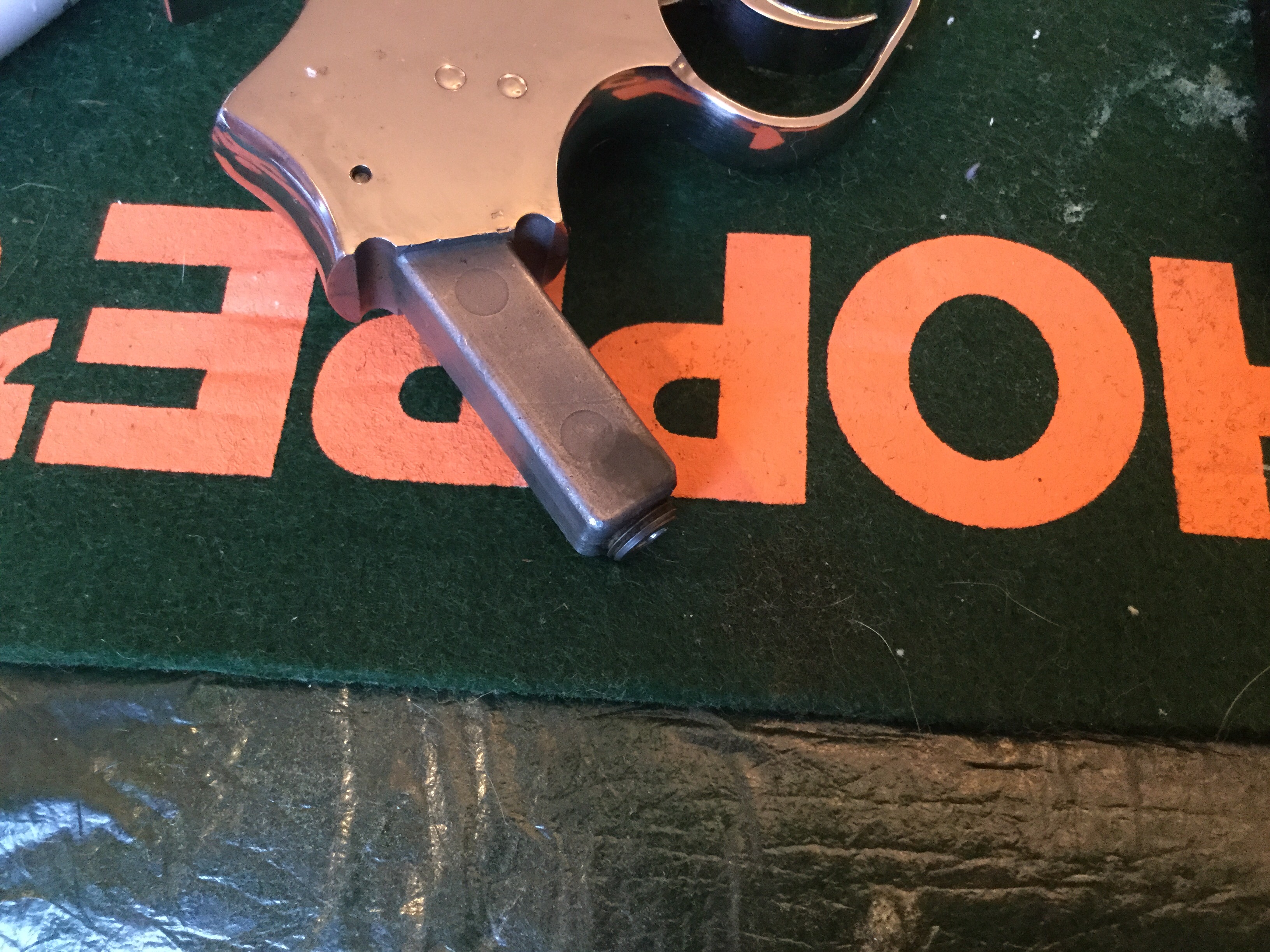

I think you are right. Not hard chrome. 99 percent sure it is white metal. The bluing has been removed. Keep it well oiled inside and out. If you have air conditioning and or live in the Southwest it would maybe be very slow to rust. The serial number indicates 1977 or so origin. The  cylinder stop, serial number, overtravel screw and absence of SS on the tang are sure proof it is not stainless. Considering the insistence of the seller that it is Stainless after repeat heads ups I would ask him to take it back. Or have it nickeled or chromed. Maybe have someone engrave it first. The rear sight is definitely white metal.

I'm coming into this thread a bit late.....it's white.  It went up half a dozen times before for the last couple months before it sold off. One of the tell-tale signs is the "claimed" stainless sight.  The manufacturer would have never cut the sight from stainless, and whoever took the finish off the gun should have at least left the sight blue.  I would never leave the gun white - you'll always be wondering when it's going to start rusting unless you store it in a bucket of oil.  I would ask for a refund with shipping reimbursed, but since it was misrepresented and the seller knew better it's tough to get blood from a stone.  The next alternative would be to blue it but then you're going to be dumping more funds in to the purchase.  Be wary of "unusual" Dan Wessons and especially non-cataloged items.

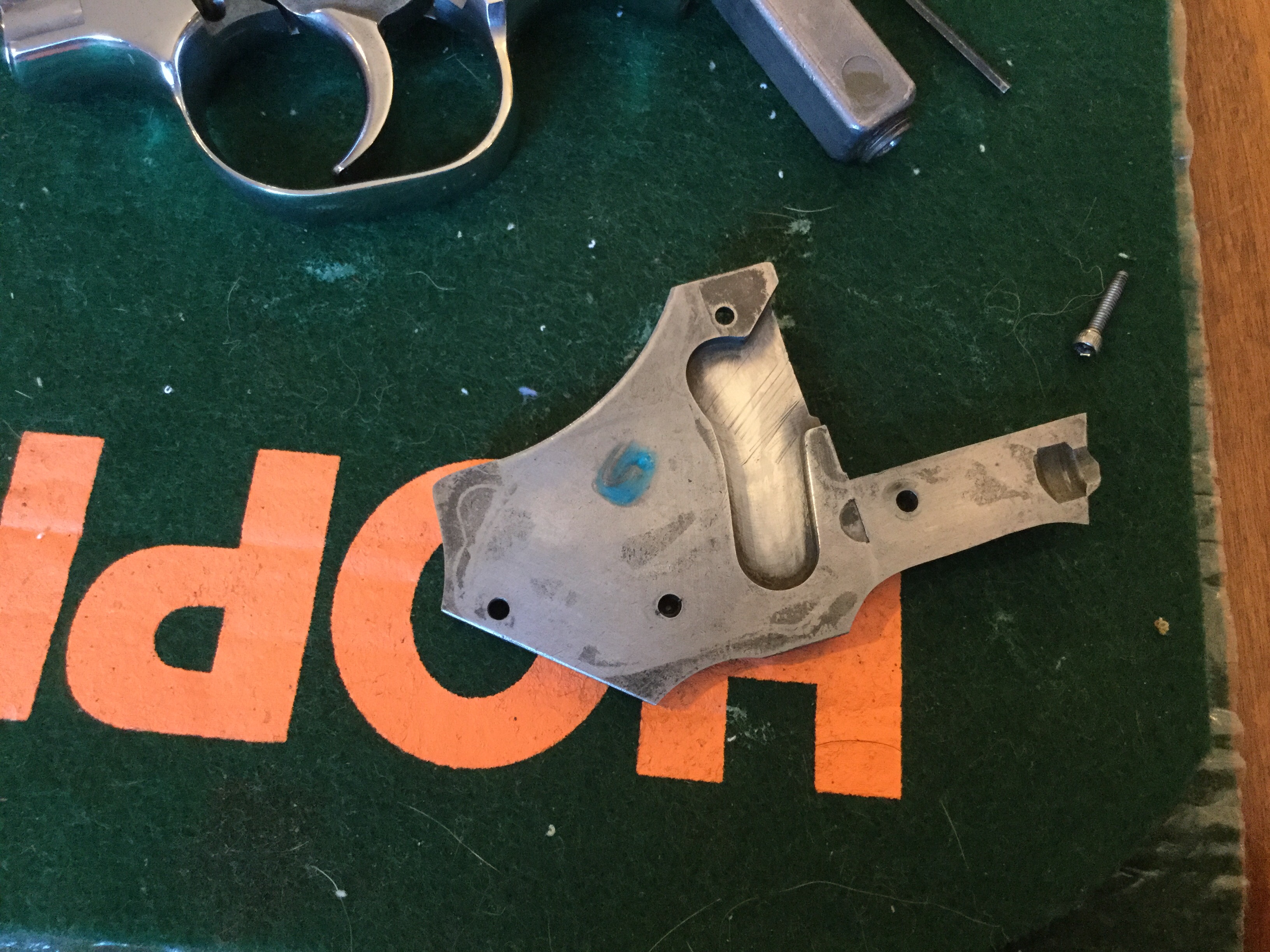

hit the inside of the sideplate with cold blue and see what happens...

exactly- and take a picture to send to the seller as the reason why you believe it to be carbon steel.  Of course, if you can get a return of some monies, invest in some de-greaser, Oxphoblue and ATF fluid....... or send it to a hot blue professional.

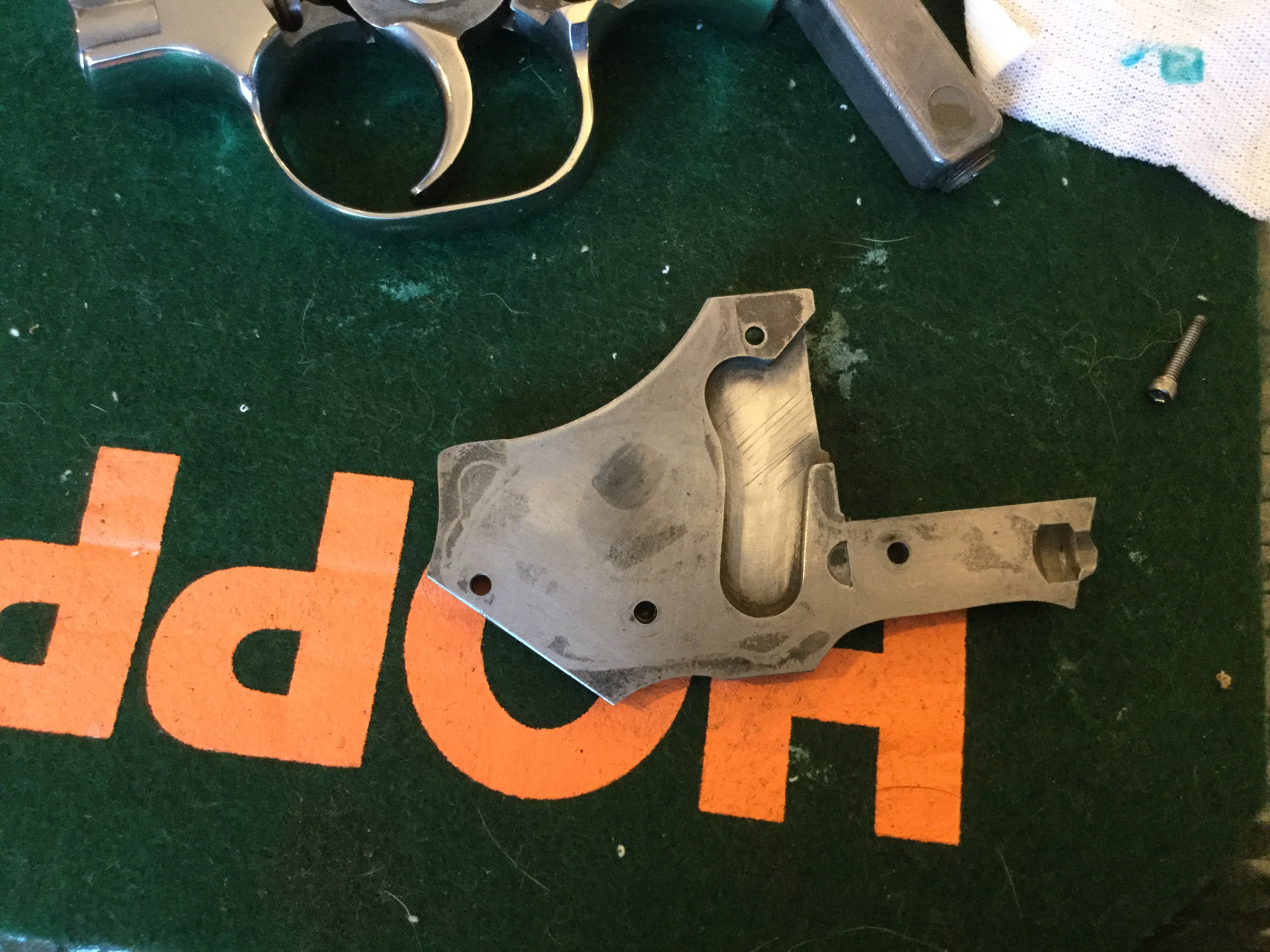

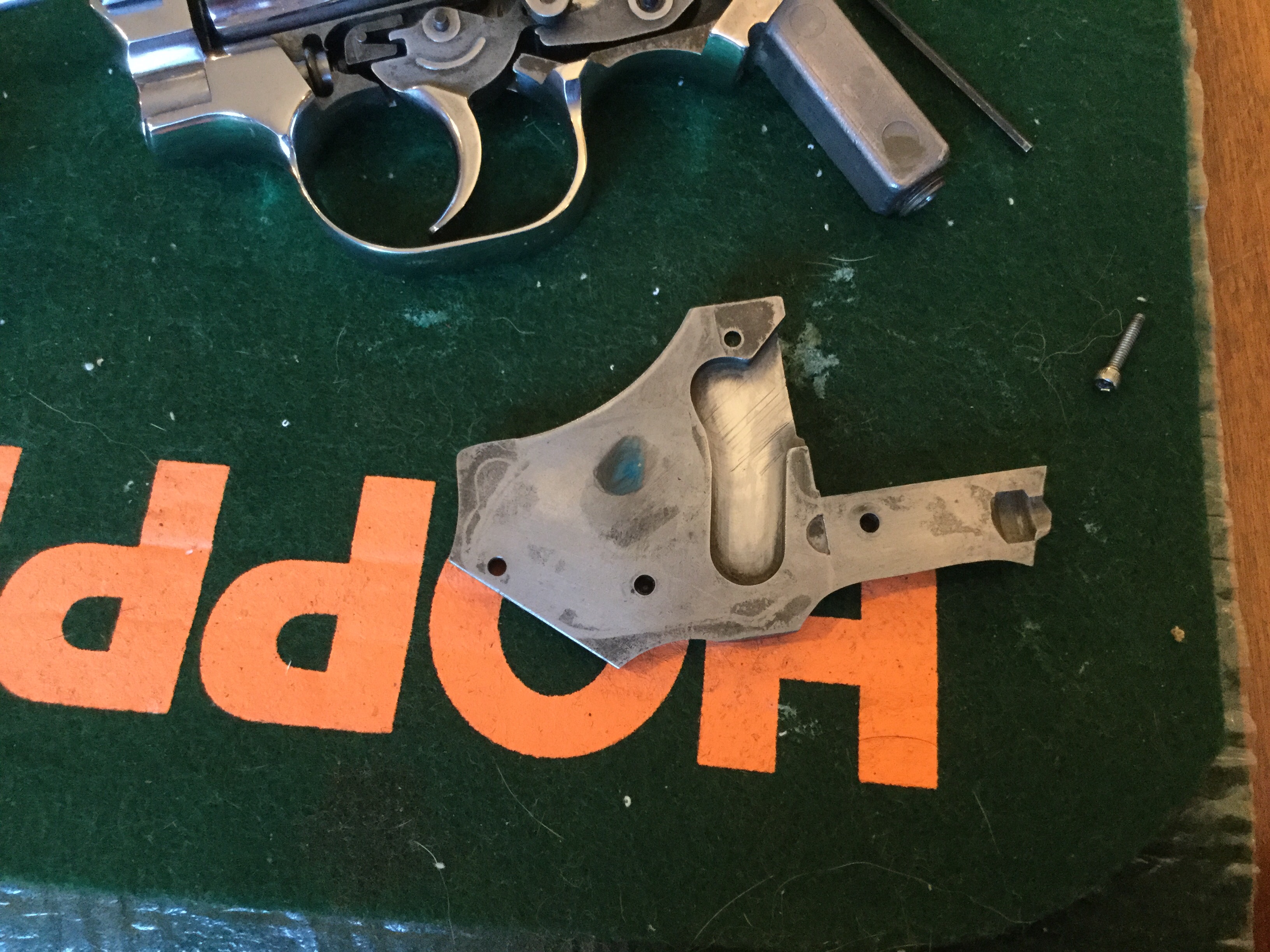

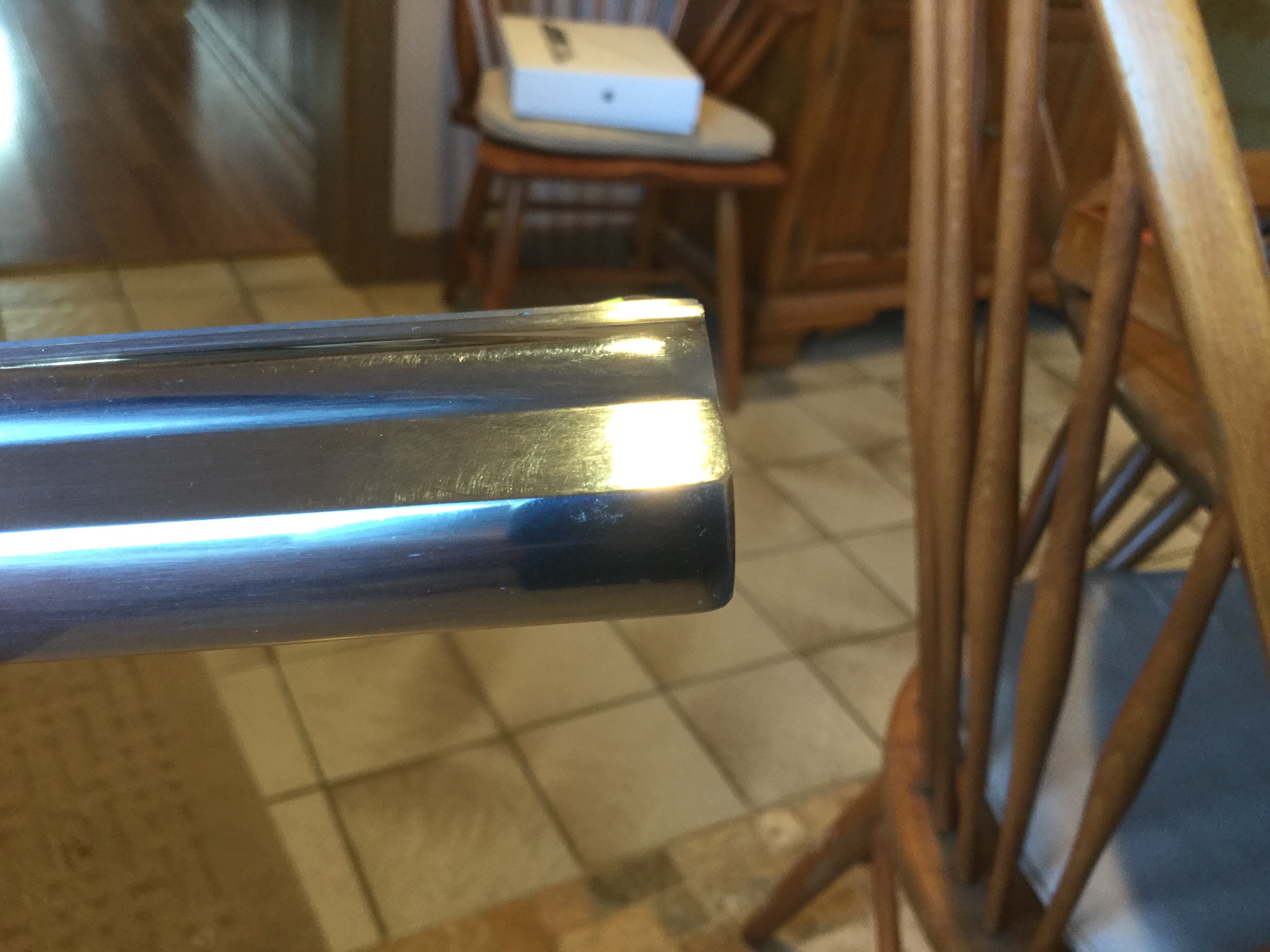

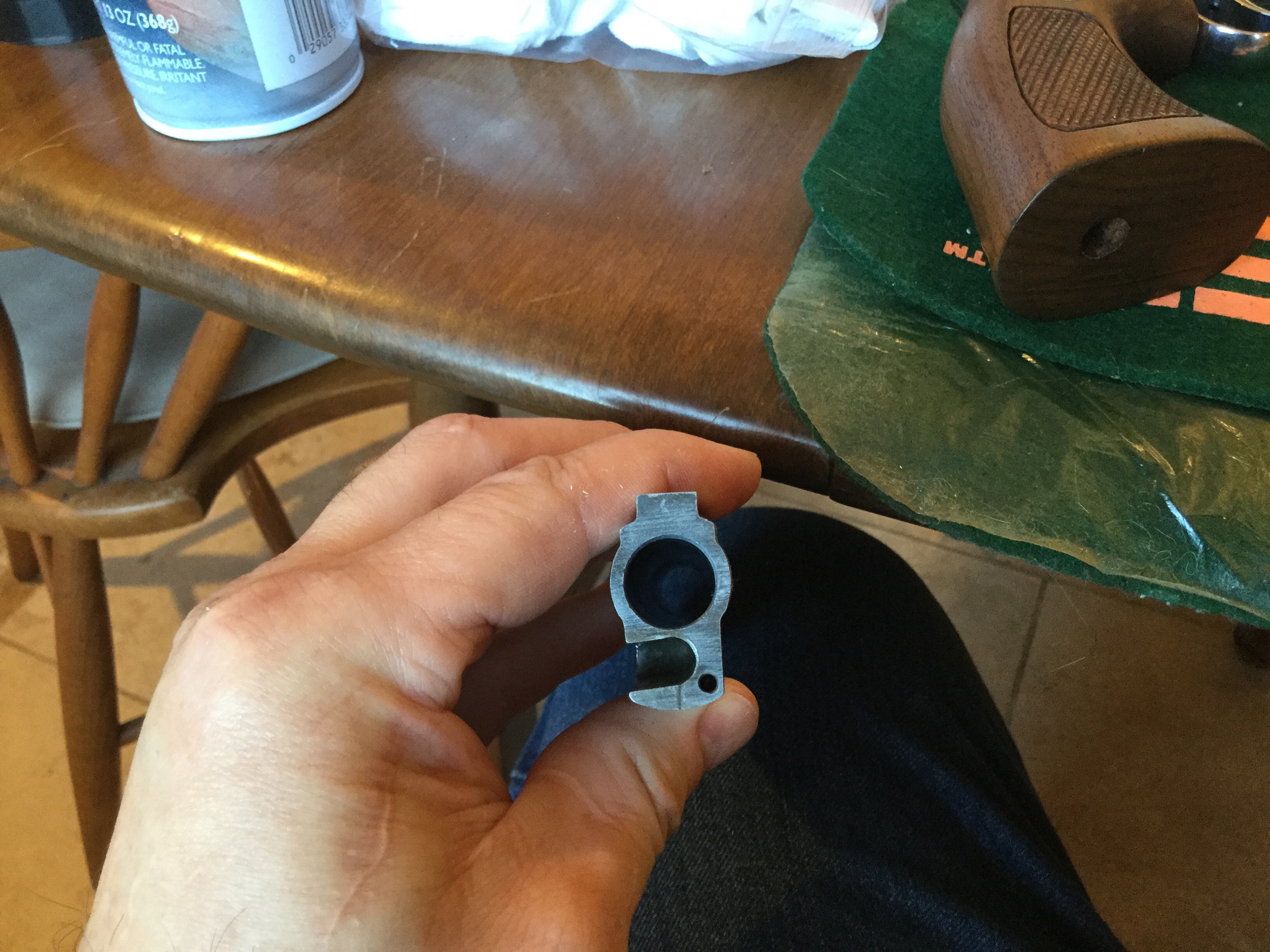

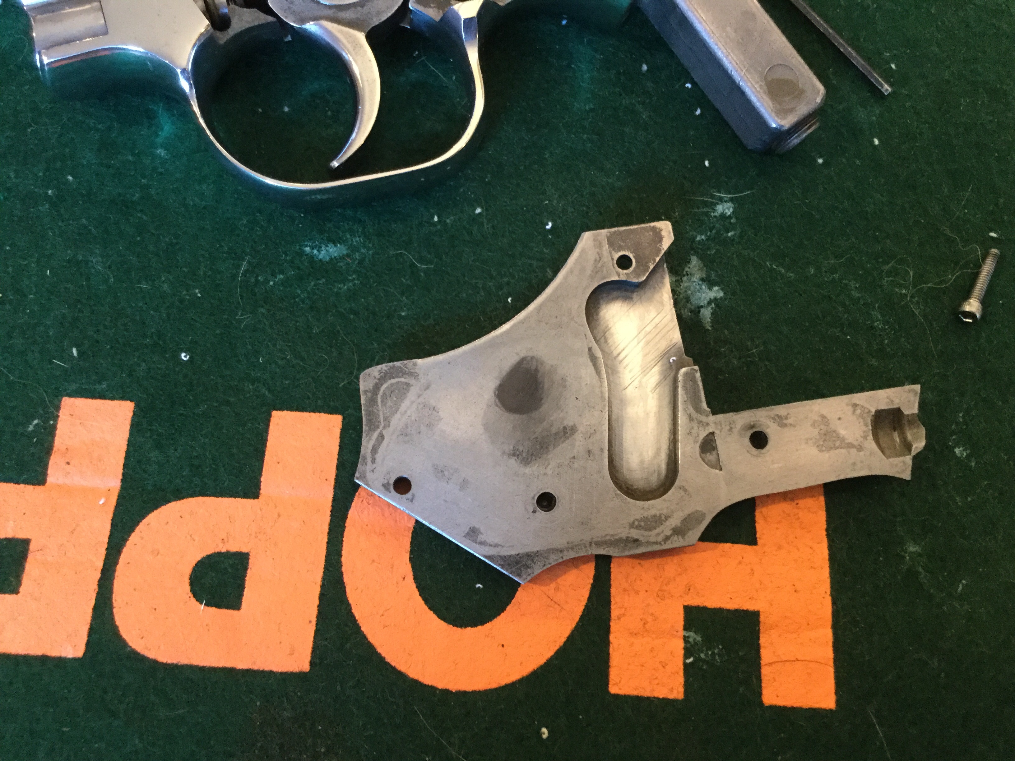

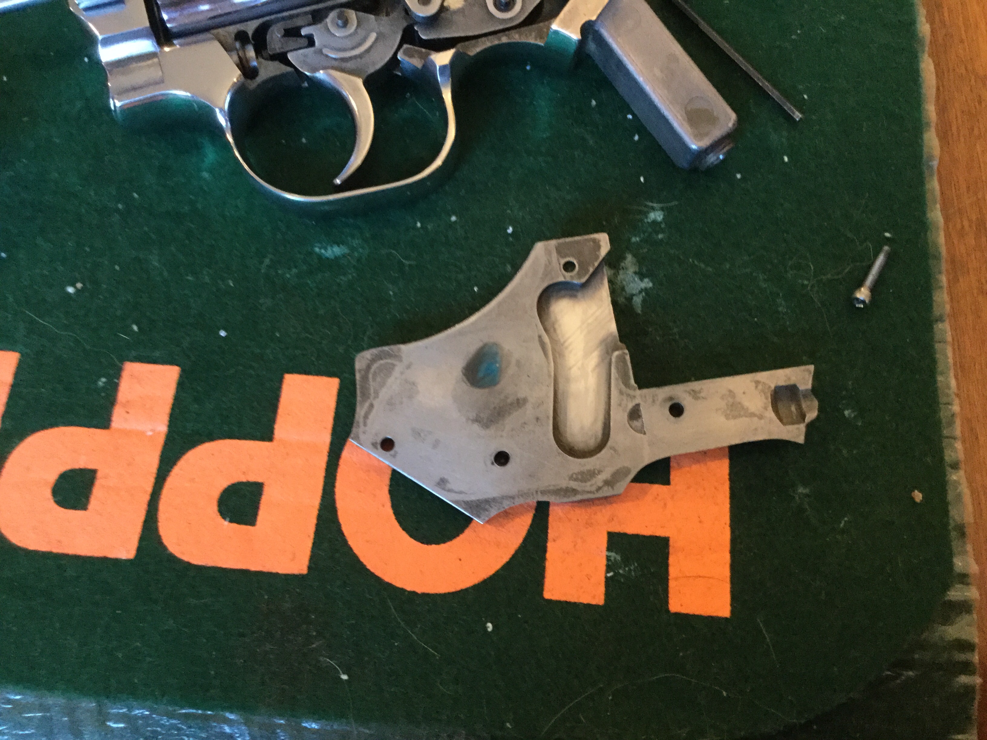

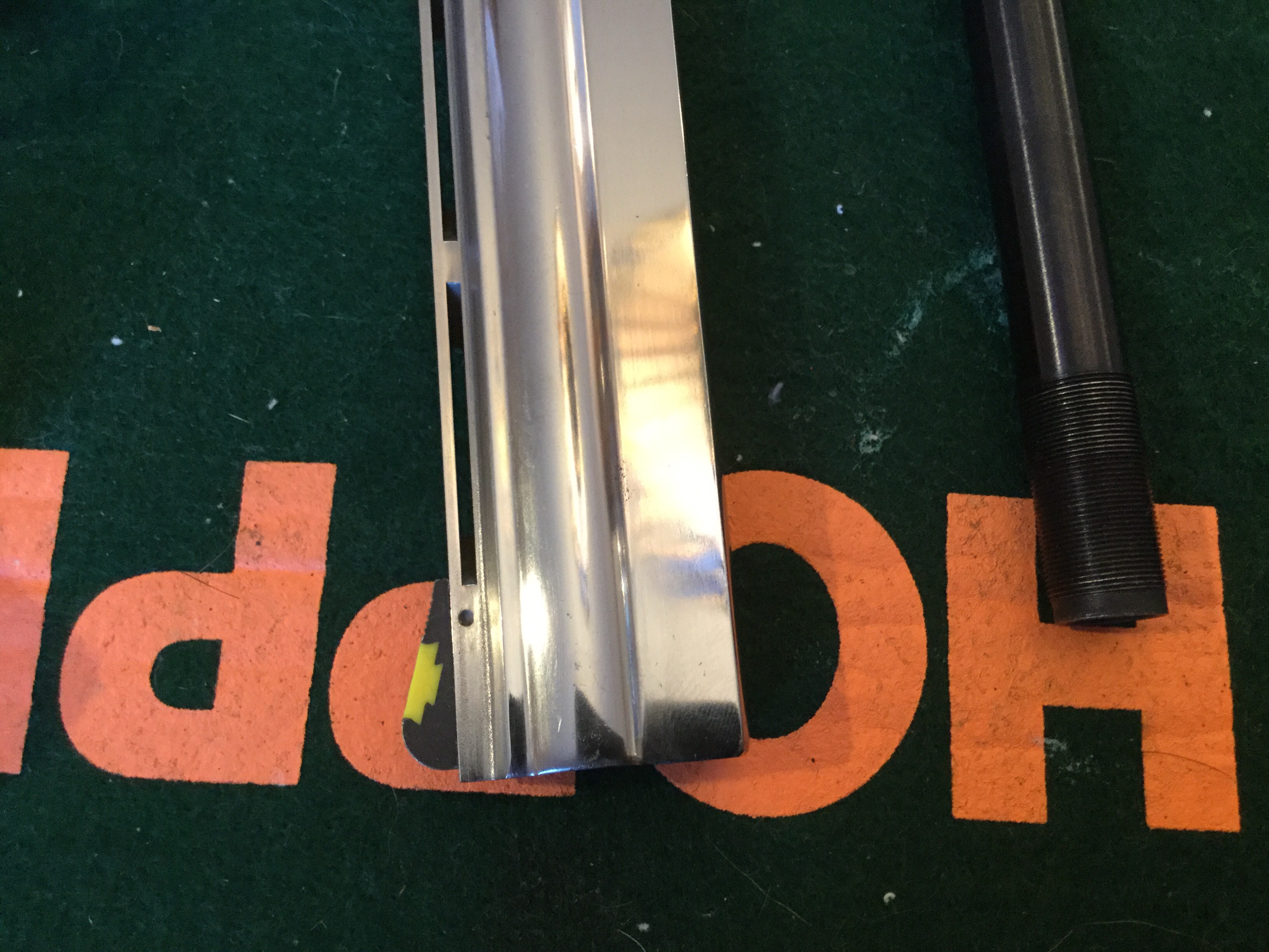

Ok. I tried cold blue on it.  As expected the inside of the sideplate took blue, as did the (frame) end of the  8" shroud.  The 6" shroud did not (and it has an "s" engraved in it.  I sent the seller an e-mail (I may have to send the pictures one at a time though because they are too big.  Ugh
Post the pics up here for us to see please !  poke

The one of the shroud in the beginning is one it took to show him the minor rust or something on the 8" shroud.  The ones at the end are the stainless 6"
57
January 15, 2017 - 11:22 am
Yep, that's carbon steel alright ... too bad, that polish job is exquisite !
