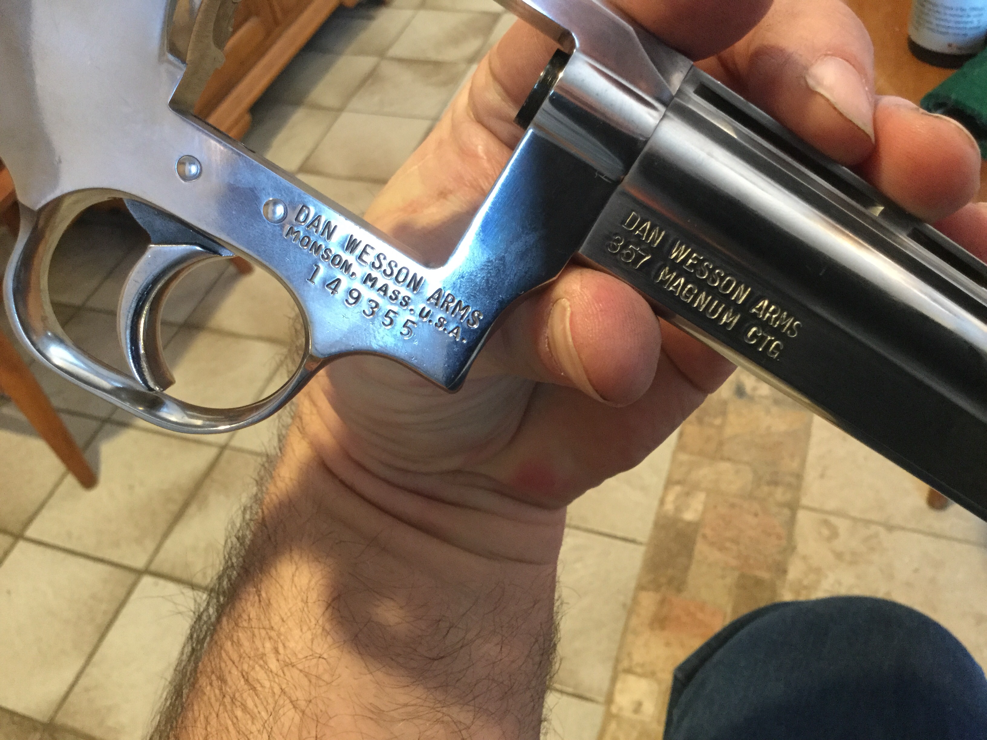

Well, I bought the silly thing.  ( before coming across this thread -yikes!). Yep, it's stainless.  And gorgeous on the outside.  Some small scratches.    Most of the internal are stainless, with the weird exception of the part of the hammer assembly that meets the trigger.  The side plate screws are blued but polished somehow or something on the heads.  The inside was desert dry, the hammer spring was rusted and stuck. After some love, some reduced power springs by wolf and the other ones by Erik and it purrs like a kitten.   I tried it out yesterday with the six inch barrel and it was more accurate than I am.  Of course, the finish is like a refrigerator and shows fingerprints.  Lol.

Stainless guns have stainless sideplate screws. Dan Wesson also never made stainless rear sights. If you can post pictures of the serial number, cylinder stop, frame mounted trigger stop screw, rear sight, and the top of the hammer spur we can discern if it is stainless or chrome.

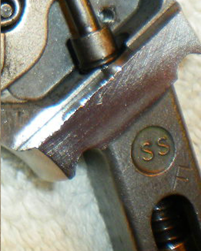

Just to add to this thread.
My Stainless Steel 714 DW Revolver (not high polish model) SN# S/00463X
2-inch-714.JPGImage Enlarger
Wondering if it's Stainless Steel or not? Take off the grip, and check the grip tang.
SS-800x600.JPGImage Enlarger
If it is a Stainless Steel gun and not a refinish, you'll see SS inside a circle there.
SS.JPGImage Enlarger
If a revolver has the SS in a circle mark, cast into the grip tang...
Then it's definitely Stainless Steel.
- Bullwolf

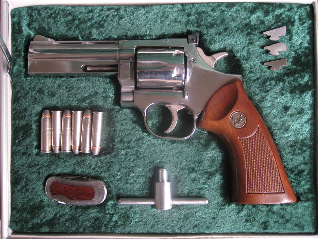

You and about a dozen other DW enthusiasts :)  Maybe some day it will go up for sale--I'm getting older, kids are in college, prices keep climbing...  here's some eye candy...

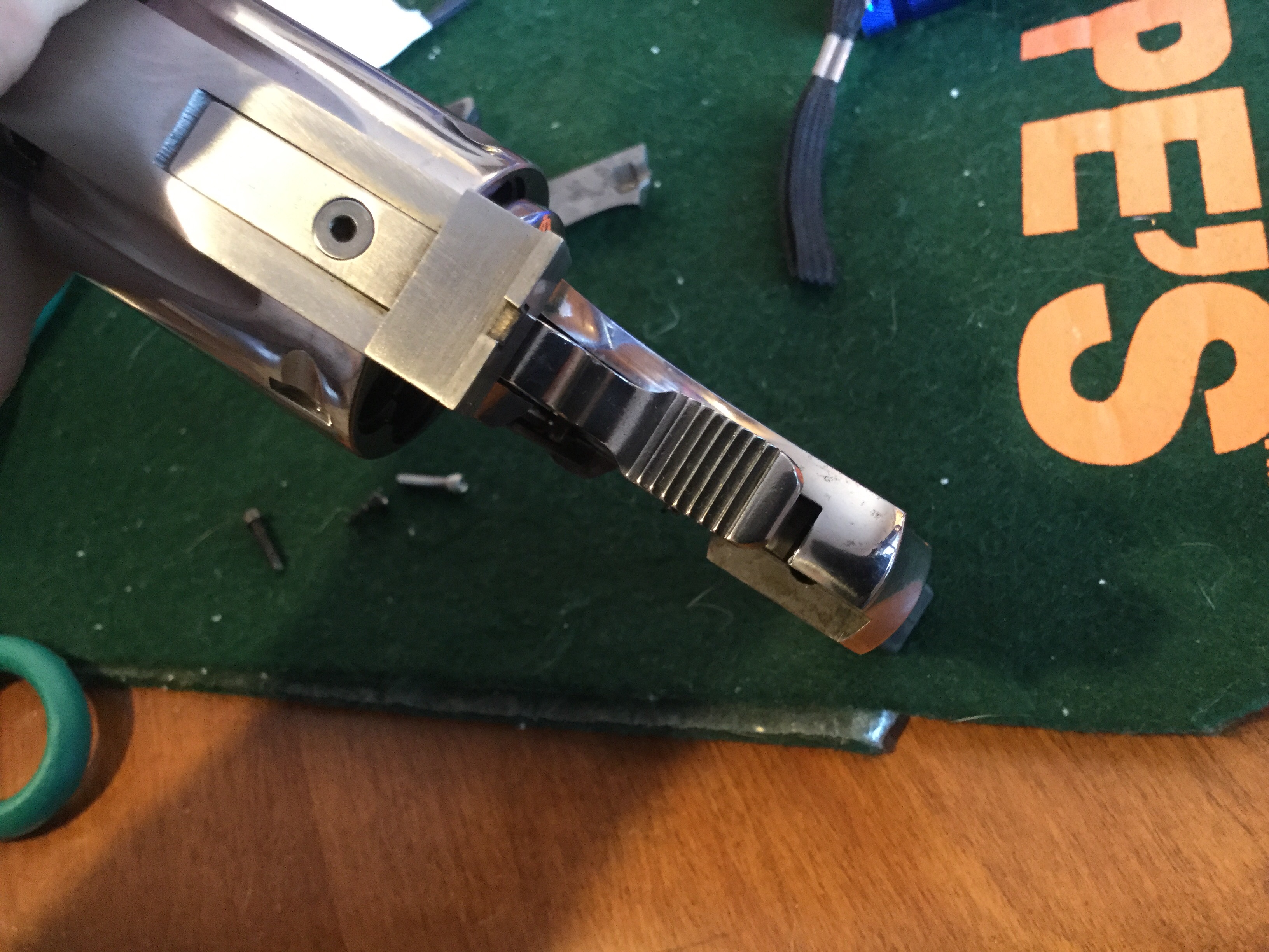

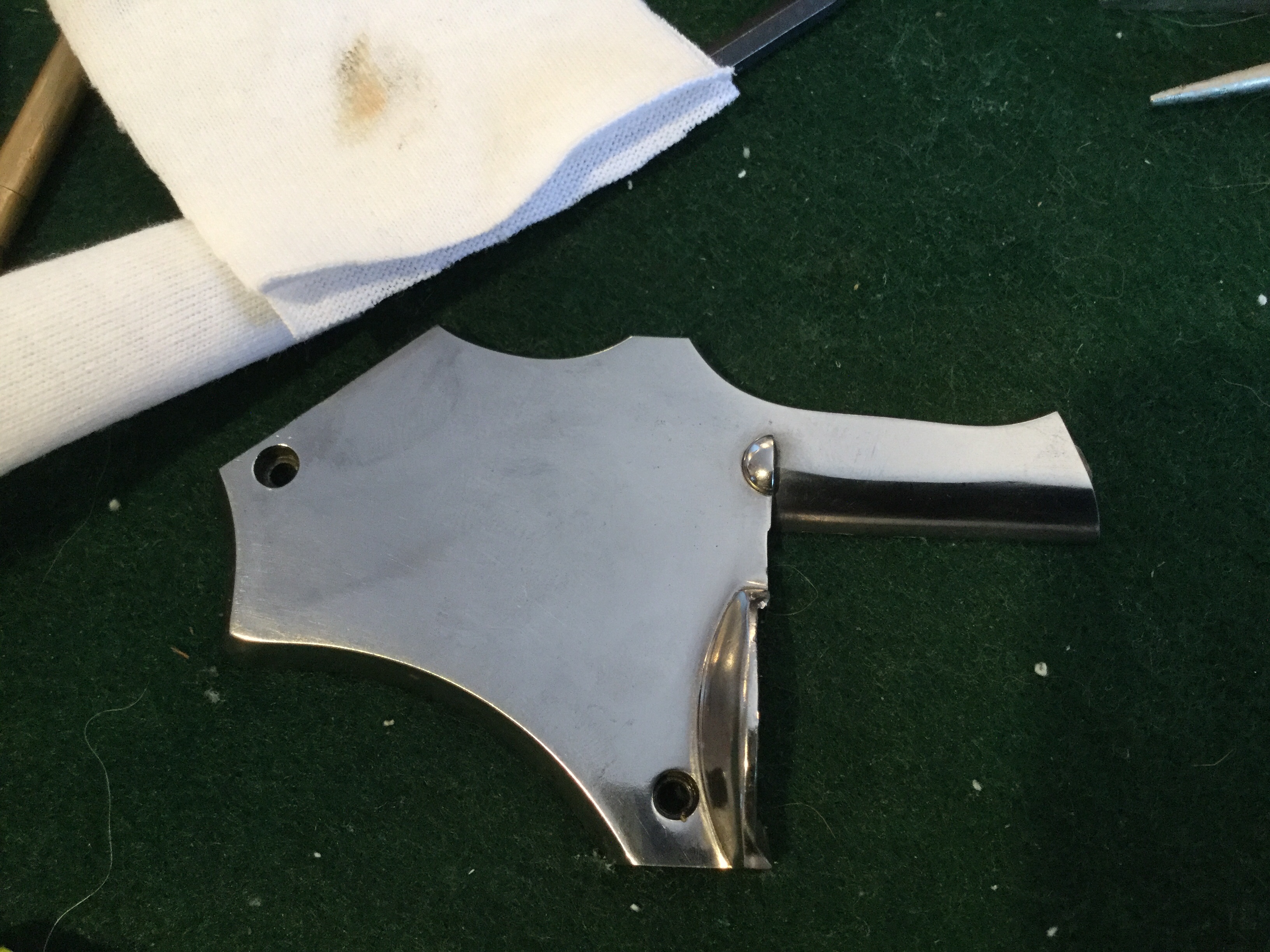

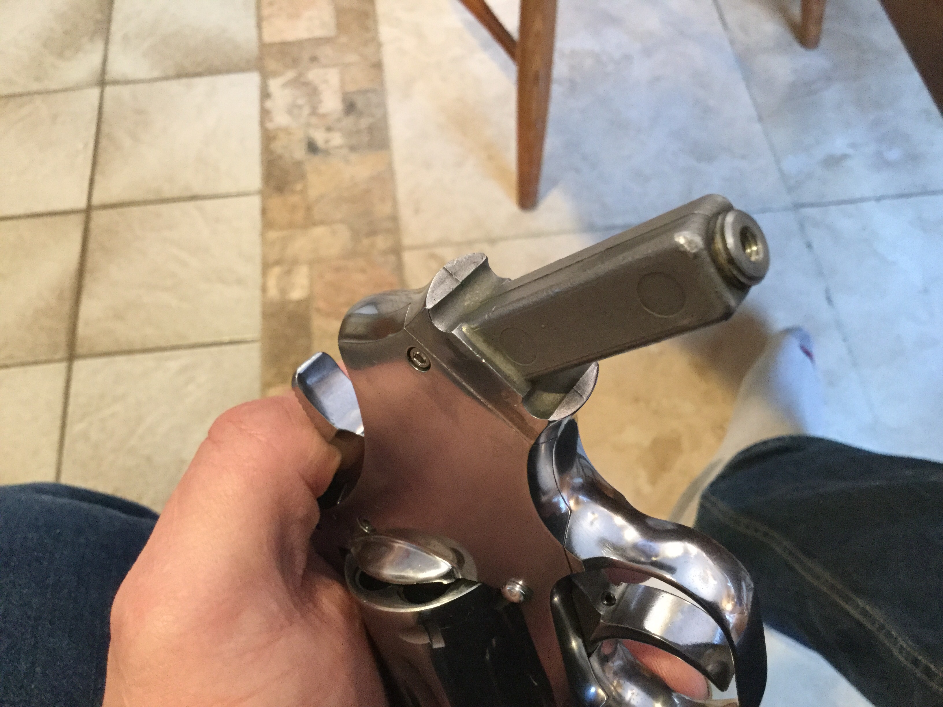

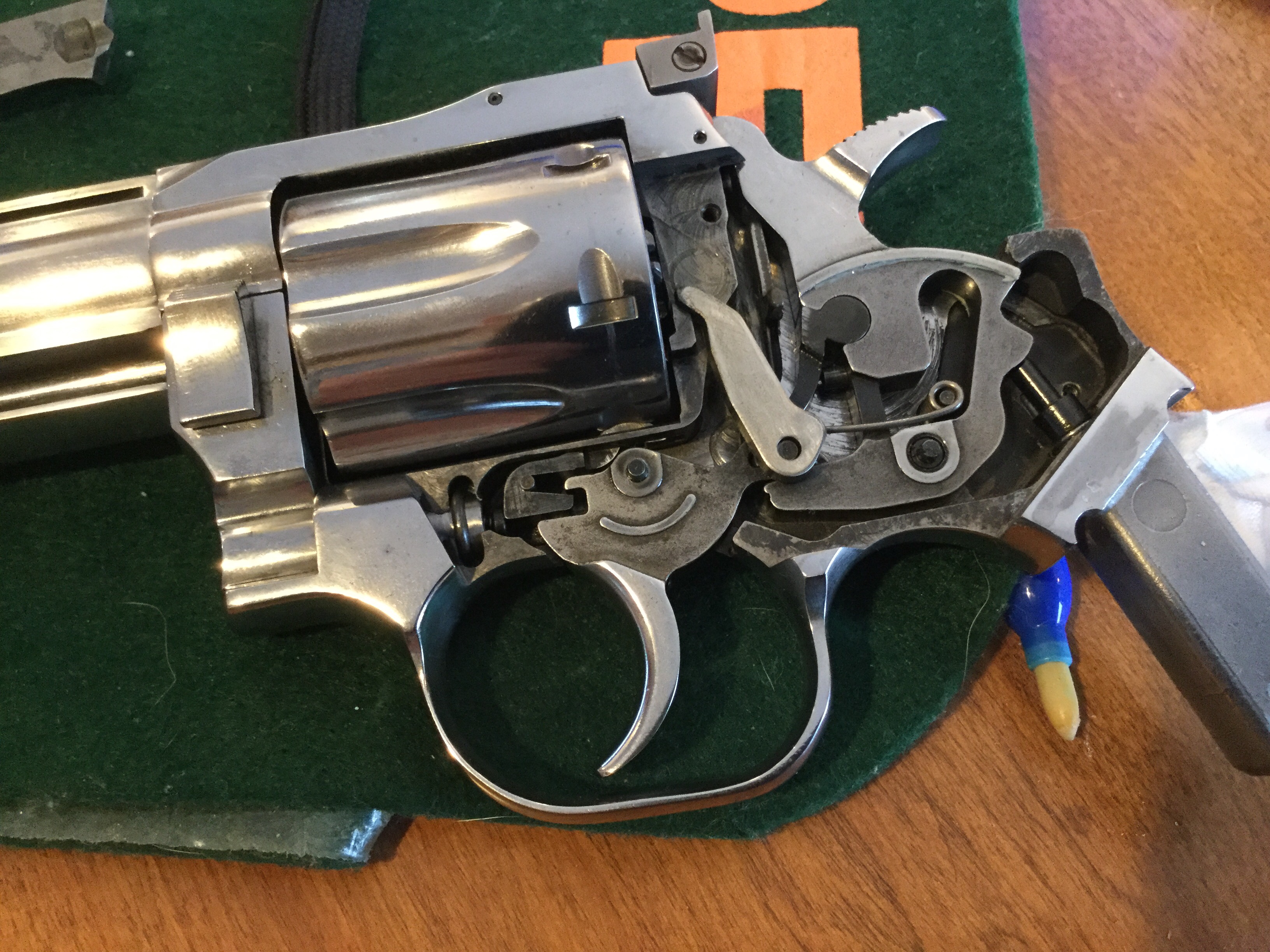

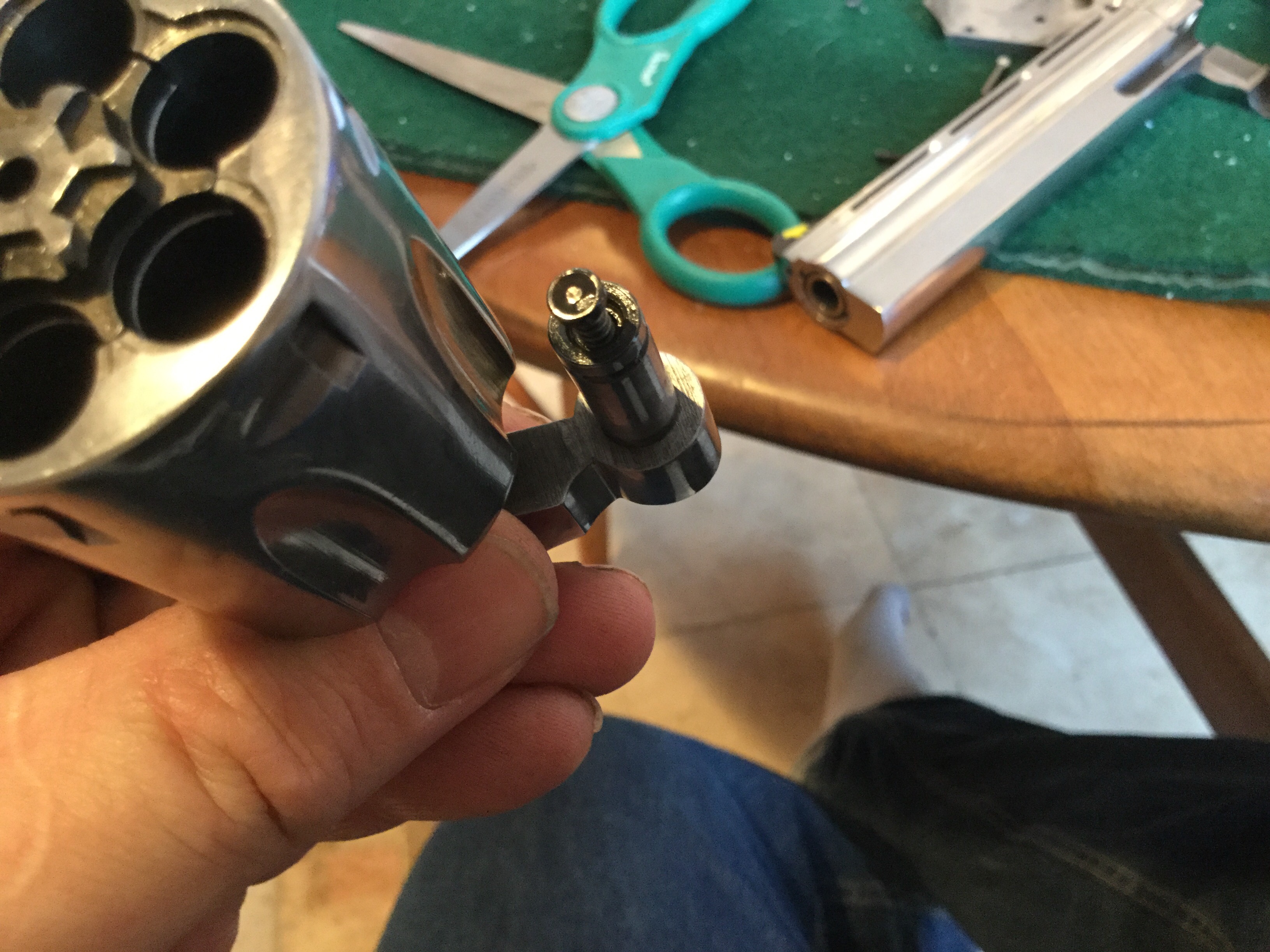

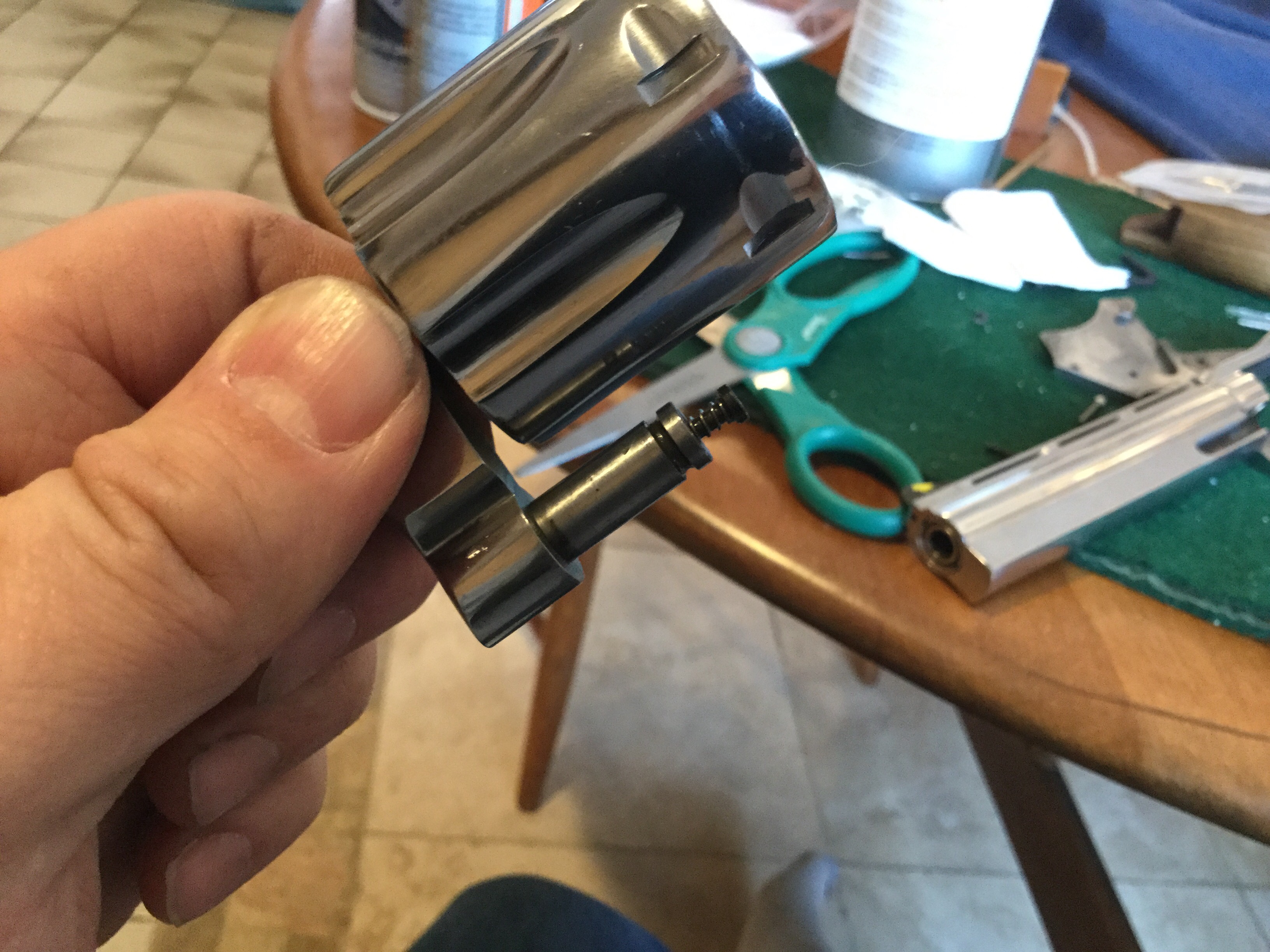

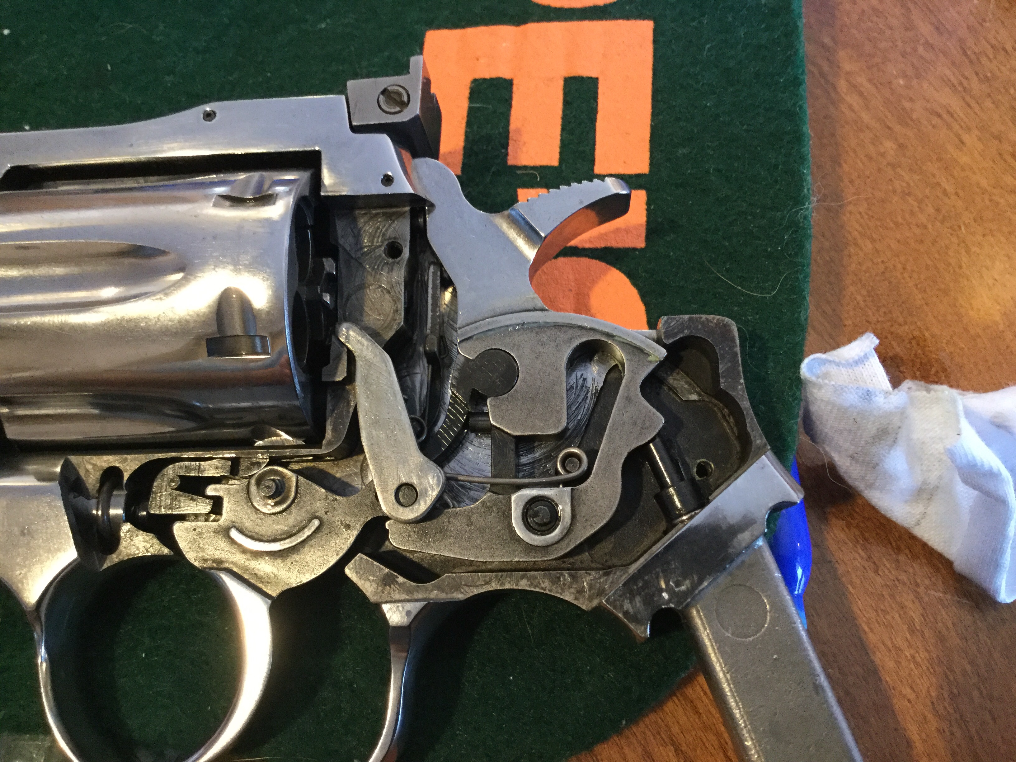

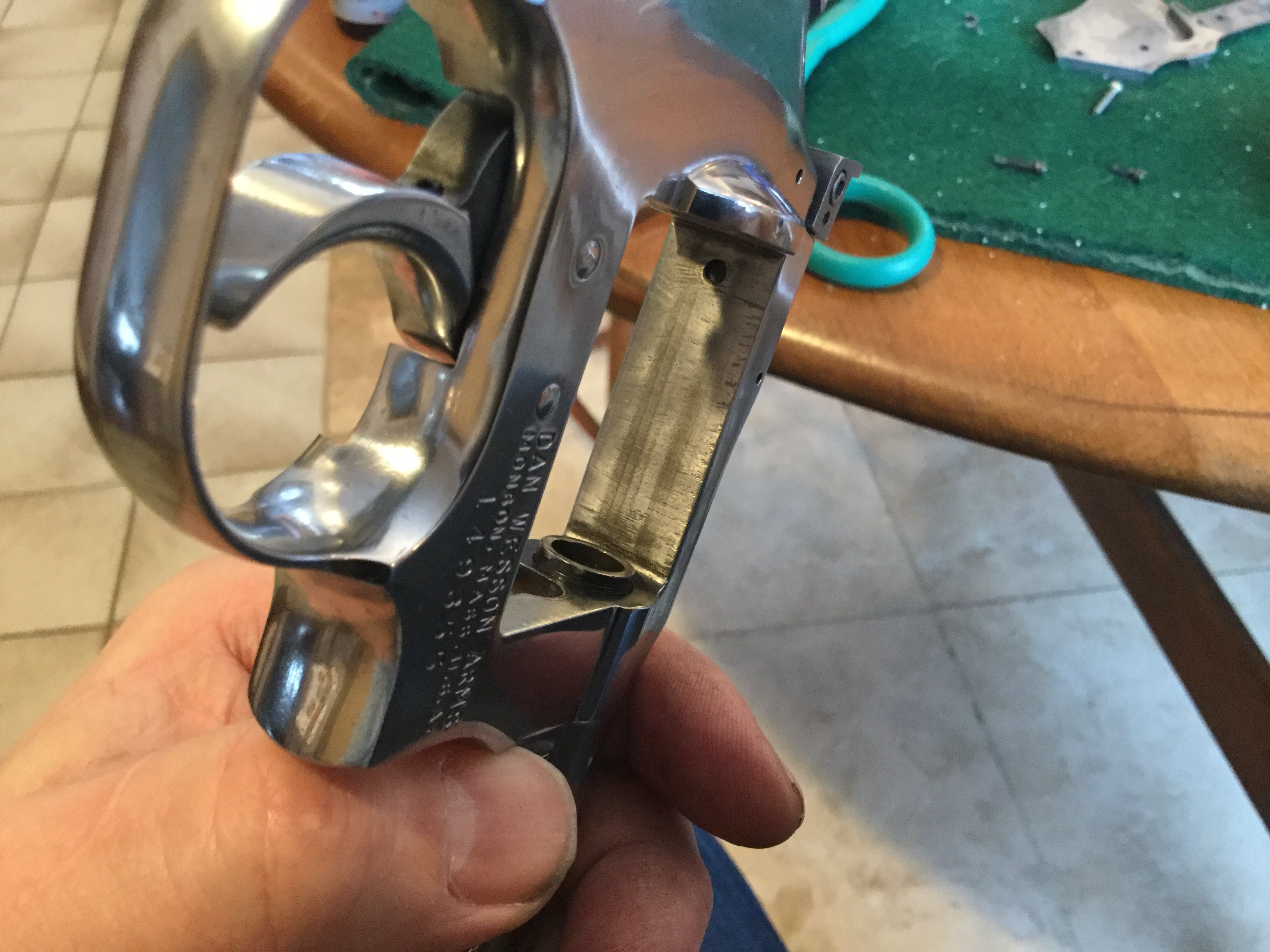

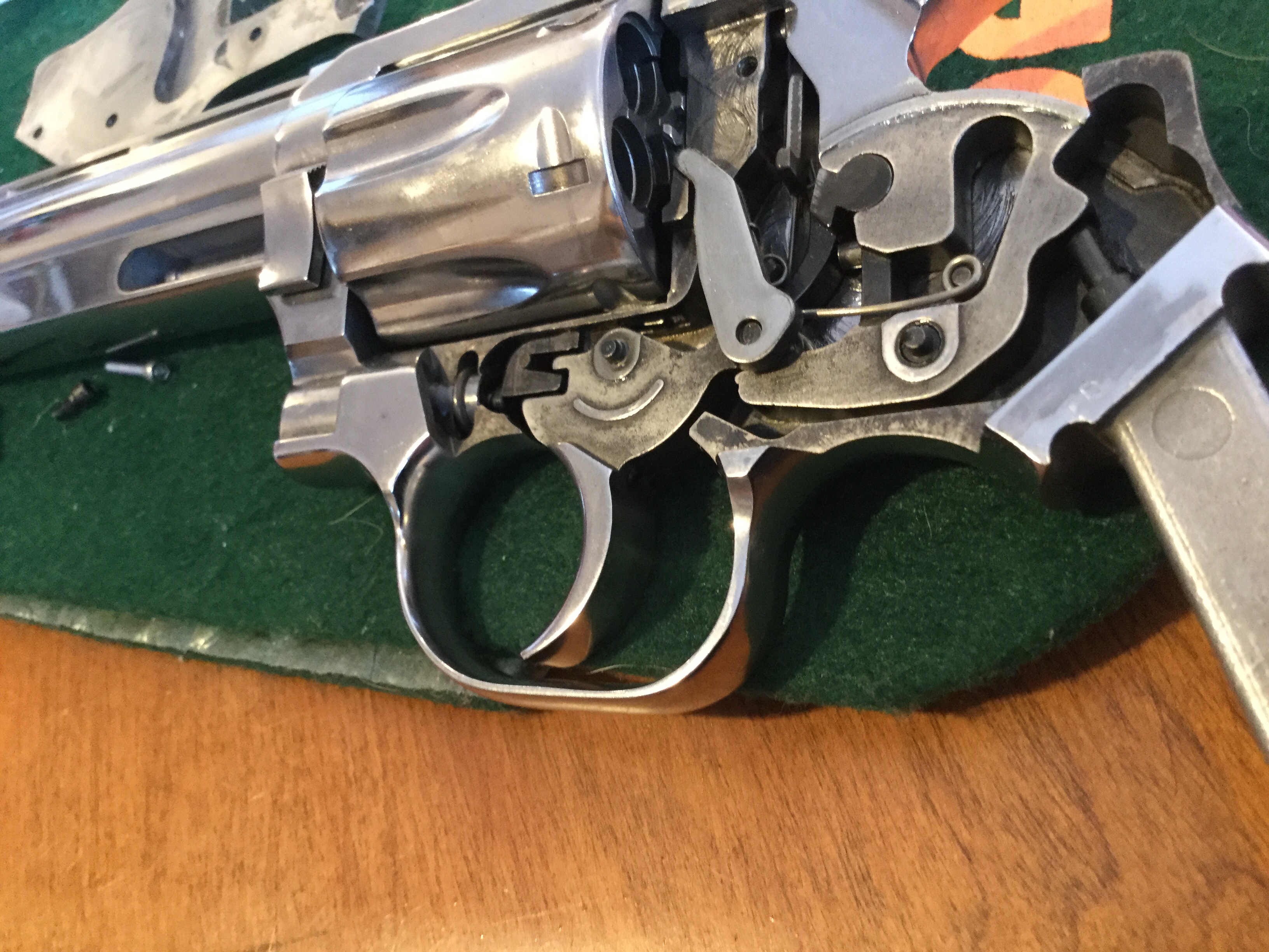

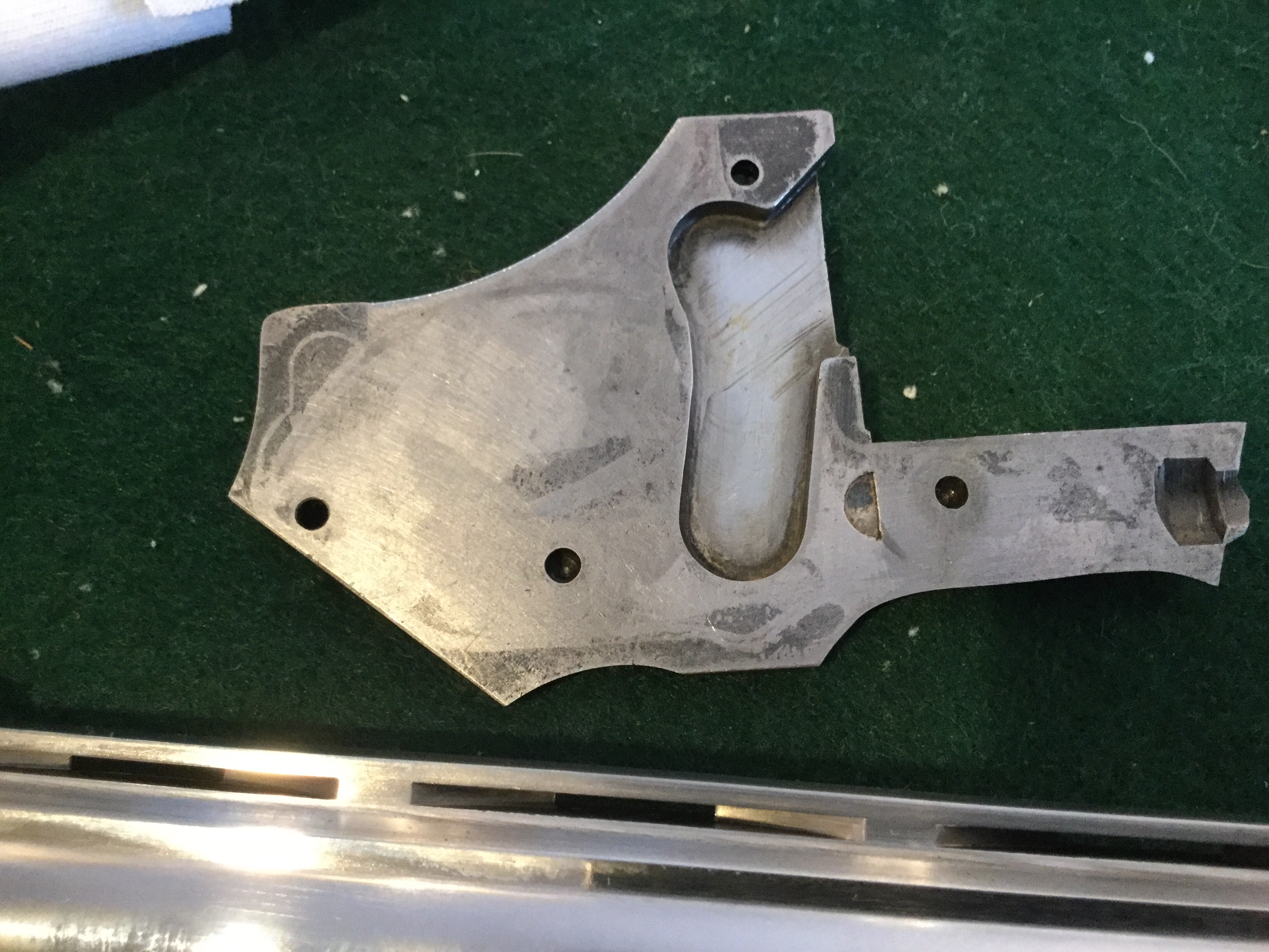

So here are the photos I took.  Apart from the part of the hammer nothing is blued.  The inside was really rough -like it was carved out of a block and I had to sand it w/1500 grit paper and then polish it to get it smoother.  It wasn't smooth chrome. And nothing flaked off when I worked on it. The recessed part of the of the barrel shrouds are't smooth either.  Either someone removed all of the blue and left the inside of the gun in the white (which given the rust on the hammer spring I don't think is possible because it would likely have rusted or something equally odd is going on.  Or it's stainless.  The outside of the shrouds etc have fine scratches in bright light. ????

BTW when I was polishing the inside of the side plate (with a dremmel because I'm an idiot) I slipped and the shaft hit the edge of the side plate (you can barely see it in the third picture). No chipping.
