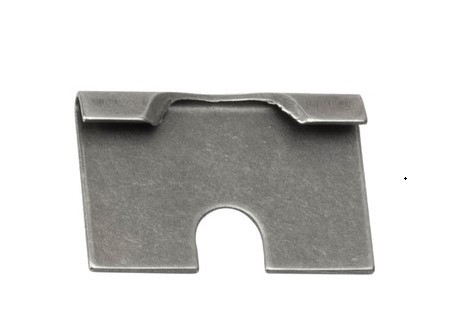

Try these links from midwest and numrichs.
N Frame shield
329 N frame shield

The ordered blast shields arrived.   The bend is too acute an angle.   There is too much space between barrel and Top strap.   Looking at the S&W top strap, it may have a lug that the piece snaps into.   It slides in with nothing to hold it.
I will ask my LGS.

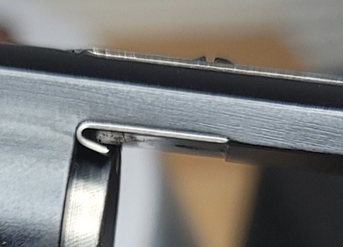

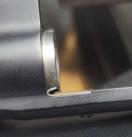

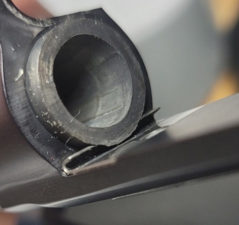

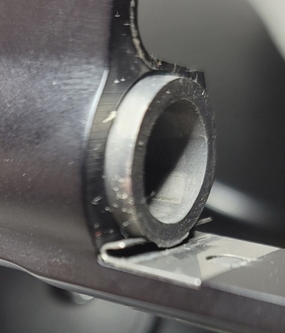

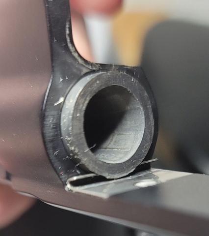

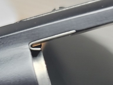

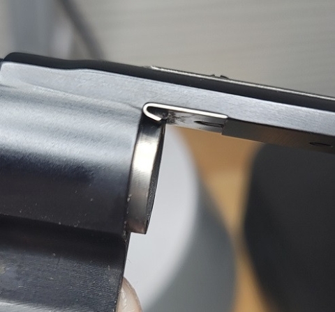

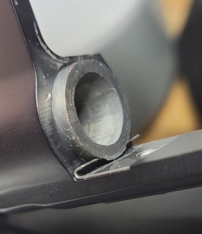

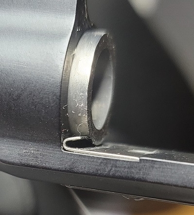

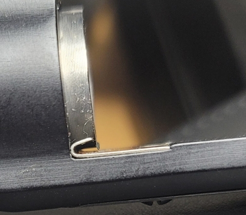

While you guys were messing around with this, I checked a couple of my S&W revolvers that have a blast shield.  Notably, the N-Frame 329PD .44 mag has a top strap "close" to the thickness of a .357SM (about .010 shy).  There's a little more engineering & design in these shields on a S&W revolver than appears at first sight.  I've attached a bunch of photo's here.  First, the frame is inletted to help hold it in place and keep if from sliding out toward the front of the gun.  You can see it in the photos.  Next is the stamping of the metal - you can see that the edges of those two tabs are cut at an angle like a knife blade.  When the shield is placed in the frame, and the barrel is screwed into the frame and depressing those two tabs, the tabs grip into the barrel and prevent the shield from moving sideways.  The shield is made of thin SS, and I assume it is hardened and has some "spring" to it.  The tension on the barrel keep it in place and the tabs prevent from moving sideways, the inlet on the frame keep it from blasting out forward toward the muzzle.  There is also a U notch cut in to the shield to accommodate the sight screw, and it appears that the sight screw extends just a single thread below the top strap but also helps keep it in place.
All these features enable S&W to use this shield, but they are designed into the gun.  They're lacking on a DW revolver, and merely jamming one of those shields into the space between the barrel and the top strap won't hold it in place....it will blast out of the frame on the first round and I hope the shooter is wearing glasses!
I hope this adds some info. for your guys working on it.  I'd like to see it work on a DW Revolver, but I'm stuck on finding an idea to hold it SAFELY in place.
Very good, clear pics that show the points you raised. Thanks for your contribution to this discussion.
Thanks for the very detailed photos, DJ. occasion The only caveat to S&W adding the blast shield to the model 329PD, is that the frame of that gun is aluminum! I mean seriously, if they didn't come up with the ingenuous blast shield idea, there is no way that gun would have passed testing through a hard/long fire test. The top strap would have melted! wow
