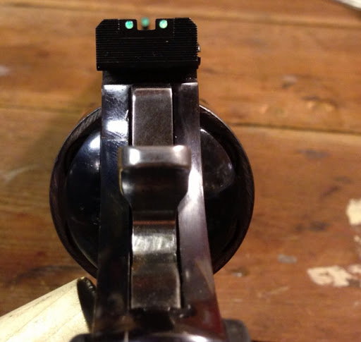

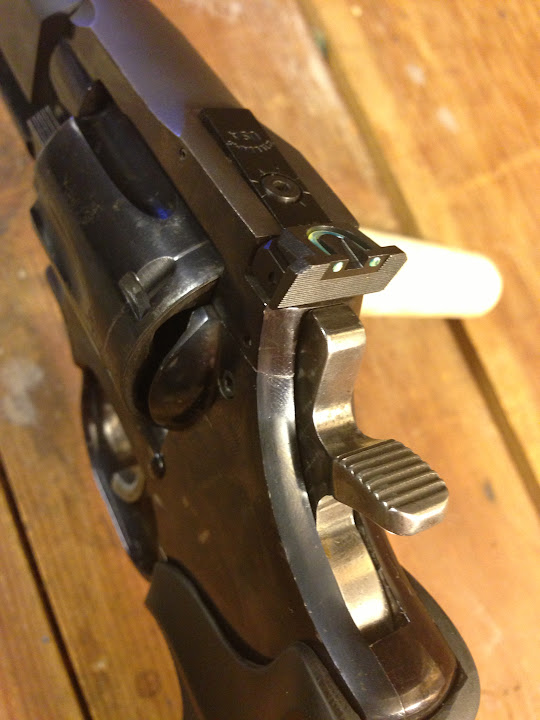

Here is my 15-2 race gun. Jeweled trigger, hammer, and insides, along with an EWK EH 6" barrel and a muzzle break.  I installed the Pachmayr 'gripper' that came with another 15-2 that I bought recently.
I'm editing this post to add some additional pictures...as it turns out I was in something of a Nyquil induced haze when I was attempting to post the pictures yesterday.  Thanks to SMKYTXN for the assist yesterday (below)...here's some NEW pictures for your trouble

Maybe not...I guess it's a little tricky to add an image to a post on this site with an iPad

June 10, 2013 - 10:21 pm
https://picasaweb.google.com/chris.schuerger/General#588803659709702709
Here yah go. That looks like a fun toy. Thanks for the cool-pics
IMAGE_18.jpegImage Enlarger
IMAGE_17.jpegImage Enlarger
