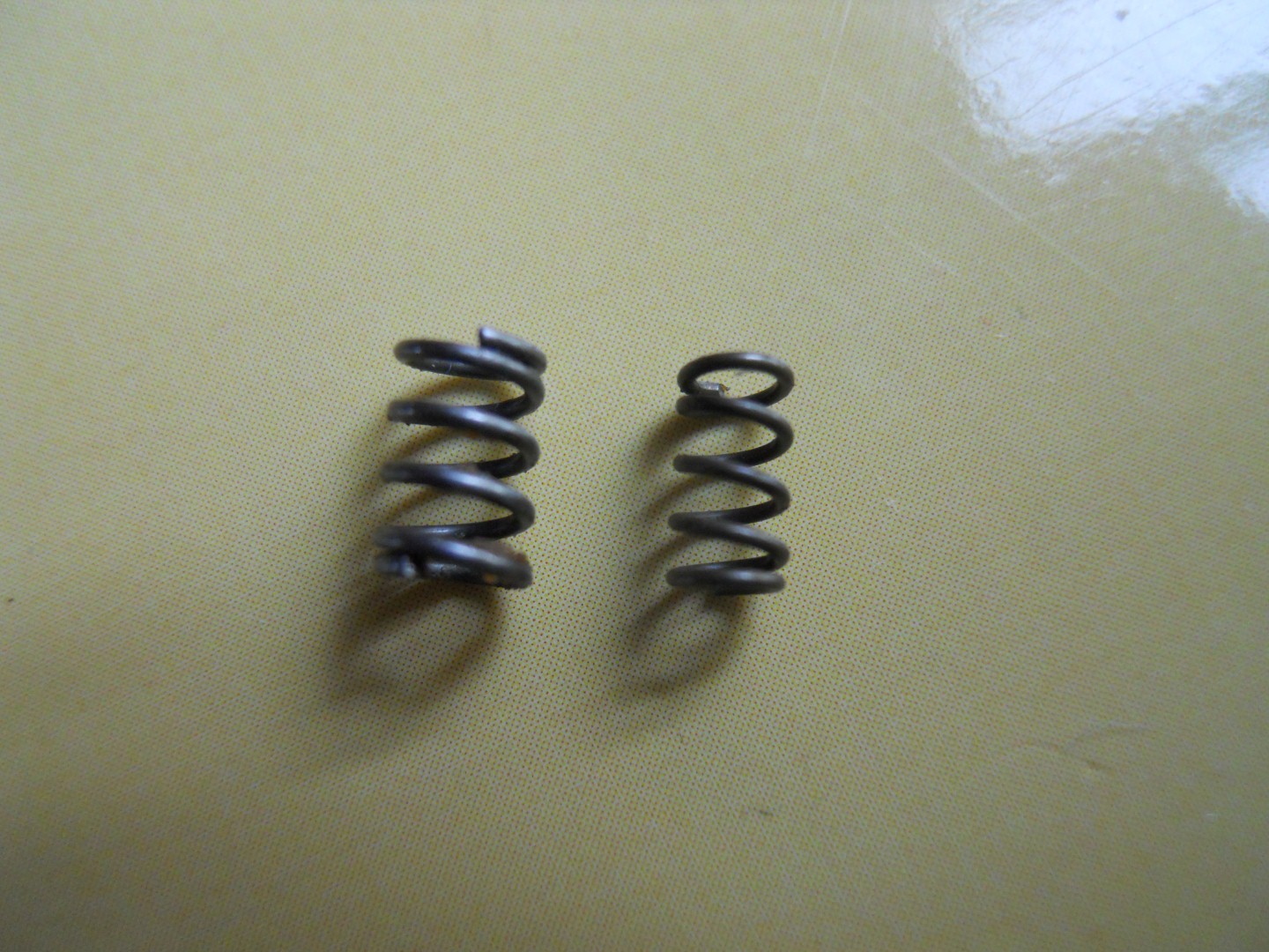

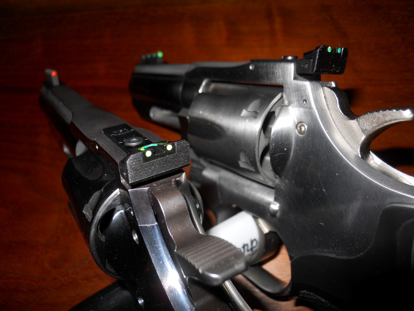

I bought 2 sets of the Fire Sights for Rugers, installed them this week after seeing one one Smkymtn's 715. I did run into one small issue. On my Palmer 715, the springs are larger diameter and would not fit the Ruger sight. The Ruger springs measure about .117" diameter, but the Palmer springs are .150" diameter. So I ordered 2 Ruger replacement springs from Midway and they worked fine. On my Monson 15-2, the springs were the smaller diameter and worked fine with the new Fire sight. I have EWK FO front sights on both revolvers.
   I shot the 15-2 at the range, I really like these sights, especially at shorter ranges they will be great on any Dan you use for defensive purposes or a nightstand gun etc. Fun for target shooting too, they are really nice and bright outdoors.
   Williams # for the sight is 70958, the MidwayUSA # for the springs is 423309.

Nice- Looks like a great low-light hunting setup too.
April 28, 2013 - 7:33 pm
looks like a great combo!  I may just have to give setup a try, Old eyes like bright sights!

I'm glad you liked them. I just got in my second rear sight form my 715-22. For the money it's a great product. Enjoy!
All of my Dan's are Monson's so I haven't run into the spring issue. I'm sure your info will help others.
