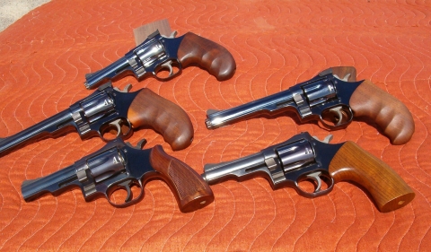

Oh for sure, so am I!  I should have expounded on that thought a bit. But I guess I didn't want my lengthy post to turn into an actual novel. lol2 So when I first joined the dwf in '09, the one saying I heard so often was that the D11's & W12's wearing their exposed barrel nuts were considered "ugly nuts". Kind of saying it's "a face only a mother could love". That was my own phrase for those guns back then on this forum, based on the view of most people unfamiliar with the early DW's. But after joining here, it was less than a year until I found my first fantastic deal on the guns that started it all. In fact I was so excited that I bought about half the DW's that seller had on GB that week. He gave me a great combination deal.
So yes, I too am very fond of the exterior nuts.
Here is the result of that 1st "ugly nut" buy. cool
