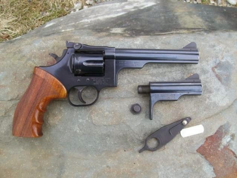

This is a normal Model 15.
B139354B-09A5-4F81-B1C4-24B602873E5B.jpegImage Enlarger

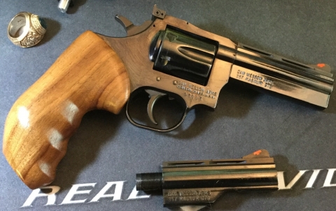

This is the more common Model 15-2.
24748855-318E-4B94-AFA9-5550307CF5FA.jpegImage Enlarger

This is what I have.
Dan Wesson Model 15 in 357 Mag-img-0
Keydet92
Forum Posts: 30
March 6, 2017
September 29, 2020 - 1:21 am
That’s a Model 15-2.  The EWK conversion sights will let you put 15-2 barrel shrouds onto Model 14-2 frames but not the other way around.
