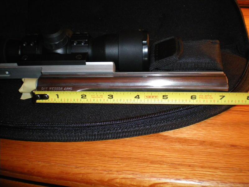

Took some measurements of my 8 inch Monson scoped 357 shroud. Pardon my low quality pics.
The barrel tube is exactly 8 inches long, from forcing cone to muzzle threads

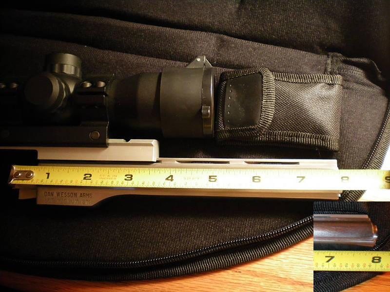

Barrel shroud is 7¼ inches long

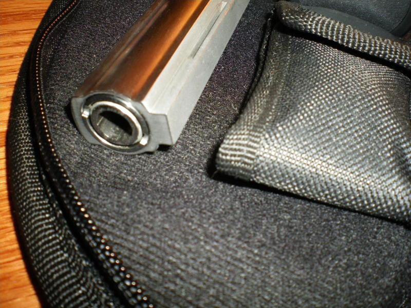

Front muzzle view, no front sight provision. Top & front face of shroud have a bead blasted finish.
