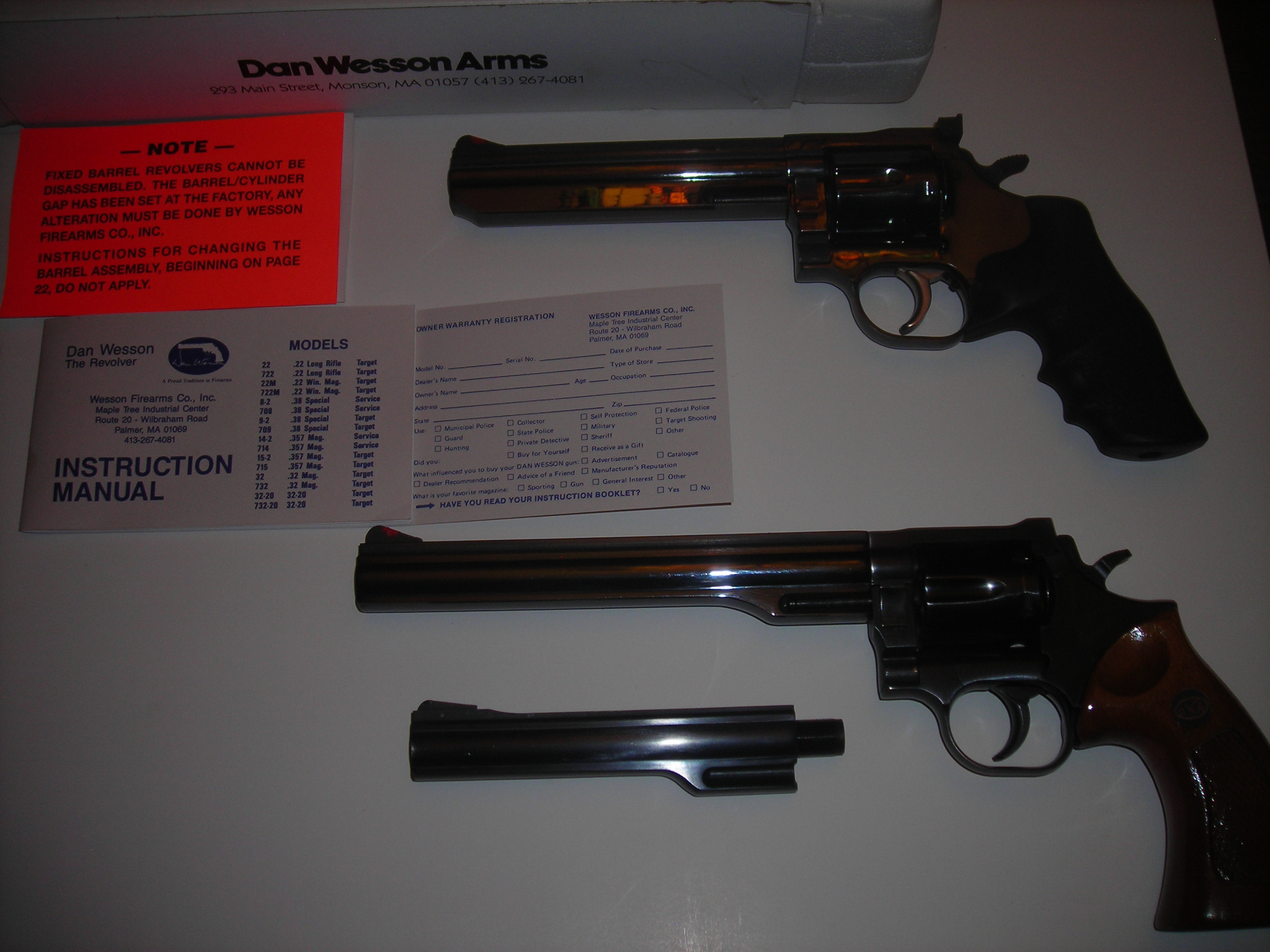

Hey guys, I found an awesome deal today on a 6" VH 715 barrel! It looks awesome on my 714! However, as I'm sure you know, the front sights are different. I saw a front sight conversion in EWK Arms site, but it's no longer in stock. Does anyone know where I can find one? Or do you have any other suggestions?  Thanks, CJ

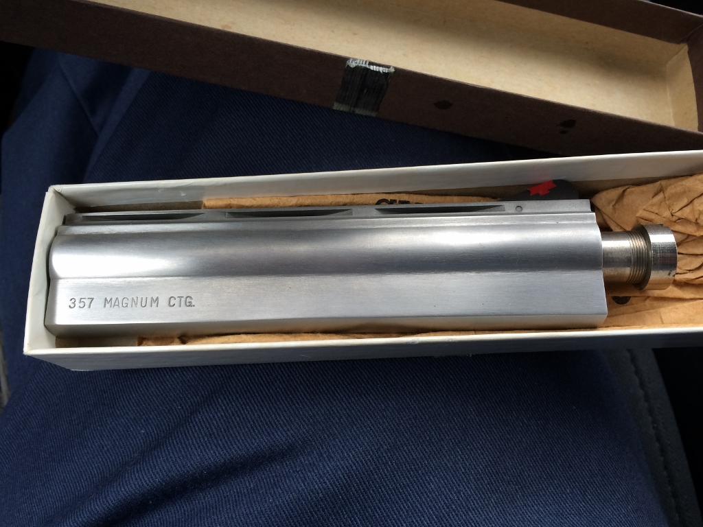

Yes it does have a "hump", hence problem ? I may put a scope on it anyhow.palmer-002.JPGImage Enlarger

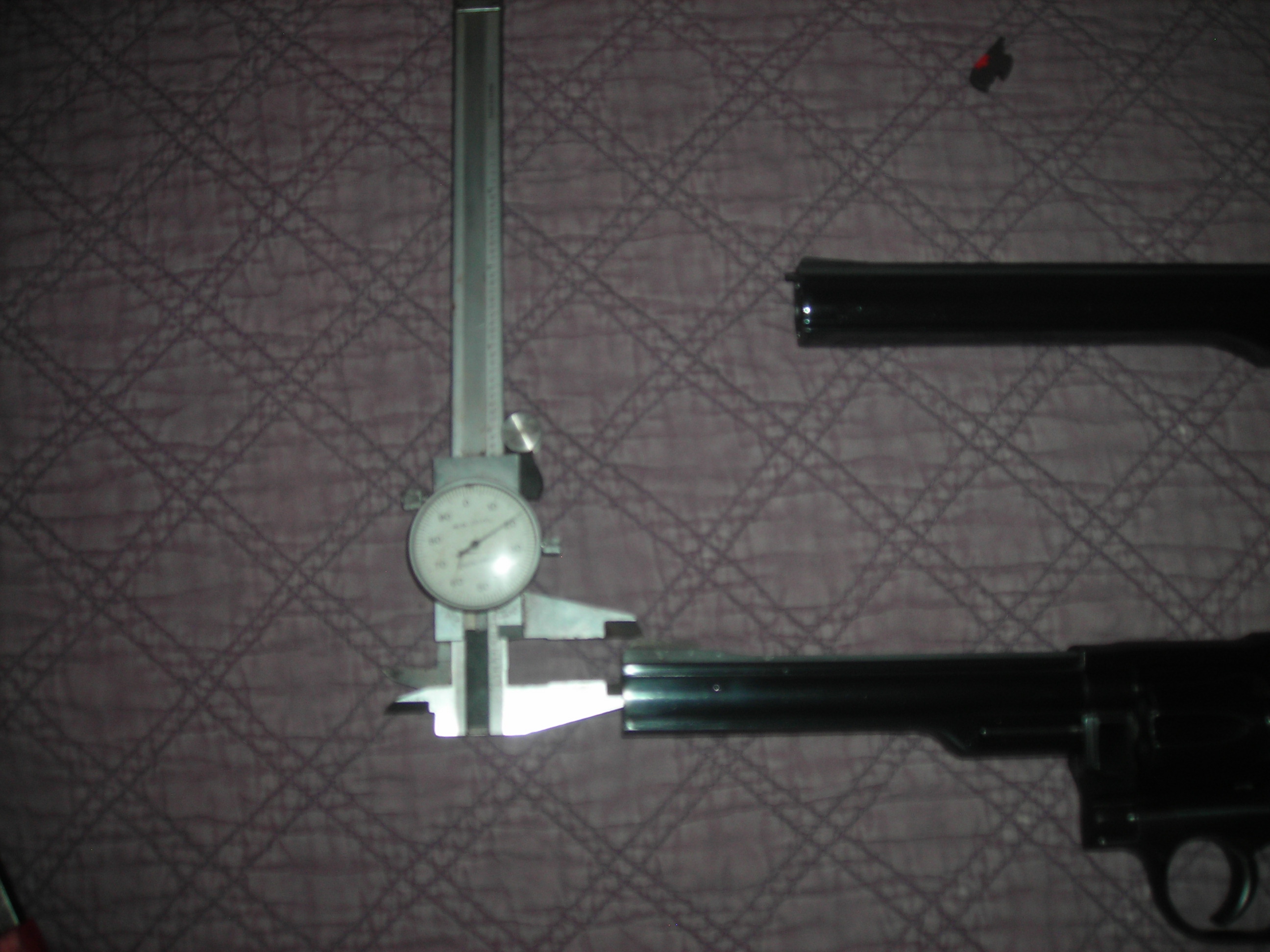

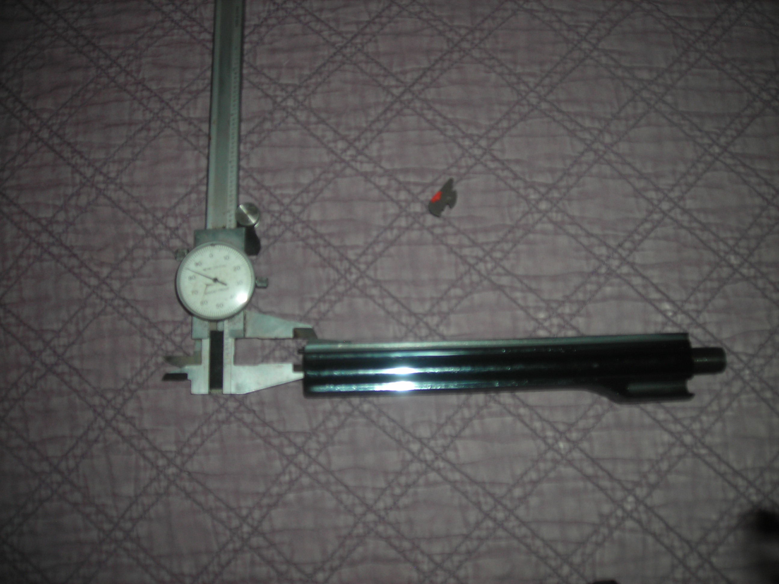

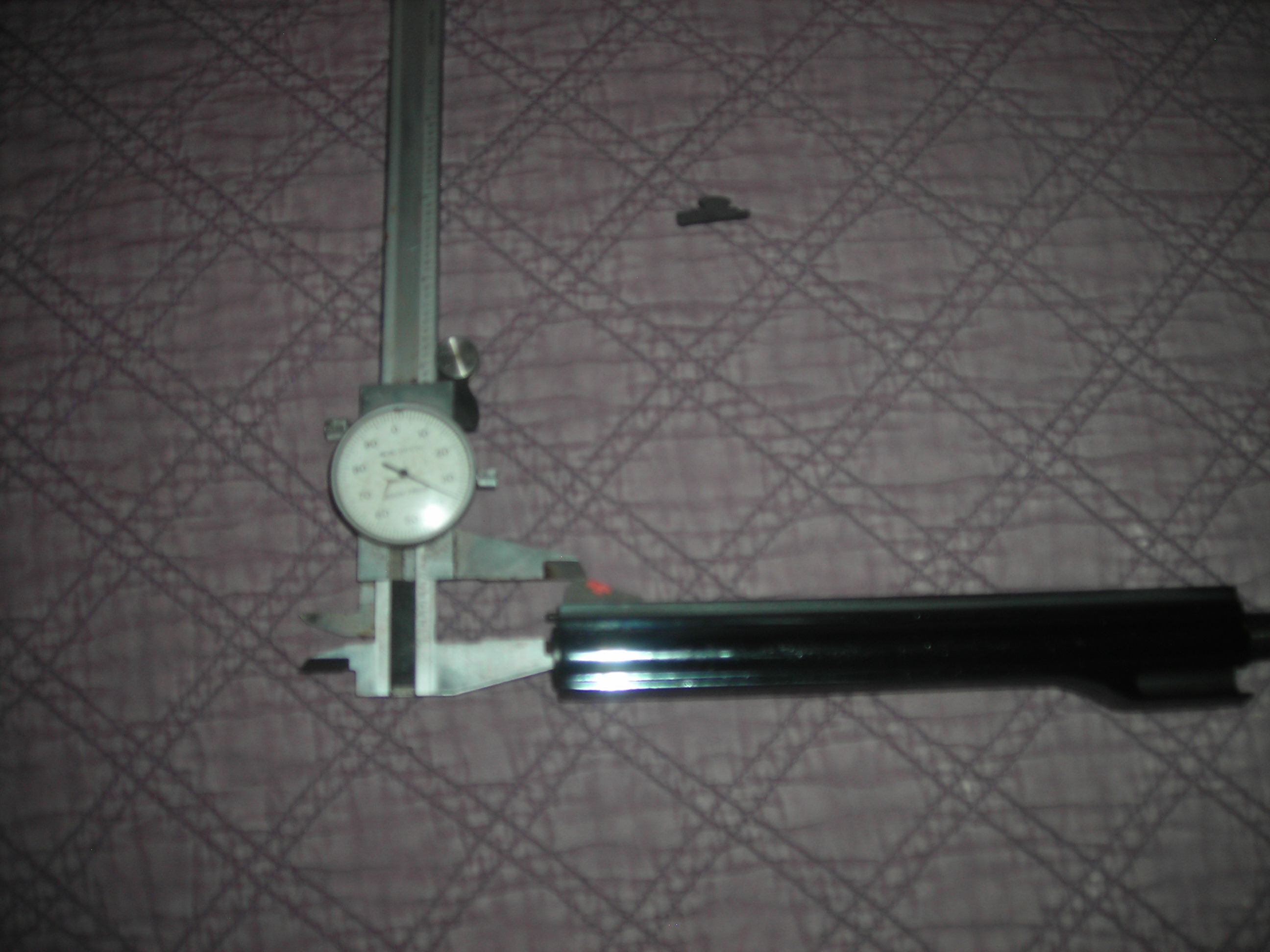

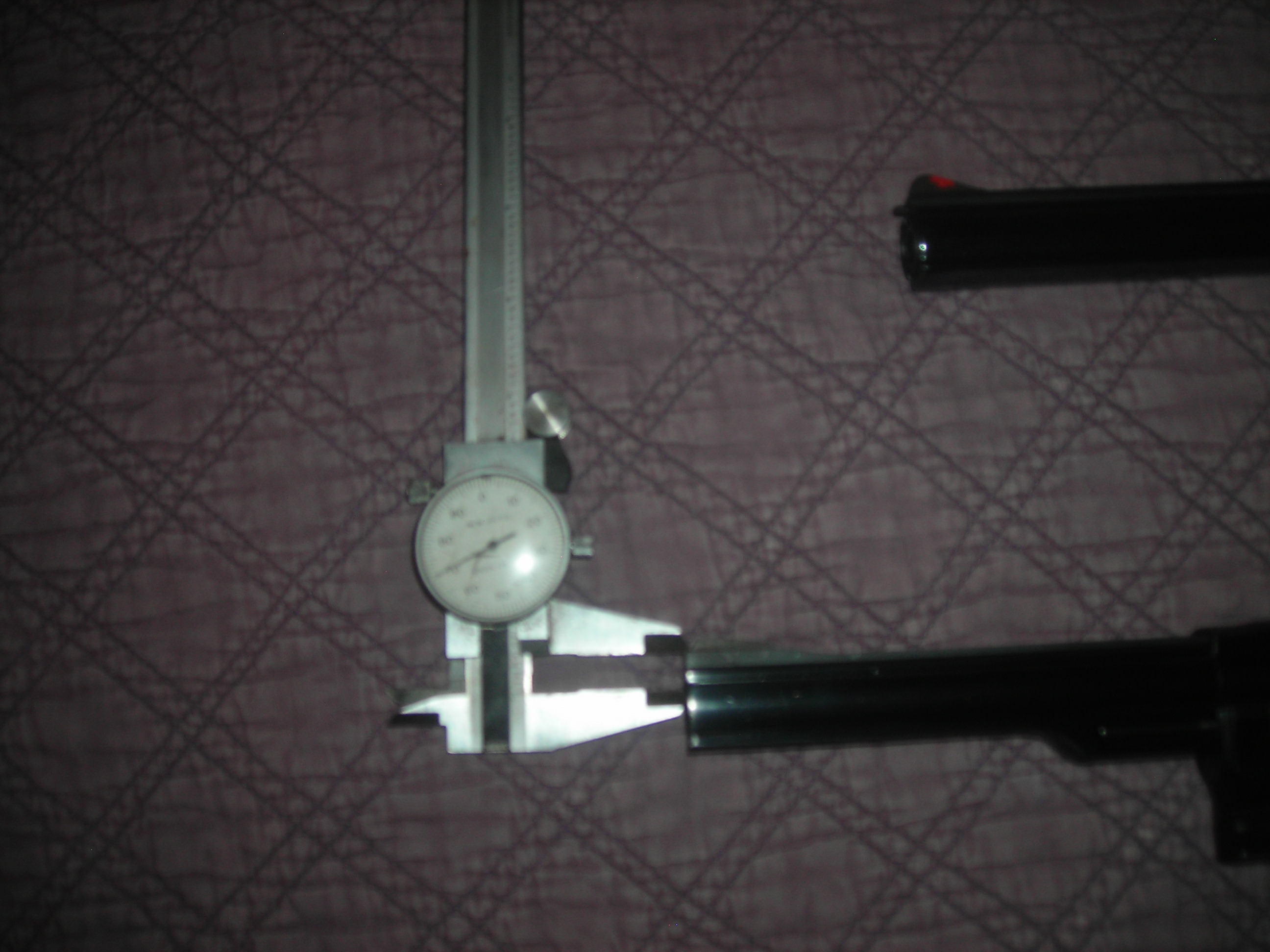

 Ok, Eric
got some pics. and measurements
14= inside top of ba to top of sight= .520
      inside ba to top of shroud= .370"
15= inside ba to top of shroud= .345  .025 difference
      inside ba to top of 14 sight= .485   difference .035
    to top of 15 sight .635
 add in 8" barrel and .035 is amplified. I hope info. helps. BTW, dead on w/original 6"big-grin14-15-specs-001.JPGImage Enlarger
