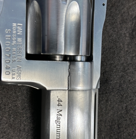

I took my two Dans (715, 744) to the range today.  When I got home and started cleaning, I noticed that the frame of my 744 has cracked!  It wasn't like that prior to today's range session.  I only fired 75 rounds - 25 magnums and 50 specials.  Any idea what might have caused this? Barrel nut was snug but not overly tightened. Obviously I'm bummed out.

March 17, 2025 - 5:16 pm
That sucks.
How tight was the barrel in the frame?
It almost looks like the frame was wedged and split.
It's possible it was a bad casting from the start and just finally split.
I'd be curious what the OD of the barrel threads is since that's not the original barrel assembly.

The OD of the barrel threads measure .683" vs. .682" for the original barrel with my cheap digital calipers.  The barrel was not difficult to screw into the frame - did not require any significant effort.  Barrel nut was hand-tight but not overly torqued. B/C gap was set at .006"
Those dimensions are fine.  Sounds like a flaw in the frame metal, maybe an inclusion in the casting.  Maybe it just took time to happen.

I'm relieved that it just cracked and did not do a "rapid unplanned disassembly" - I probably got lucky.  I didn't notice anything wrong while shooting - it was as accurate as ever.  It was only when I got home and started cleaning that I saw the crack.

Did your barrel split like mine?
https://www.danwessonforum.com/forum/revolvers/my-monson-715-barrel-and-frame-split-f/
That happened to my 715. Read the thread. Long story short I had a newer CZ/DW barrel that was not heat treated according to Bob at DW. Looks like it’s a newer CZ shroud you have. CZ barrel too?

It is a relatively new CZ barrel & shroud.  The barrel is fine - no split nor any apparent bulge.  Only damage is the frame.

Not anywhere near my Wheelhouse...but, wondering aloud, if Not properly Heat treated??? Just how "elastic" that Barrel would be???
Wondering If it maybe could Grow, and Shrink enough to damage another Relatively Hard and Non elastic Frame???

It would take someone with a lot more metallurgical knowledge than I have to determine whether that could be a possibility and if so, whether there would be any evidence on the barrel after the fact.
I'd love to find something to blame this on but right now it looks like probably a flaw in the casting that finally gave way after 40 years.

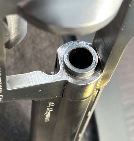

It might be possible to restore that frame. Nickel silver brazing rod will work on stainless, and has a tensile strength of 85,000 psi.
the stuff is hell for stout, and when fluxed, flows like silver solder. i have used it for knife and Black Powder gun work for many years with great succes. I am actually trying to find a source of ingots so I can contract a local foundry to cast some replica “pre 1875” era frames.
oh and it is a great braze for jewelry works, has a lovely sheen.
no harm trying, and you could at least run 44 specials for the next century.
Bernzomatic-NS3-Nickel-Silver-Brazing-Welding rod.

Beancounter81 saidIMG_2065.JPGImage Enlarger
I don't know .. looking at that pic of the frame barrel threads, that's going to be a difficult solder job (not just a fill it in).
Don't have anything to lose though.
March 24, 2025 - 6:44 pm
You may need a tap to clean up the threads when finished.
