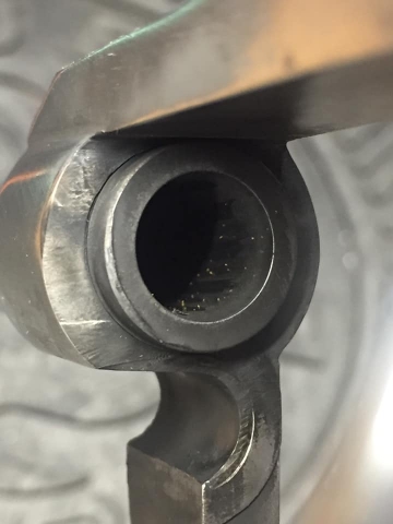

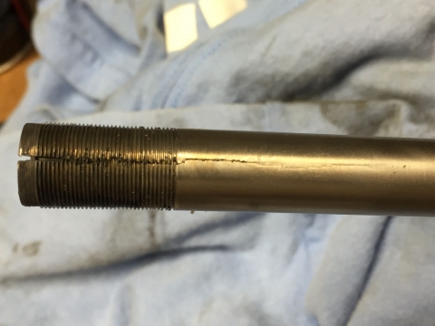

Well my Monson, MA DW 715 is completely toast. The barrel split which unfortunately split the frame😭
I am beyond pissed at myself (because I had considered replacing the barrel since the throat was eroded only after 1500ish rounds - purchased new in July 2019) and at DW. I had been in contact with Bob at DW expressing my concerns with the barrel throat getting eroded and he said:
“Andrew, This seems to be the new normal on barrel wear, I have been told it’s because of the recycling of the steel. I don’t know, I’ve seen barrels with thousands of rounds through them with no wear and then some with hundreds of rounds with wear. Heavy hunting loads and hand loads will cause erosion but I have seen this with target loads also. I have been told they are safe to shoot and will last, they just don’t look like the will . I realize I haven’t answered your question but that’s the best I have at this time. Keep me posted on how it performs and if it gets any worse.”
So because of their shitty QC on the steel I’m out a $800+ gun that is next to impossible to get in this communist state (MA).
Not to sound entitled but the amount of money I’ve given DW on custom shrouds and action work, I feel like I should get a discount on one of their new 715’s and/or at no cost.
So pissed.
I had also been in contact with a fellow forum member who is having the same issues with the erosion and purchased a barrel the same time I did (2019) and he also said that his first Dan Wesson revolver blew up because the barrel wasn’t heat treated. I’ve got a couple emails to him asking what Dan Wesson did to resolve that but haven’t heard back yet.
DW-1.jpgImage Enlarger

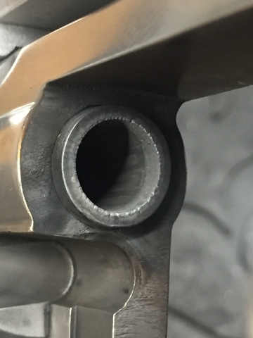

Heres my 44 magnum 10 inch barrel purchased from DW in February 2019. 0 erosion. Same round count.
DW-44-barrel.jpgImage Enlarger
715:
BA3D3A95-1E67-4DF5-B847-F001B9CA30CB.jpegImage Enlarger

Wow, this seems to be uncharted territory for DW. I’ve never seen this before, but I’m certainly no expert. Looking closely at the photos much more erosion is visible on the 715 forcing cone compared to the.44, and a failure to adequately heat treat the barrel could certainly be the cause. If it is indeed recycled steel in the first place, that is inexcusable. I can only hope DW will do something to help you out.

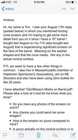

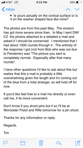

This was an email from fellow DWF member "Tim". I GUARANTEE I'm not the only person with a defective barrel out there. Hell my vintage DW barrels from the 80s don't look like this.

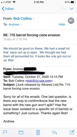

Andrew1220
Forum Posts: 721
August 8, 2016
October 27, 2020 - 9:50 am

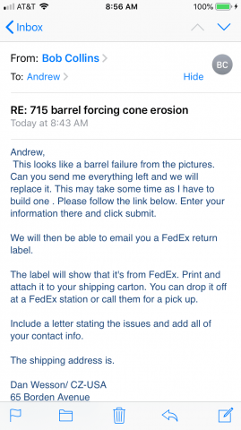

It’s looking like DW might be doing the right thing. I just responded asking if “replace it” means the frame as well. We shall see.
Anyway, there it is right from DW - it's a barrel failure.
9D6203C8-8660-41A0-9980-8B9E9F118C16.pngImage Enlarger
Andrew1220
Forum Posts: 721
August 8, 2016
October 27, 2020 - 1:21 pm
Confirmed. Bob is replacing the whole gun. Now I'm wondering if the new gun and new barrel won't split again???
