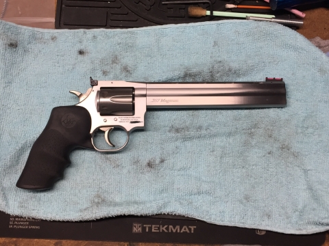

Well I got my new replacement 715!! Picked it up today and got it cleaned up for a trip to the range.
WOW! The high quality machining and the tight cylinder lockup is very noticeable compared to the old one. Trigger is awesome too thanks to Bob reusing the old hammer and trigger that he polished previously.
Went through 100 rounds and I can say it’s just as accurate as the old one. Back to ringing my 8" steel plate at 120 yards.
All in all I am extremely pleased with this so far. Fingers crossed this barrel won’t split!

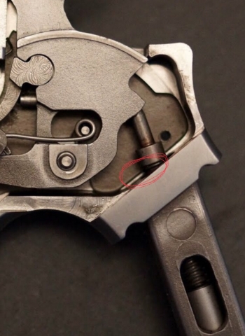

I noticed after installing the Wolff 8# mainspring that there was some weird resistance/hang up with the trigger during the first couple mm of travel.
I finally realized the top coil of the mainspring was actually dragging against the top of the mainspring body of the frame. I used some needle nose pliers and pinched the coil tighter so it wasn’t protruding outward to make contact with the mainspring body. Good to go now!
