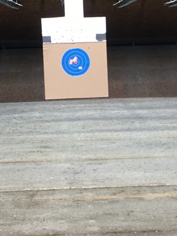

As an illustration to my previous post, about a year ago a friend and I went to the range.  My friend had not had a range trip in a long time and I was as interested in how he was doing.  I was shooting a model 15-2 6VH with 38 special reloads with various bullet types.
C2A319AB-8526-4549-8DD4-0D684F6EB7C2.jpegImage Enlarger
7 yards, grouping not so hot with 1 flyer.  As I look around everyone on the line was firing at 7 yards and I am standing there with a DW that is capable of doing this at 25 yards and further.

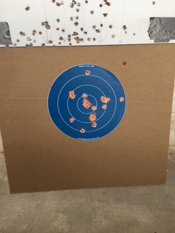

59E1265E-310F-42B1-A6D2-991E54A9BE5A.jpegImage Enlarger
My next 7 shots at 15 yards, with 1 flier.  Obi Wan spoke to me.

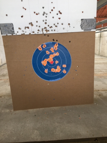

828549C8-9FB2-438F-9B5D-E0A027AFFCB7.jpegImage Enlarger
Once I had proven my point that I had a very accurate DW (thank you to EWK for the barrel assembly) I went back to punching holes at 15 yards.  Same gun same shooter with various results.  Point being that accuracy and group size can be a function of technique and mental focus.  That light saber may work for Luke, but I prefer my DW.
Hope this helps you patriot07.
