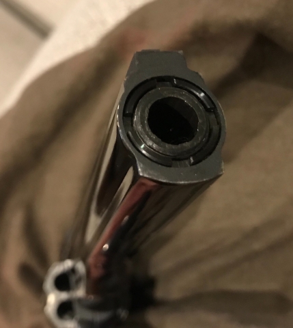

You know what?  I had a horrible accuracy issue with a 41 Magnum I forgot about.  I looked down the muzzle end and saw the problem- I thought the barrel was installed backwards- the end of the muzzle looked like the forcing cone end.  So I unscrewed my barrel and much to my surprise- a forcing cone had been cut on both ends!  Could be a barrel in backwards (huge gap most likely) or maybe yours is the second barrel with a forcing cone cut at both ends....

Hmmm. One more good clear photo to add to the list. Close up of the muzzle.

Thanks for the replies.
No cone at the muzzle end.

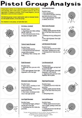

This is sometimes helpful:
Pistol-Grp-Analysis.JPGImage Enlarger

Yeah...but I don't get why any of that would change from load to load?  I mean, I shoot 45 ACP +P from my Colt 1911 the same way as I shoot my light reloads and don't get any change in POI.  Why would I get POI movement in this pistol?
The only guns I've ever had POI issues from were fixed-sight handguns and they were off for everything - no major variation load to load.  That's the curious thing here.  And almost all of the loads shoot poorly.  You'd think a big, 6" 357 would shoot most anything well.

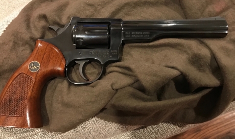

In an effort to understand the accuracy issues you describe would you provide pictures or describe the rear sights on your DW.  Your initial post indicated that you believe that it is a model 14 which would have a fixed rear sight but the issues that you are having seem to be similar to a model 15-2 with a broken rear sight that moves with the recoil of the firearm.  Attached is a picture which shows the the difference in front and rear sights between the model 14 and model 15.  The height of the front sights are different between the two models and fixed rear sights versus adjustable rear sights allows the possibility of mixed front sights and/or barrel assemblies on each model.  If the rear sights are adjustable and you are able to move the notch portion of the sight with your fingers it could be the source of the accuracy issues.

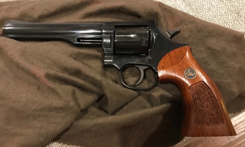

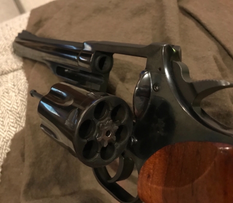

FF1F8B37-F7A4-4EC4-8CB6-6D9F76908545.jpegImage Enlarger
F42D4317-2E95-4B47-BEF5-70788F6BE0BF.jpegImage Enlarger
D6E82D9F-DABB-4587-A134-B0631DEF2D2C.jpegImage Enlarger
3D414688-DF5D-4FFB-B1CD-489980B80A10.jpegImage Enlarger
DAC9D70D-C3E2-4BD1-8CCE-7AEE91C1A922.jpegImage Enlarger

From your photos it's clear that your DW is a Model 14-2. Looks to be in great condition. I see no clues from the photos provided as to why it would shoot so radically off target. That said; the .012 gap is a bit excessive, but I really don't think that would cause inaccuracy issues (S&W currently regards .012 as in spec). Reset the gap to .005 and see what happens. It could just be that the trigger release on this revolver is different than what you are used to. Try it at 3 yards. The reason for 3 yards is that it takes everything except the gun and trigger control out of the picture. Really concentrate on what you're doing. If you can't get a reasonably close group I would send it to DW for evaluation.

Thanks for posting the pictures, it certainly takes the broken rear sight theory out of play.  I agree that there are no visual ques from your pictures that something is clearly wrong that would cause the accuracy problems.  The front sight is pinned and not interchangeable, the muzzle looks to be in typical condition for a revolver of it's age,  fixed rear sight groove confirms that there should be no issue with rear sights.  There are a few things that you might want to keep in mind while trying to figure this out.
