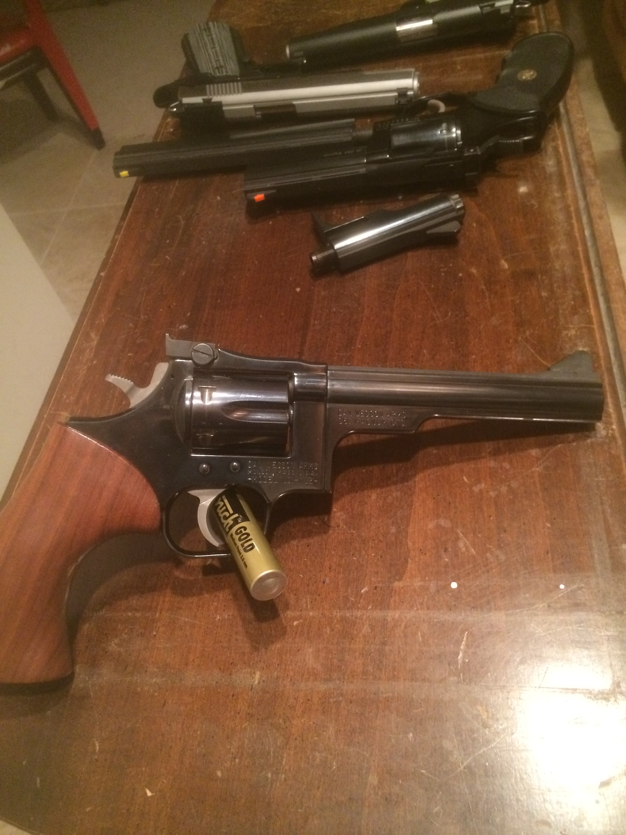

Long time follower, first time poster.  I bought a model 12 with no external nut on the 6 inch barrel.  The other barrel is about 4 inches but does have the external nut.  Is the 6 inch safe to use?  would it be from a model 14?  The shroud is a pork chop model so I am really confused.  Any help would be much appreciated.  I am worried because I know that the sights have different heights.

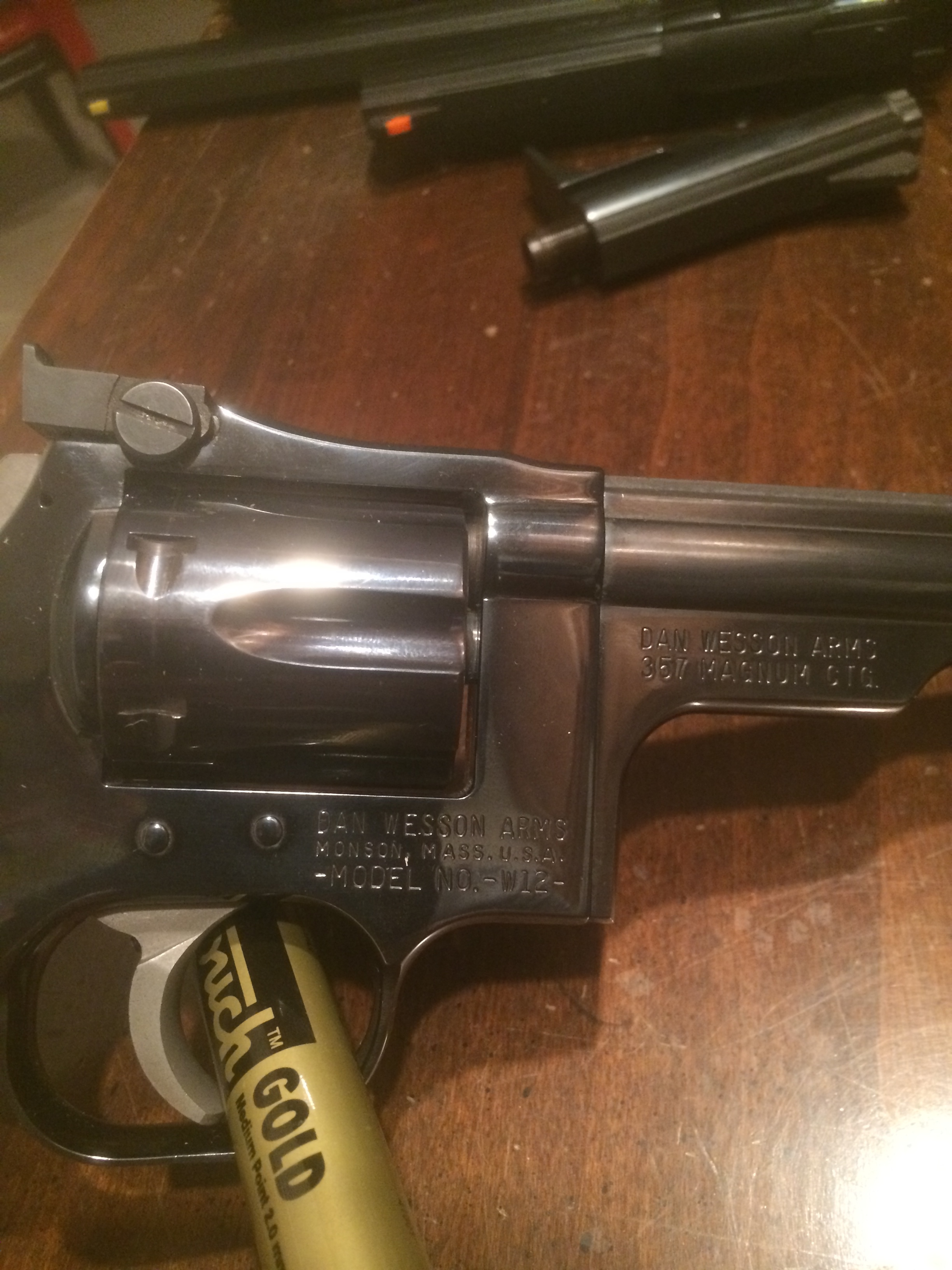

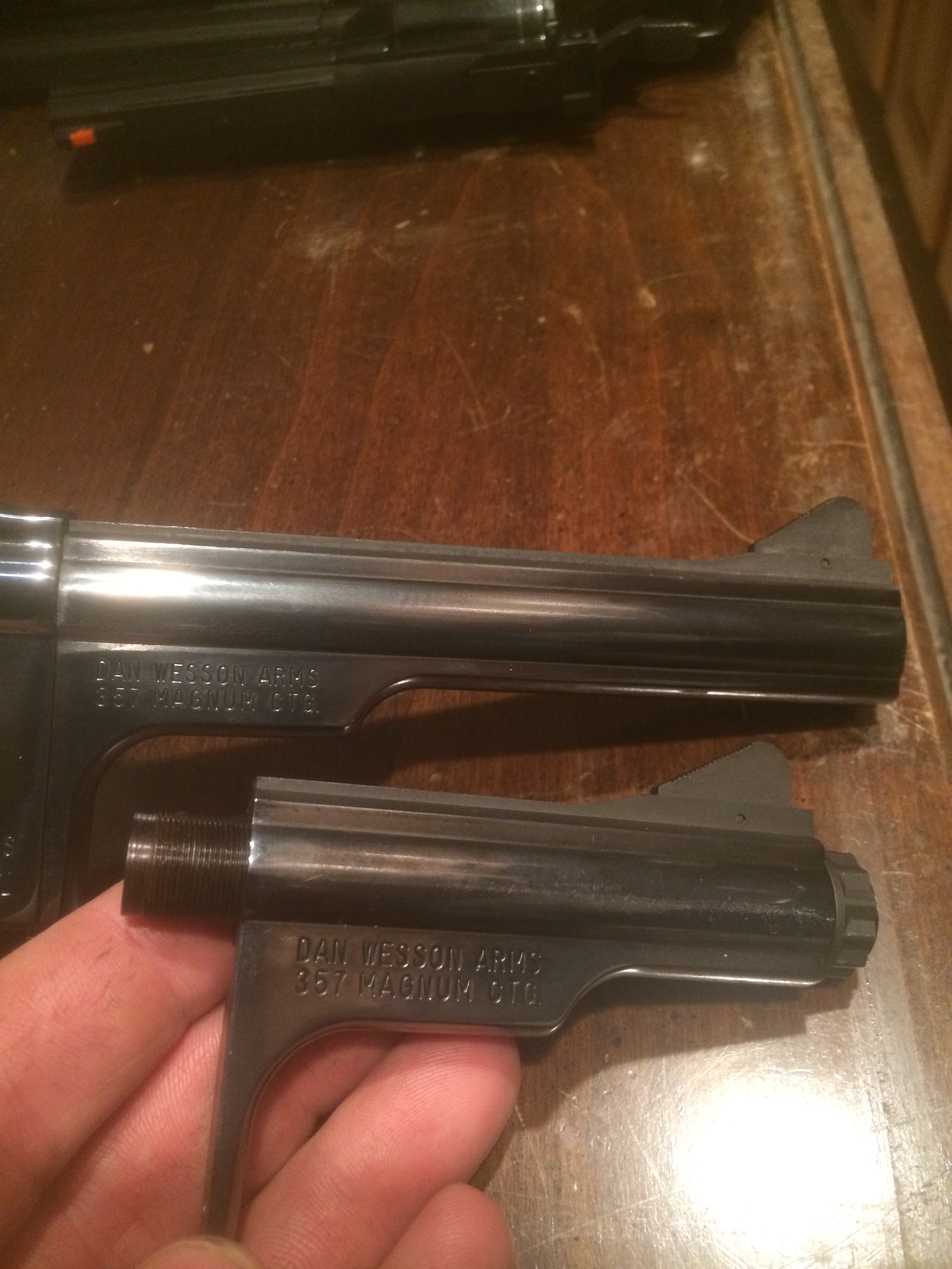

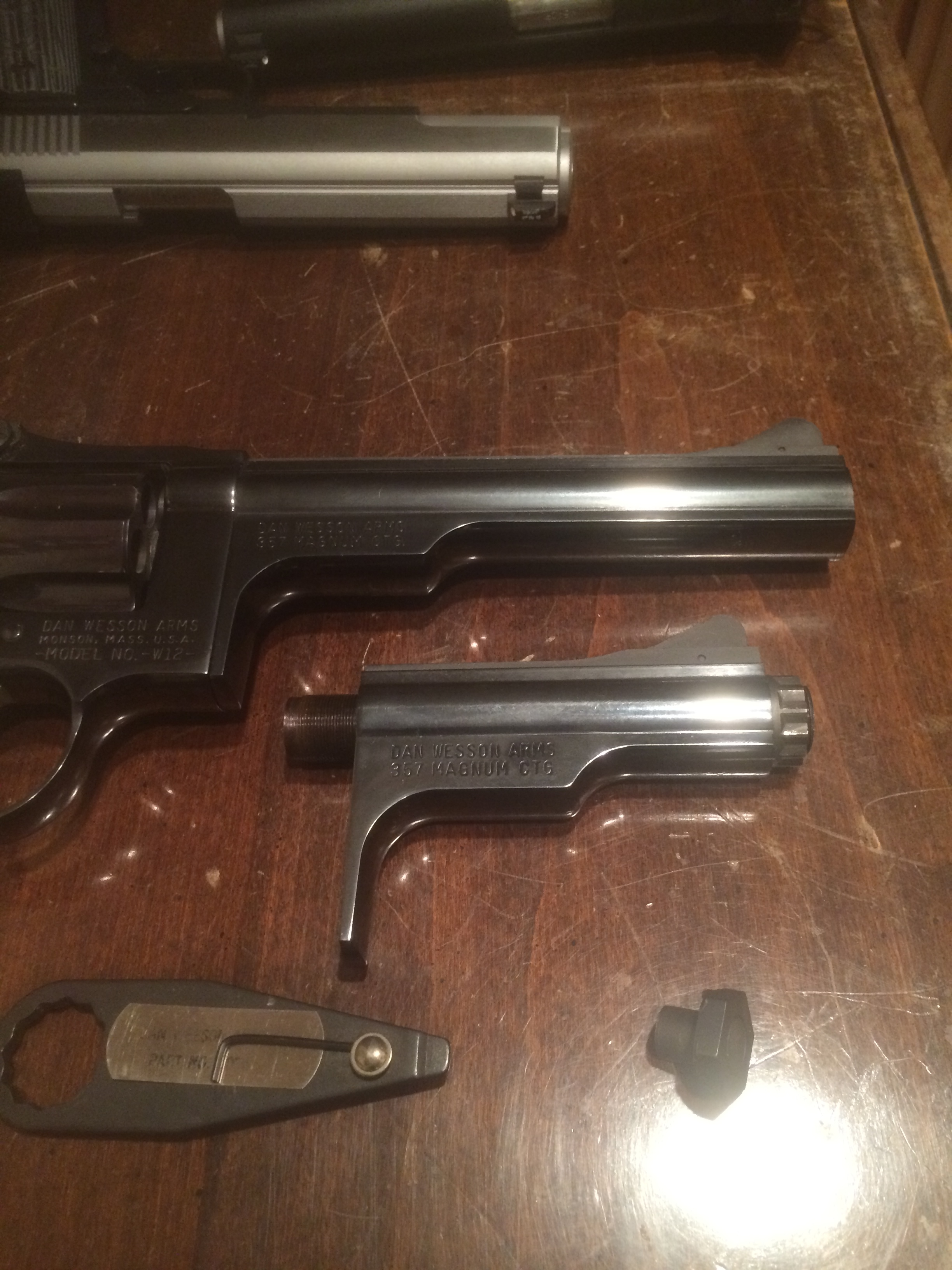

Thanks for your help.  Just added my family pick to the new member section.  Here are a couple shots of the model 12IMG_2301.jpgImage Enlarger
IMG_2302.jpgImage Enlarger
IMG_2303.jpgImage Enlarger
IMG_2304.jpgImage Enlarger
IMG_2305.jpgImage Enlarger
IMG_2306.jpgImage Enlarger
February 12, 2016 - 7:54 pm
Looks like a model 15 shroud was used with the internal nut.  The sight heights should be close to that of the 12.  Take it to the range and see how it shoots.  You will probably need to adjust the elevation some to get POI/POA to match.  Looks like a nice W12!  Bluing is very shiny and dark.
