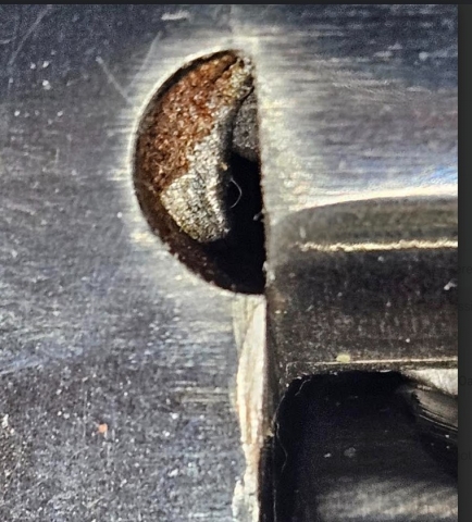

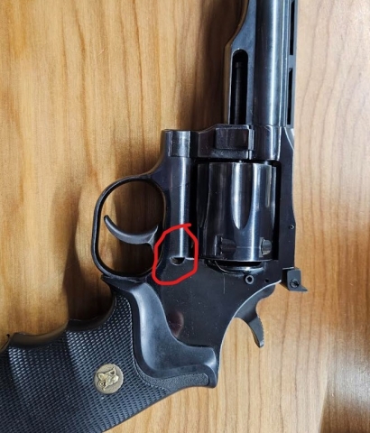

I had a feeling you were talking about the cylinder stop.
It's a pressed-in part - sometimes they fall out and get lost as did this one.  You should be able to tap a new one in with some loctite.  Just be careful that it's not too tight and you split the side cover.  You can get a new one here at EWK, he has them in stock>>>>

The old style was a separate little piece,  they were prone to falling out.  You can get replacements, Loctite it in.  Later guns had onebpiece side plates.

One of my nicknames is Oft Wrong Ron. I may be wrong but I was under the impression that the cylinder stop on 15-2s before 1986 was actually a part of the side plate but designed wrong and weak. The pounding on the ejector rod when cases are stuck would break the cylinder stop off the sideplate. Dan Wesson sold a replacement stop that could be press fit and loctited. Once broken off, the sideplate at that point is weak and can broken when attempting to replace the sideplate. Try not to force the sideplate back into the frame. It is important to hold your upper lip just right while you do it. A broken sideplate is a terrible tragedy. The factory has no blue ones in stock and sideplates are fitted before the frame is polished so a replacement cannot be easily fitted. In fact, it may never look right. It might be best to try to weld or braze the sideplate together.
  I have acquired a couple of dozen used sideplates but each one is different. I have one bare frame I am still seeking a sideplate to fit. If you ever see a bare frame for sale, try to obtain the original sideplate or don't bother with it unless you have a couple dozen to try fitting.

I stand by my earlier statement, some were made with that little hemisphere stop as a press in piece.  All the 7 series small frames had the stop as an integral part of the plate.  I've seen one of those broken off and it didn't leave a nice symmetrical hole like pictured, it was jagged and grainy.
The OP needs that little press in piece and some red Loctite,  not an entire side plate.  These things popped out all the time while shooting, that's why they redesigned the later plates.

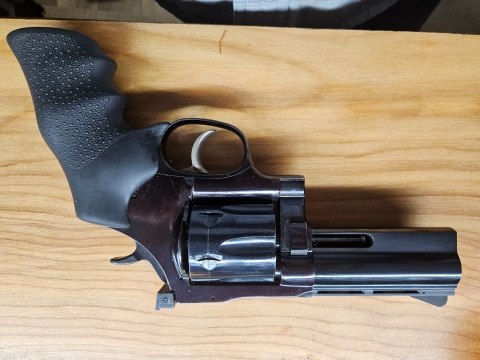

Gentlemen, the long awaited final part arrived today.  Hoping to shoot this tomorrow.  I appreciate all the help from the Forum!!!  Its nice to connect with some other DW fans!!!!15-2-1.jpgImage Enlarger

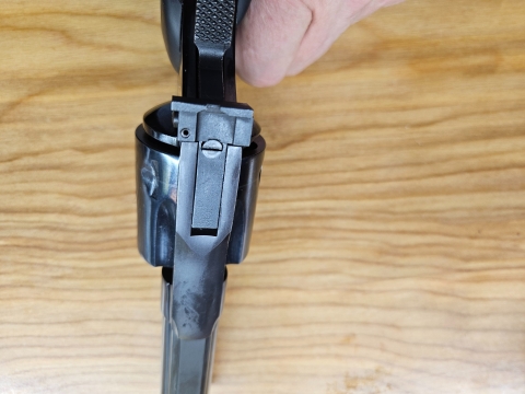

I put the 8 inch barrel back on it, after I got the sight installed.  I dont think I have the right rear sight springs (got 2 springs from my local gun shop that looked close to the right size).
10 yards, using some .44 special I reloaded, with 200 grain bullets I cast, and powder coated.  shot a string single action, and a string double action.  I did have 1 round with a primer strike that did not go off??  when I reshot it....it shot.  any ideas on that?  overall, I am pretty happy with how the sight turned out...and it shoots like a Dan Wesson should shoot!!!!20250208_132659.jpgImage Enlarger
