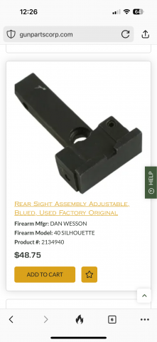

IMG_6180.pngImage Enlarger
Maybe give Numrich a look: https://www.gunpartscorp.com
Model 40 is a supermag, this should fit, correct?
Forum Posts: 4324
January 23, 2025 - 1:34 pm
YES!!! Same as large frame 44. I would grab it, YESTERDAY, if I needed one😏

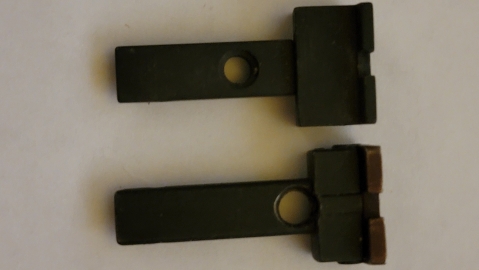

By saying Large Frame Rear Sight, you are referring to the one with the screw further back?    The newer Large Frames use the same as Small Frame if I am not mistaken.
This is correct.....the "older" .44's used a sight with the elevation screw mounted further to rear of the sight.  Here is a thread on it showing the difference between the two.  If it's an older .44, you probably need the sight that Kurt mentioned but make sure you verify it.
https://www.danwessonforum.com/forum/parts-and-service/rear-sights-1/
There is one exception to be aware of (one of the many in the DW world).  I have only seen 2 of these, the 2 that I picked up from a former DW board member.  The large-frame .44 and .41 were fitted with a more robust sight made by Iron Sight Gun Works.  Here is a thread on it back from 2010.
https://www.danwessonforum.com/forum/revolvers/rear-sight-1/

Thanks so much!!  I was on the Numerich site earlier, but could not find that sight.  I just bought it.  It did not say if it came with the mounting screw or spring.  but at least I have the sight coming in now.
