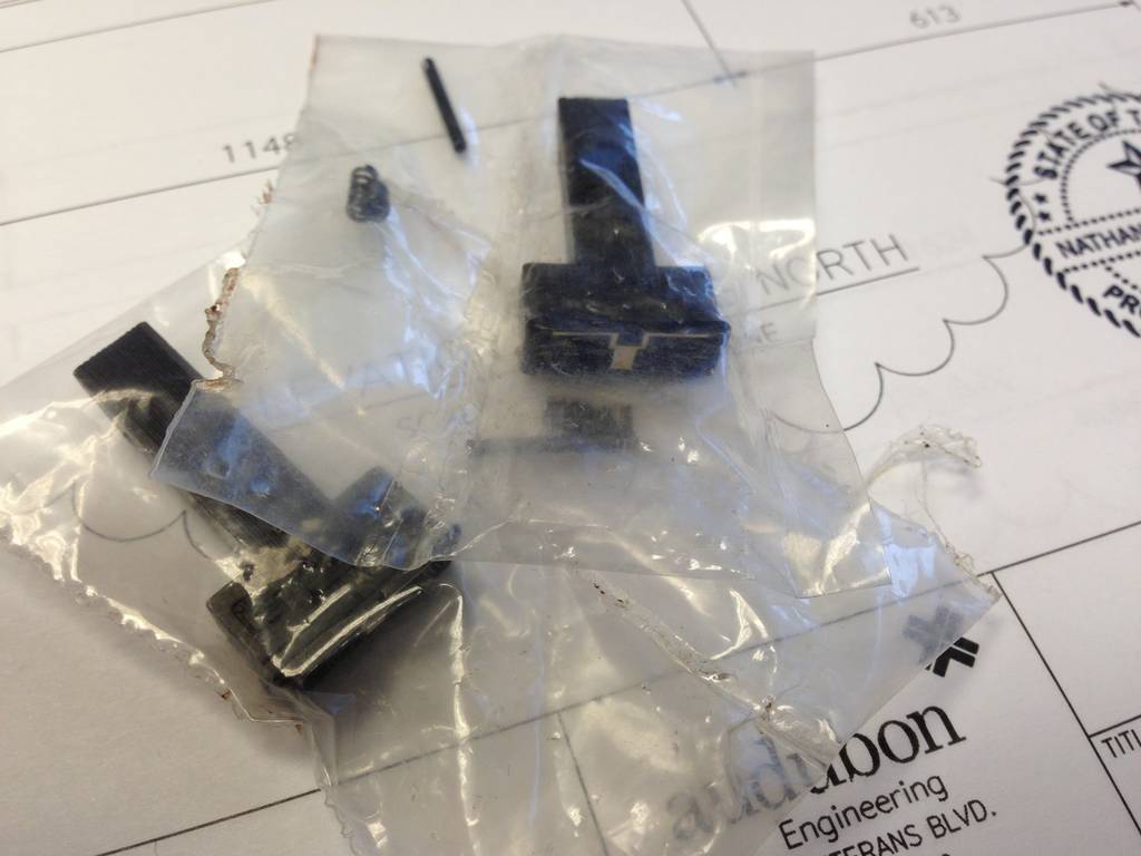

Just recieved these at the office. :)
They sent along a return shipping label for the ruger's they sent me by mistake. It's interesting that almost every one of us was sent the wrong sights.

JTecalo
Forum Posts: 113
September 25, 2012
25
September 20, 2013 - 10:29 pm
IMG_2056_1_.JPGImage Enlarger
Mine came in today and they look just like your picture... now if I can ever get back to OR. to pickup my Dan I will try them.
