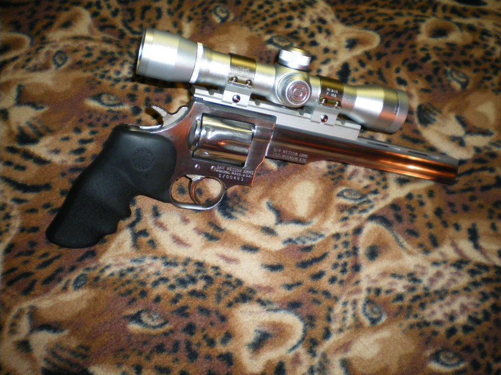

I also have an 8 inch barrel shroud for my DW 714 revolver, that's been drilled and tapped for a scope mount. My 8 inch barrel has no front sight provision at all, and gets used with optics only.
Scoped-8-Inch-714-DW.JPGImage Enlarger
Centerpoint-DW.JPGImage Enlarger
You can still purchase drill and tap scope mount bases, but the barrel shroud must be permanently modified (drilled and tapped) to accept this kinds of mount. I simply couldn't bring myself to drill holes in one of my rare, or hard won barrel shrouds. So instead I bought an 8 inch barrel & shroud that was already drilled and tapped with the mount attached from an online auction.

Does the POI change any after taking the barrel and shroud off and putting it back on?

You may experience a mild POI shift after removing the barrel & shroud, and reinstalling.
I typically do not experience much of a POI shift, but barrel nut torque, or even a loose shroud locator roll pin could affect it more on other revolvers than my own.

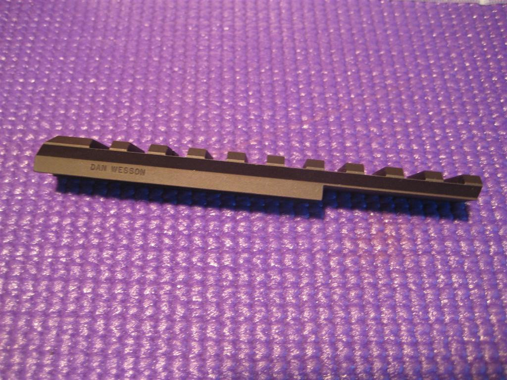

You may also want to consider contacting CZ-USA/Dan Wesson to purchase, or even install a drill and tap scope mount base. That is unless you have a smith of your own, or you plan on doing the drill and tap installation work yourself.
CZ-USA (currently) shows a DW revolver scope mount in stock, on the Shop CZ-USA.com page.
https://shop.cz-usa.com/ProductDetail/20080_Dw-Revolver-Scope-Mount
CZ-USA Dan Wesson drill and tap scope mount image, from The official DW scope mount thread.
czDW-factory.jpgImage Enlarger
Additional CZ-USA Dan Wesson scope mount image, from Shop CZ-USA.com
20080.pngImage Enlarger
There's likely a few other options as well. Someone with more experience with the various Dan Wesson scope mounts available, should be along here shortly.
- Bullwolf
