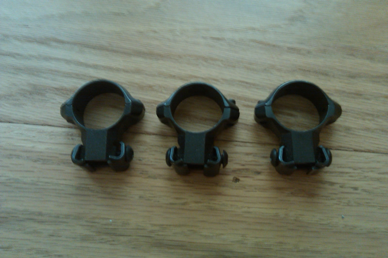

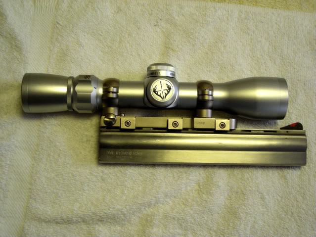

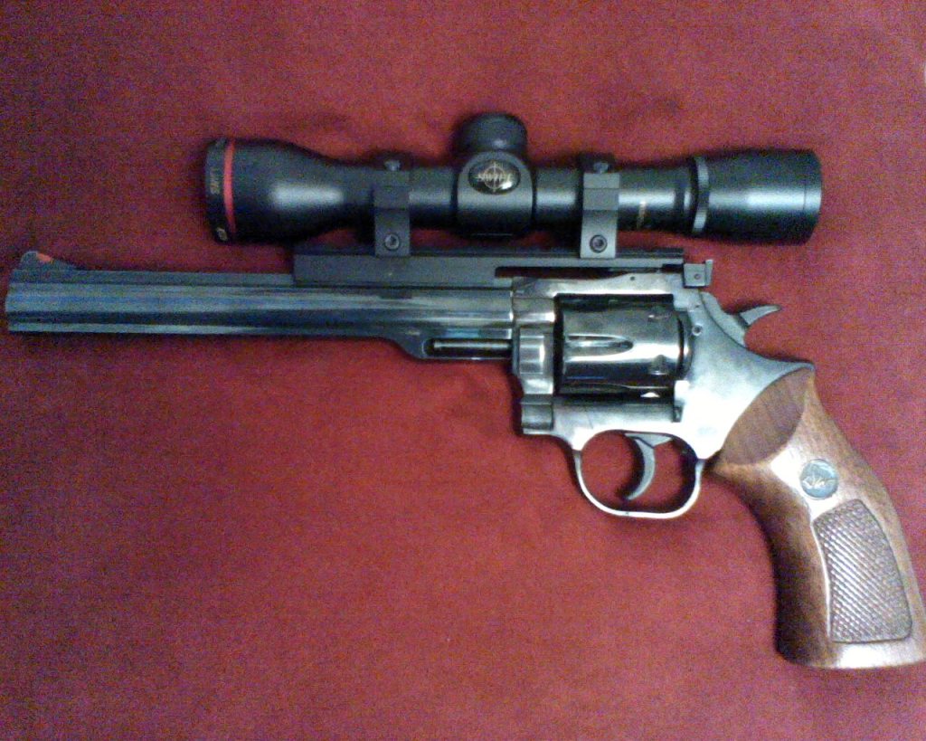

I'll start out with clamp-on mounts for all the vent rib models.  The most popular, and probably the least expensive is the Full-length B-square clamp.  This simply clamps full length on the vent rib with two or three allen screws which go through the mount.  Built like a tank and works well, but really bulky looking.
Here is a pic of it mounted….

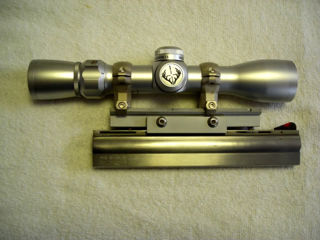

Next is an older B-square–this is a "2 piece" mount–not quite as solid as the single rail, but still serves the purpose.
Here's a really nice pic of one mounted.

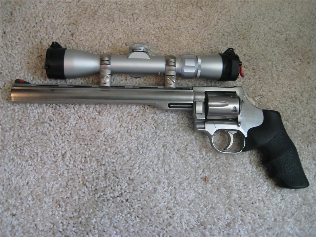

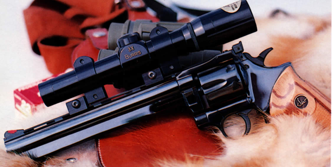

If you can find one, and if you have a little more money…. The Burris rib clamp is a very nice mount with a beautiful finish.  Available in silver and blue.  This mount is also rock solid and a little better looking than the B-square.

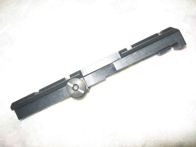

If you REALLY look hard, you may be able to find one of the original Buehler frame clamps.  Unlike the other mounts, this one replaces the rear sight and clamps over the topstrap.  Rock solid and allows barrel changes without removing the scope.

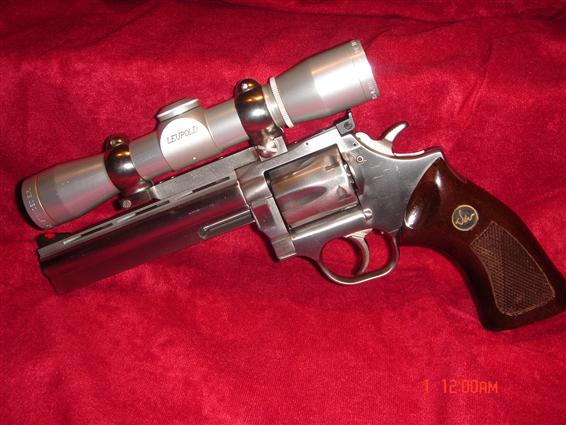

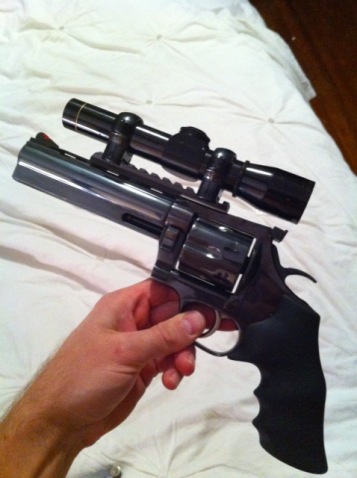

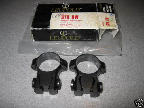

For all of us guys with more money than brains at times… there is the Leupold rib clamps.  One piece base/rings that clamp right on the rib.  Beautiful rings, well made, and expensive–good luck finding a set…
They look even better mounted….

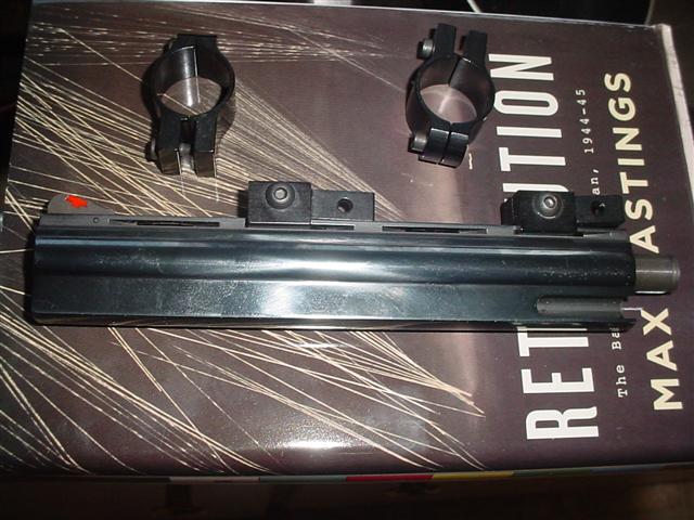

And then there are mounts I can't identify… These are rib clamps similiar to the Leupolds.  Millett also made mounts similiar.

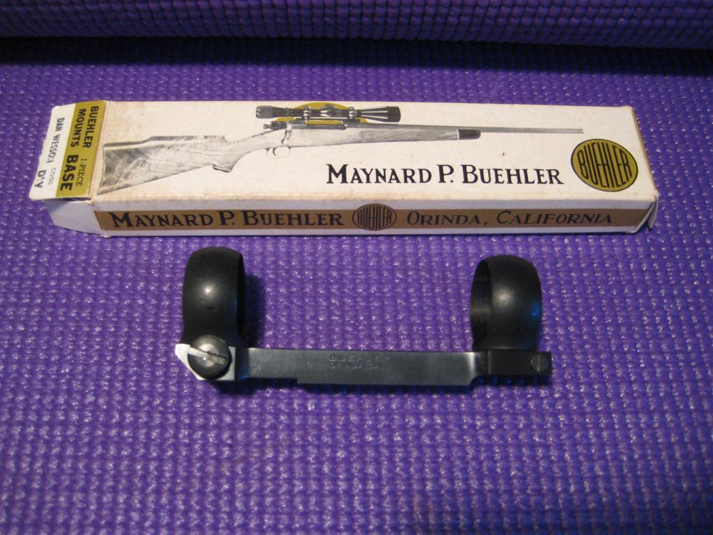

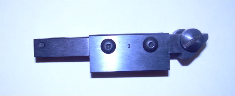

OK, time to move on to the Drill/Tap mounts.  Once again, som eof these are long out of production…  Here is my oldest mount–an original Buehler.   This is a very slim mount and is going to end up on a DW 22 one of these days.

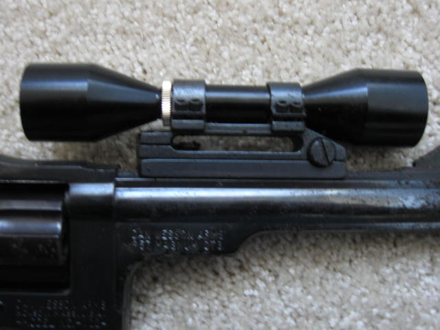

Here's a shot of one mounted–possibly a more modern version…

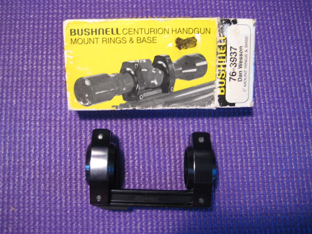

Bushnell made a lot of mounts back in the 1970's and early eighties.  This one also replaces the rear sight and requires drilling/tapping the top strap.  Solid aluminum and very light.

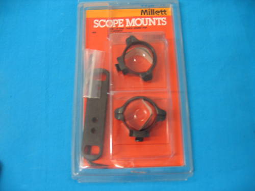

Millett made a standard drill/tap mount–nothing special to say…

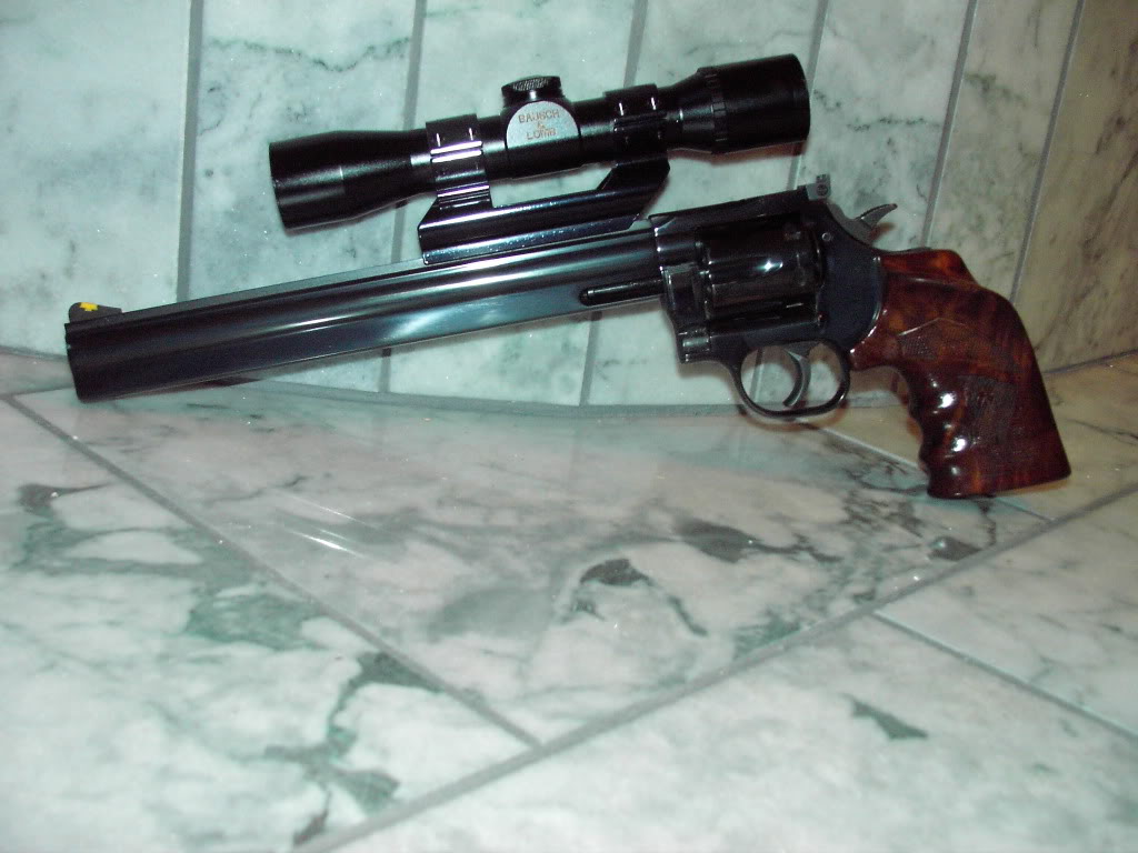

Weigand mounts currently make a nice mount for the DW's–check it out.
Here is a better pic of it mouned.

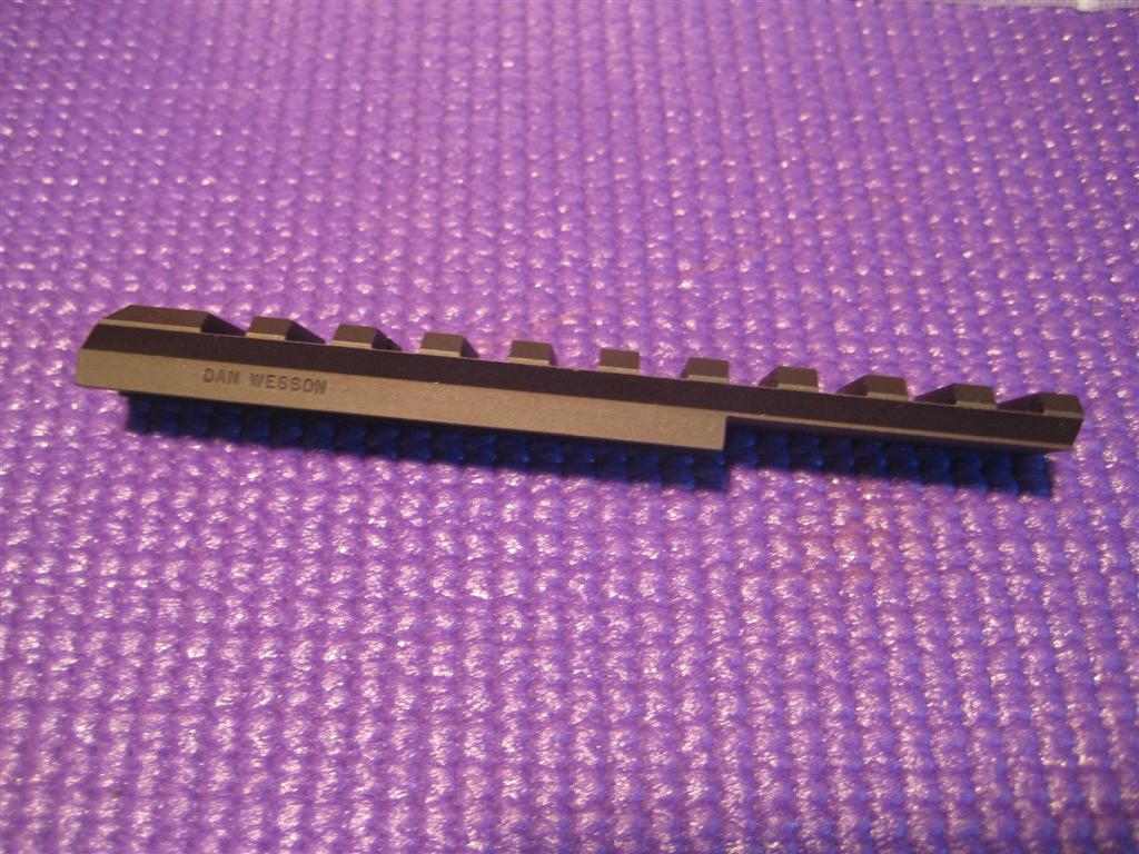

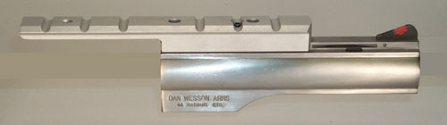

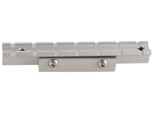

Warne currently makes a weaver rail for the 445's.  It is model Maxima MSS 630, and takes standard Warne rings.

Shoot, great post & thanks for the time you took sharing it with us. Wish you wood have told me about it in your reply to my post.    Problen I'm having is I have the Burris - 410385. It will not work on my 744SS. It looks exactly like the one you have posted.  Did DW make different height ribs for this model?

Pete, the one pictured is actually mine. I never got it to work on a 744. The dimensions of the top rib were just too different from the 715 shroud it is mounted on currently.

July 23, 2013 - 8:59 pm
I knew there was a reason I came to this site.
Just purchased a 357 that had a scope and I needed to find the mounts used.
Turns out the scope and mounts are both Leupold and here the mounts turn out to be the Leupold rib clamps. The scope Leupold M8 2X EER.
A tip of the hat for the Shootist35.
Endeavor to persevere,
Press on regardless.
July 23, 2013 - 11:37 pm
The Leupold Rib clamps are pretty much the Holy Grail of DW Mounts/Rings.
You done Good!
