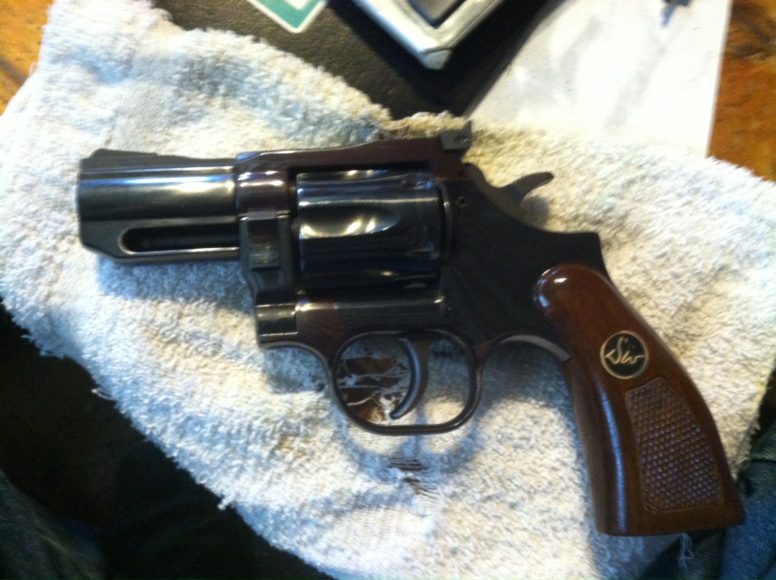

I recently acquired a DW Revolver #351791, .357, 2 1/2" barrel.  Took it to the range twice and it shoots 3' high at 25 yards.  It has an adjustable rear sight and I've adjusted it all the way to lower the bullet path.  The local gunsmith said it looks like it has the wrong front sight.  I've looked at various photos of pistols and barrels and the sight on this pistol is different.  First, it is much shorter than the sights that I see on others, it is solid black with no insert, and it is pinned from the side.  I guess there's a good possibility that it is the wrong barrel.

Well Speedhorses, the mavens appear to be busy so I will try to help. Based on your description I think you must have a model 14-2 barrel. The early 15-2 's had no colored insert and were pinned. They were the same height as the later removable sights. They had no allen screw on the muzzle end. The 14-2 is a fixed sight and the shroud has no top rib. If you have a 14-2 with a 15-2 shroud you can get a replacement sight from EWK but if you have a 15-2 with a 14-2  shroud you cannot change the front sight. Aside from buying a new shroud you my find a brand of ammo that works. Try an assortment; 38spec., 38spec +p, , and different weights from 110 to 180 if you can find it. If you load your own you may find one that works. By the way, 3" at 25 yards is pretty darn good in my world.  Ole Dog
Yep, this is true. wink Nice work Ole Dog, sounds like the classic "15-2 frame wearing a 14-2 BA".smile
While I don't necessarily consider myself a "maven", I will weigh in here.laugh
Yes, the early 15-2's were not colored & were pinned (for approximately the first year)...this changed soon afterward, and yes, they were the same height as the later colored (removable) sights. The 14-2's were not colored and were pinned...no matter which year...clear to the end.
It sounds as though Speedhorses has a 15-2 frame with a 14-2 BA (shroud). That would explain the lower front sight. Speed, if you look at the 6" 14-2 shroud pictured here;
https://www.danwessonforum.com/archive/shroud-types/
You will notice the shroud difference between the 14-2 & 15-2 models.
Hope this helps. Check your PM's for additional photo help.smile

photo-2.JPGImage Enlarger
Ok guys here's a picture of my pistol discussed above.
January 8, 2014 - 9:58 am
Well Ole Dog nailed it. You have a model 15-2 revolver with a 14-2 shroud. So options are, swap for a 15-2 shroud, the simplest but probably the most costly. I believe you can just put a 15-2 sight on your shroud if you have basic mechanical ability. Drive out the drift pin, mark and drill a new sight, then install. You may want to try one of EWK's fiber optic sights if that suites your needs. Good luck

Speed, that is a great photo of your gun. Looks to be in fine shape. As far as me nailing it, even a broken clock is right twice a day. Options; try to trade your barrel for a 15-2 barrel, or  buy one on ebay and sell yours, or  buy a 14-2 with a 4" or 6" barrel and a 15-2 barrel and have two guns. That's what someone with DWAS calls "a start"
